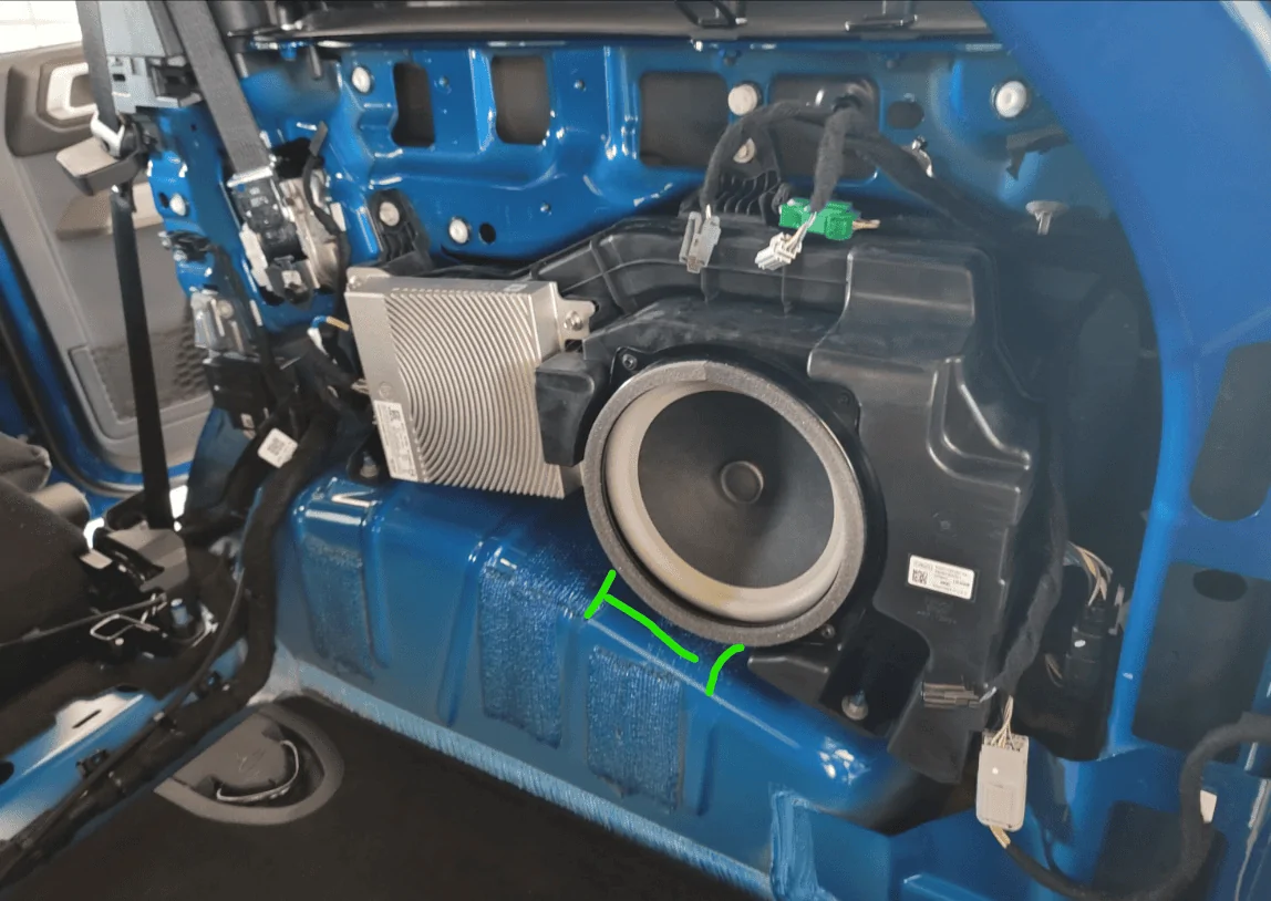

ive seen a few reports on here and other bronco forums of a handful of places that are causing the rattle
1. just under the subwoofer the sheetmetal could be touching the subwoofer
2. the top of the subwoofer and the trim panel
seems fairly hit or miss but if you are having the problem its worth peeling back the trim IMO and taking a quick look. if there is more interest i can try to find the other posts

so this thread has the second item i mentioned. Subwoofer Rattle? I think I gotter licked. | Bronco6G - 2021+ Ford Bronco & Bronco Raptor Forum, News, Blog & Owners Community
i couldnt find the thread on the first part so i just grabbed a screenshot from someone elses post to show the area im talking about.

Seeing how I just ripped my rear trim off and installed my own box.. I'd order some kill at from Amazon pull the stock sub enclosure out and kill mat around it. That should stop the rattle. The popping you may need to do more troubleshooting to figure it out
