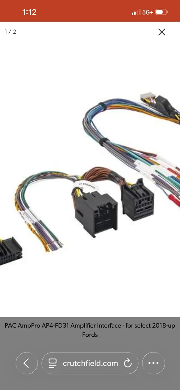

I’m hoping someone can help. I’m installing a Maestro A2B interface to add an amp - B&O system. It’s my understanding that the rear channels operate off the head unit and I need to tap into those wires behind the headunit. The instructions state to cut the wires. Does any know if PAC or someone else sells a t harness for this so I don’t have to cut the wires? I found several full wiring solutions but at $200 that’s a no go. Looking for something similar to attached. It seems to be a harness included with the PAC interface.

o believe THIS is your answer.

I got one from plugnplaykits.com for that exact purpose

Yeah, he has a lot of stuff on there. If you call him, Joe, he is super helpful and can get you what you need. I got a Musway amp that fit under front seat with the harness to get the rear speakers amped up. Did you already upgrade your rear pods with bigger speakers? The 4” in there are terrible.
