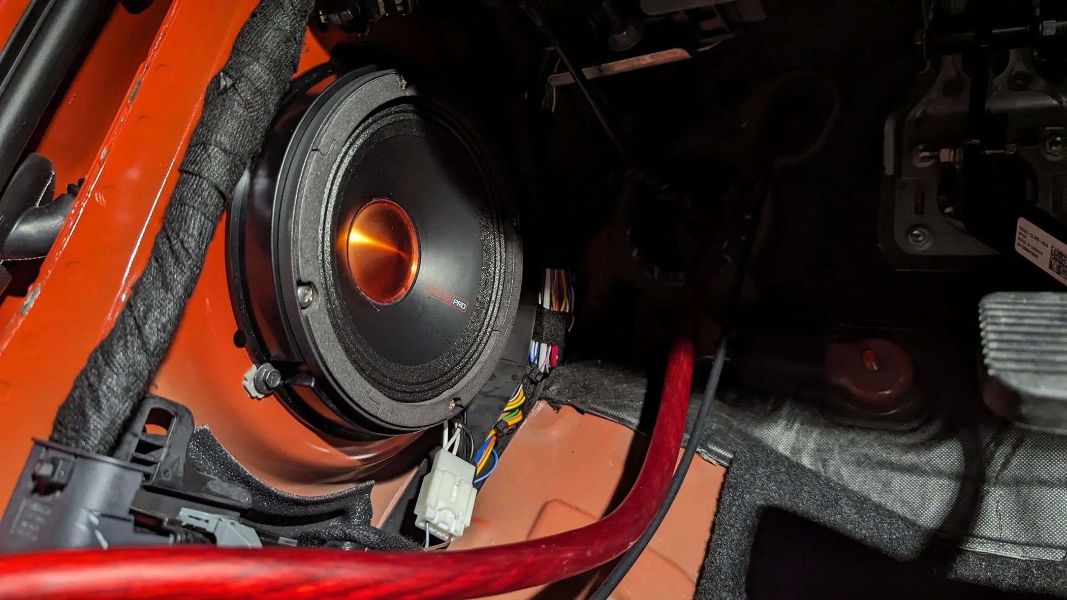

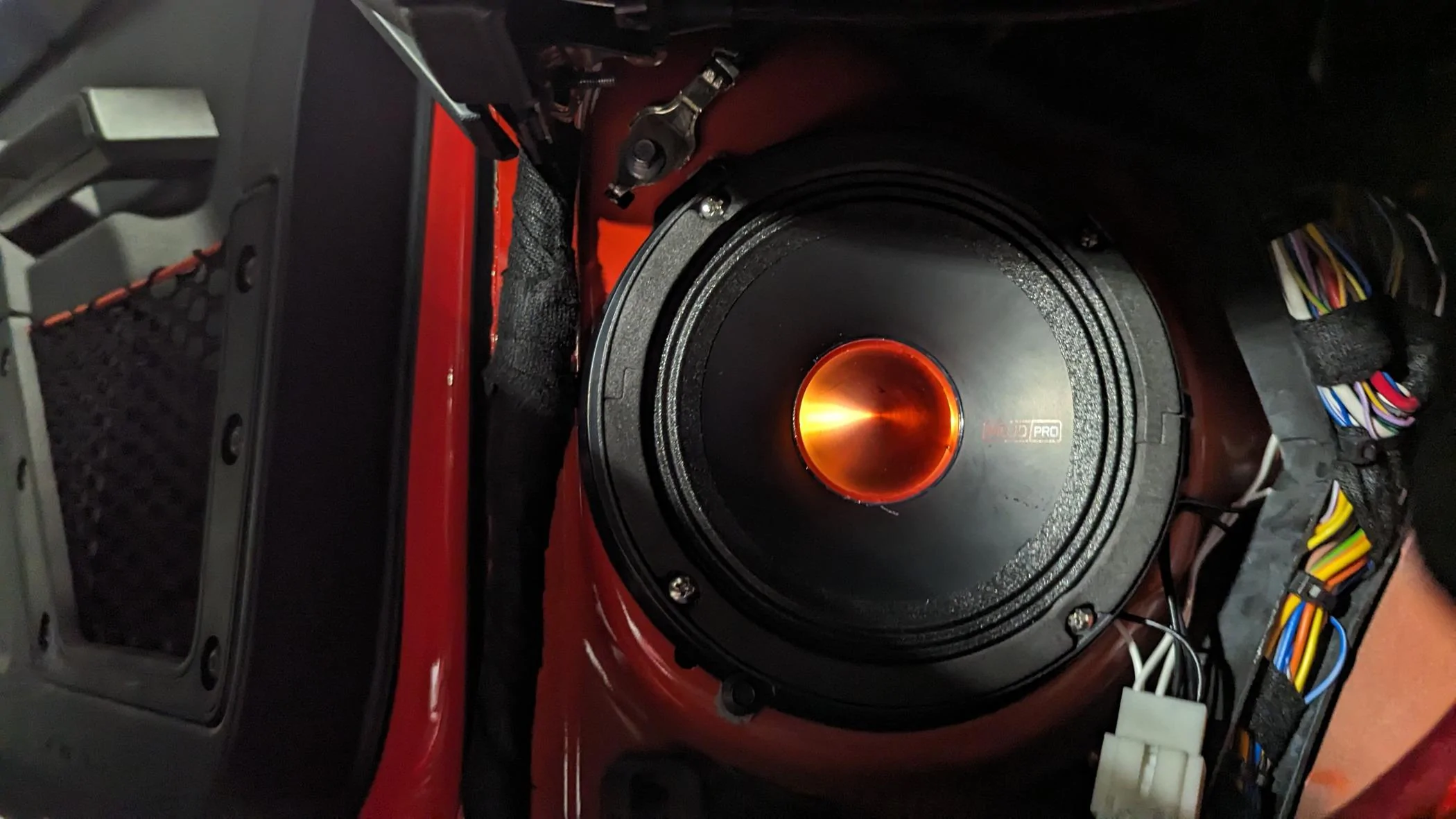

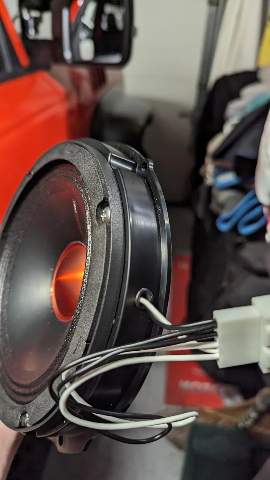

Upgrading kick panel speakers was worth it on my install - had another member here post about his Memphis MJP6 speakers - 100db efficiency rating, so I took that as a good sign that I'd get something out of them using the factory B&O amp. I can honestly say it made a huge difference in the front stage mid fill. I'm very happy with the results. You do have to drill into the mounting adapters to get the wiring to the terminals - thought it was a little weird how Ford did it for the kick panel speakers being the only ones with the terminals on the outside.
