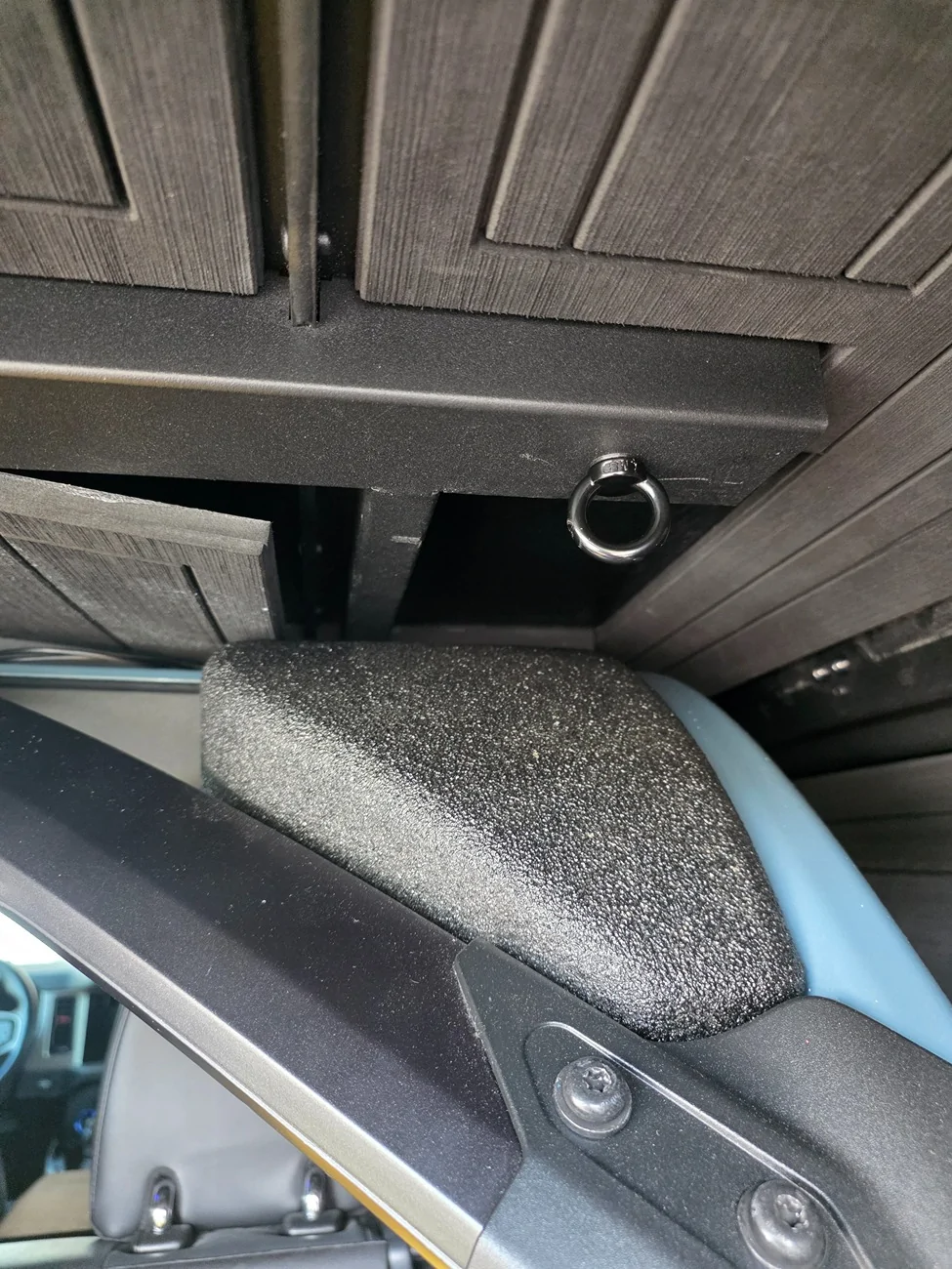

This was disappointing. Another 2 panels. One fully dropped off. And another half off.. mind you, this is in nyc, our warmest day has been like 80f outside and I'm parked indoors Monday to Friday when the sun is up.

Tbh gluing back in headliner panels is minor when you compare the quality of the top to any of the Ford tops. Not sure if the manufacturer of the foam has a thinner product that they can use. Cutting the weight of the panels would help (though heat can still affect any adhesive and gravity will eventually win).

I feel for Armadillo. Adhesion problems are almost always poor adhesive selection or poor surface prep. Both can be difficult to resolve. Most adhesives products seem to have at least one significant down side when compared to another product (longer cure time, shorter pot time, cost, smell, etc) and the surface prep problem can be incredibly difficult to resolve out side a lab and in a production environment.

while the hardtop quality is definitely great compared to any other available options. What they charge for the interior liner is not cheap. Definitely some bad adhesive or prep, for a lot of people. Anyone that has had the hard top for more than a few months with no sagging panels, are very lucky people.
