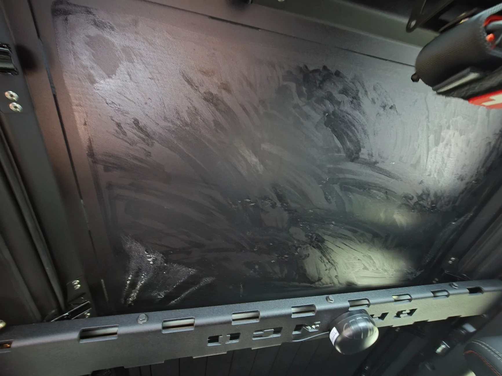

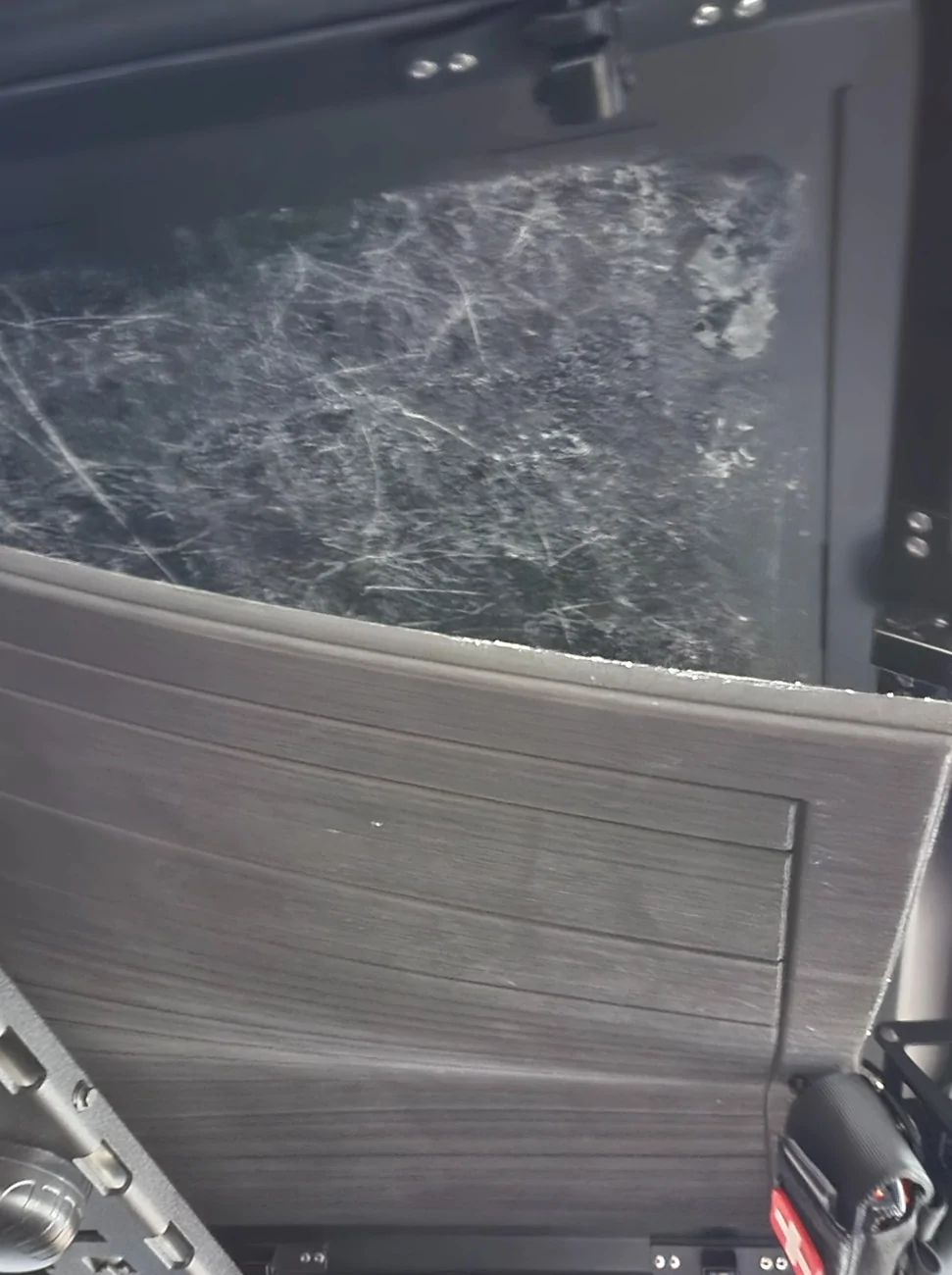

So my 2 big pieces of foam.
Front one had 2 diagonal corners drop
Rear one also had 2 diagonal corners drop. The adhesive itself ... Isn't sticky anymore ...
Whatever they used on my truck. Loses adhesion with age. This is beyond disappointing.

Same issues here.
February 5, 2026: Purchased the top
March 30, 2026: Installed by the Armadillo team
June 29, 2026: Attended a Off Road event. Several other's expressed an interest on our top. Opened up the back and we had several foam pieces that were barely hanging on. Totaly embarrassed by this. :facepalm:
Aside from this liner hiccup, we are absolutely thrilled with the hardtop—the engineering functional use and the look of it are outstanding.
I did reach out to Fabian (Armadillo) and he suggested Manus-Bond 75-AM adhesive as a solution.
This is the response from Armadillo in reference to the issues with the panel pieces:
"I would probably advise trying the Manus-Bond 75-AM on the existing liner and applying pressure until it cures or as directed in the instructions. The reason being is that the failure point of the adhesive is between the liner foam and the adhesive itself, not the adhesive and the hardtop, if that makes sense. If you apply a new liner with the Manus-Bond adhesive, the failure point will still be between the factory adhesive on the liner and the foam itself. I can still send you the replacement pieces if you'd like. Let me know which areas you need, and I can check the lead time for those.”
Fabian's explanation makes complete technical sense: the pre-applied pressure-sensitive adhesive backing coming on the foam material itself from their supplier is what's releasing from the foam core under heat. If they ship brand-new replacement panels from that same supplier lot, those new panels will still have that same failing factory adhesive layer underneath. By using the Manus-Bond 75-AM on your current panels, the Manus-Bond will penetrate/bond directly into the foam and aluminum, bridging that weak layer.

Lol, makes no sense. Because there is no adhesive residue on my hardtop.
All the adhesive is still on the foam panel. Just that it no longer sticks. one of my panels that fell off, had a corner where they forgot to remove the backing paper.

Agreed. It's definitely the adhesive coming loose from the top itself. At least in my situation. The adhesive is still stuck to my insulation panels and no residue on the aluminum itself. Either the adhesive just softens too much in the heat, or the powder coated finish of the top was not properly prepped before panels were installed. Probably a combination of both. Once mine gets worse and i have to pull the whole main panel down Ill be scuffing up the surface of the powder coat for better adhesion. I am not familiar with the Manus-Bond 75-AM that Fabian is now recommending but will look into it.

@Tolzer I pulled panel that was coming off, stripped old adhesive, then reached out to Fabian re: best options before gluing back as orig glue rec people were still having issues. He shared new Manus sealant option saying "this has been working best":
Manus Products Gray Elastomeric Industrial Sealant
https://a.co/d/04NCVvsl
@ThunderFlash Apparently Manus is rated up to 300 degrees fahrenheit! We'll see how this goes🤞
