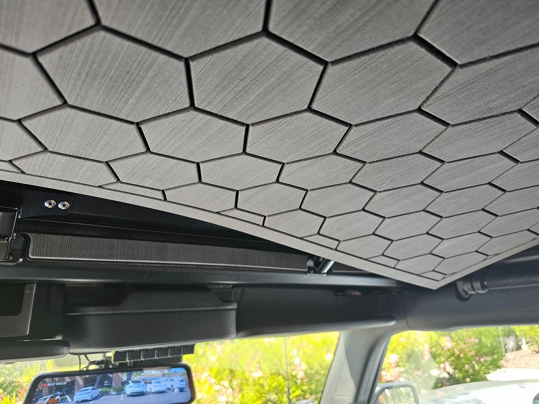

Left the the bronco in the sun all day but was not a hot day, and the previously reglued panels have started coming off. At least this time it didnt happen while I was driving.
This was from the first time when I applied gorilla glue per Fabians instruction. After spending a few frustrating hours striping the old glue off a single panel today to prep it for a DAP reattempt, I think Im done playing with them and its time to follow suit and reach out to Fabian as well.
my overhead panels are still holding with the gorilla glue even from days in the sun when it’s hot. Hope the DAP works out. The panels are pretty thick so I’m curious if switching to a thinner lighter panel would be the solution for this. Heat loosens the adhesive and gravity eventually wins.

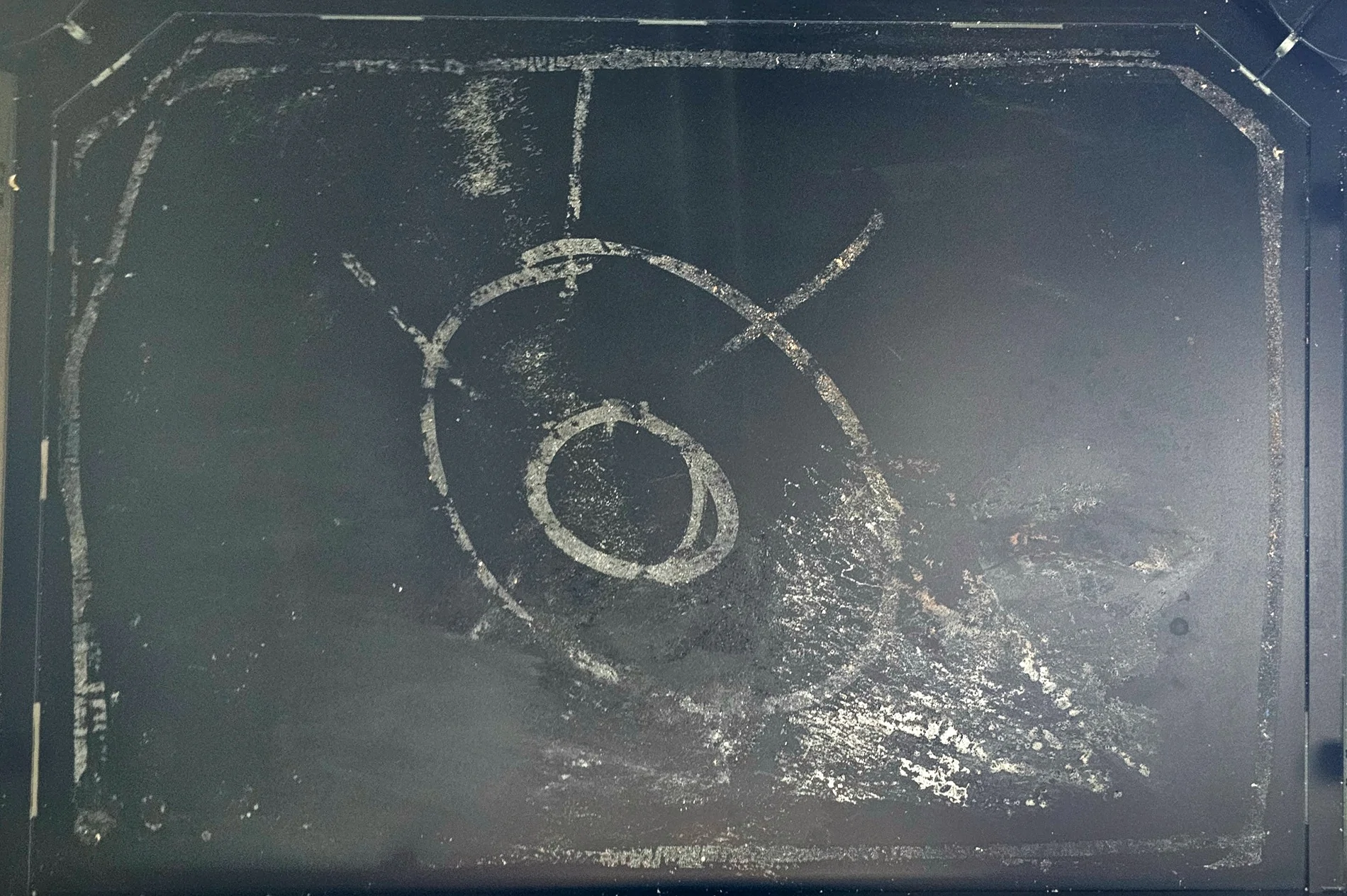

Back when I had my first panels fall off I spoke to Fabian about options and he convinced me not to use options like 3M 77 or a polyclorpoline adhesive stating the Gorilla glue would work over the existing glue. I trust that Fabian believed it would work. I gave it a shot and for several months it was fine. I hope Pseudoko and others who its still working for that they have continued success.
To your question the surface is fairly smooth once you strip old adhesive off. The issue is light glue layer and a substrate paper fiber material on the foam makes true flat adhesion imposable if you apply the G-glue or DAP spray products over it as I did the first time.
On my larger panels prior to putting the liner in Armadillo used some kind of glue stick or roller glue first. It looks like this was the initial failure point. It is also infinitely harder to remove from the top. Curious if anyone else has this or if they have a good method for removing it. I will probably try a stripe removal wheel next and post if it works.
for me… it’s worked so far with the gorilla spray adhesive. I know in time I’ll probably have to reapply. But in terms of removing the glue I’m not sure… you can look up if glue gone is safe to use on a powder coat finish.
Heres hoping it keeps working for you.
For what its worth goo gone softens it a little but not much. 3m adhesive remover works a little better but still not great. Ultimately lots of plastic scraper, an eraser wheel, and elbow grease and it all came off with no damage to the powder coat. The main issue now is getting it off the foam. I can rub it off using a plastic burnisher/scrapper without damaging the foam but a single panel will take hours. I have an old spare panel and will have to test the solvents to see if they help and all and if it will damage the foam or not.
