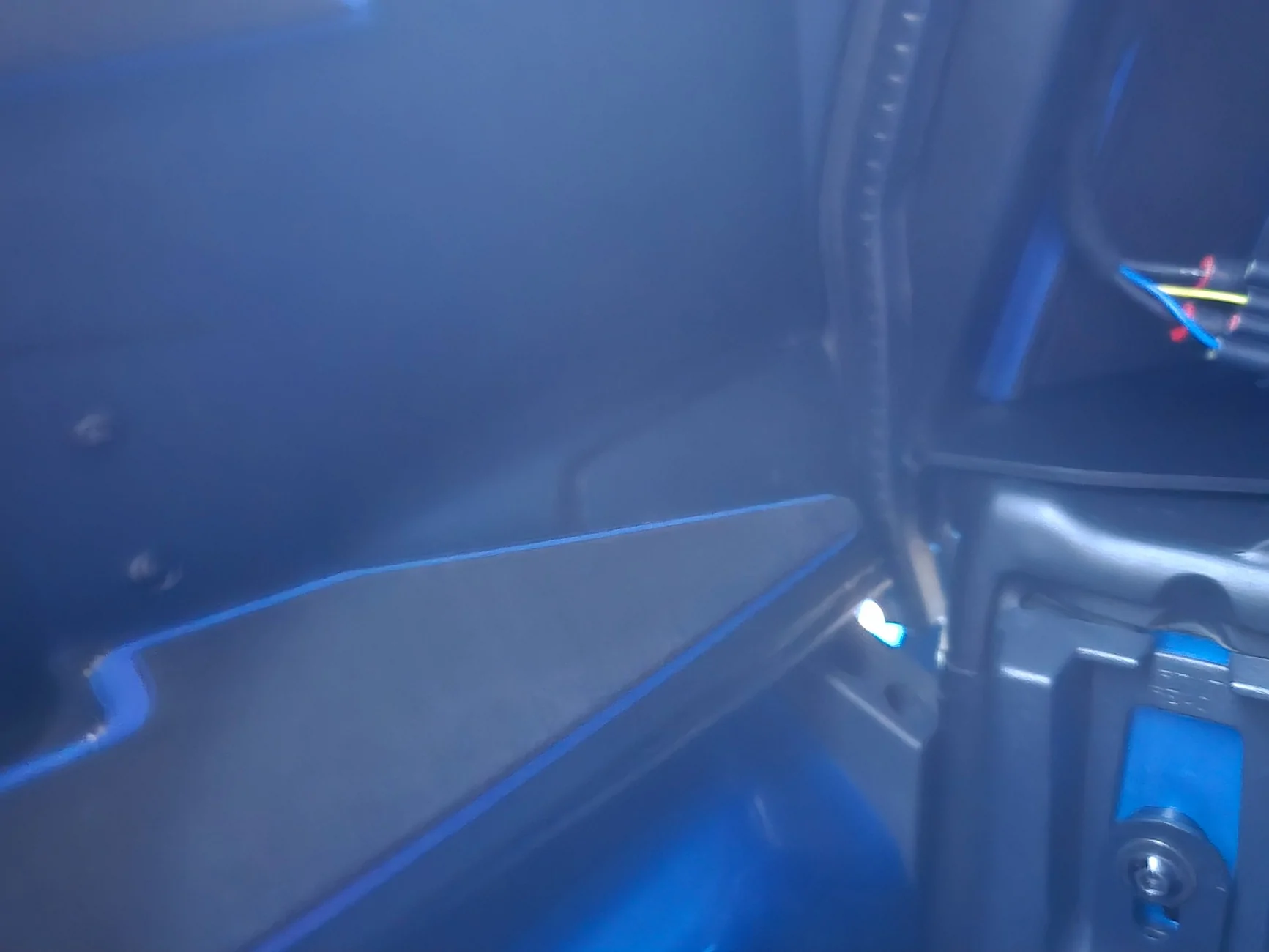

broadicustomworks
Aug 25, 2020
42
4,110
16,700
Hanging Rock, North Carolina
I was installing a shelf in the back of my Bronco tonight, and had my wife close me in the back to check some clearances, and I happened to notice quite a bit of daylight coming through the corners where the tailgate and hatch meet the body. Im assuming everyone else's is like this as well and just the way the top was designed. I dont really see a way to seal it off other than maybe stuff some foam in there when i hit the desert. I forsee quite a bit of dust finding its way in those gaps. I guess that would explain where all the water came from in the back when I washed the Bronco over the weekend with the pressure washer.
Now that I have mine installed I noticed the same (thanks to your post).
Surely everyone with one has the same situation.
Is it a widespread leak-point? At the very least looks like a point to have some air noise (have not driven it and no rain yet).
I have some 2" thick adhesive-backed foam I can install but really don't want to because it would not look like it is supposed to be there and honestly might do more harm than good as it soaked up water.
In that post, I do not have that gap. I also have a Slant Back (one of the first!) Maybe something changed? I have zero leaks and zero wind noise. Also, I do not have that adhesive issue. But as I stated earlier, I had one of the first Slant Backs on the E Coast.

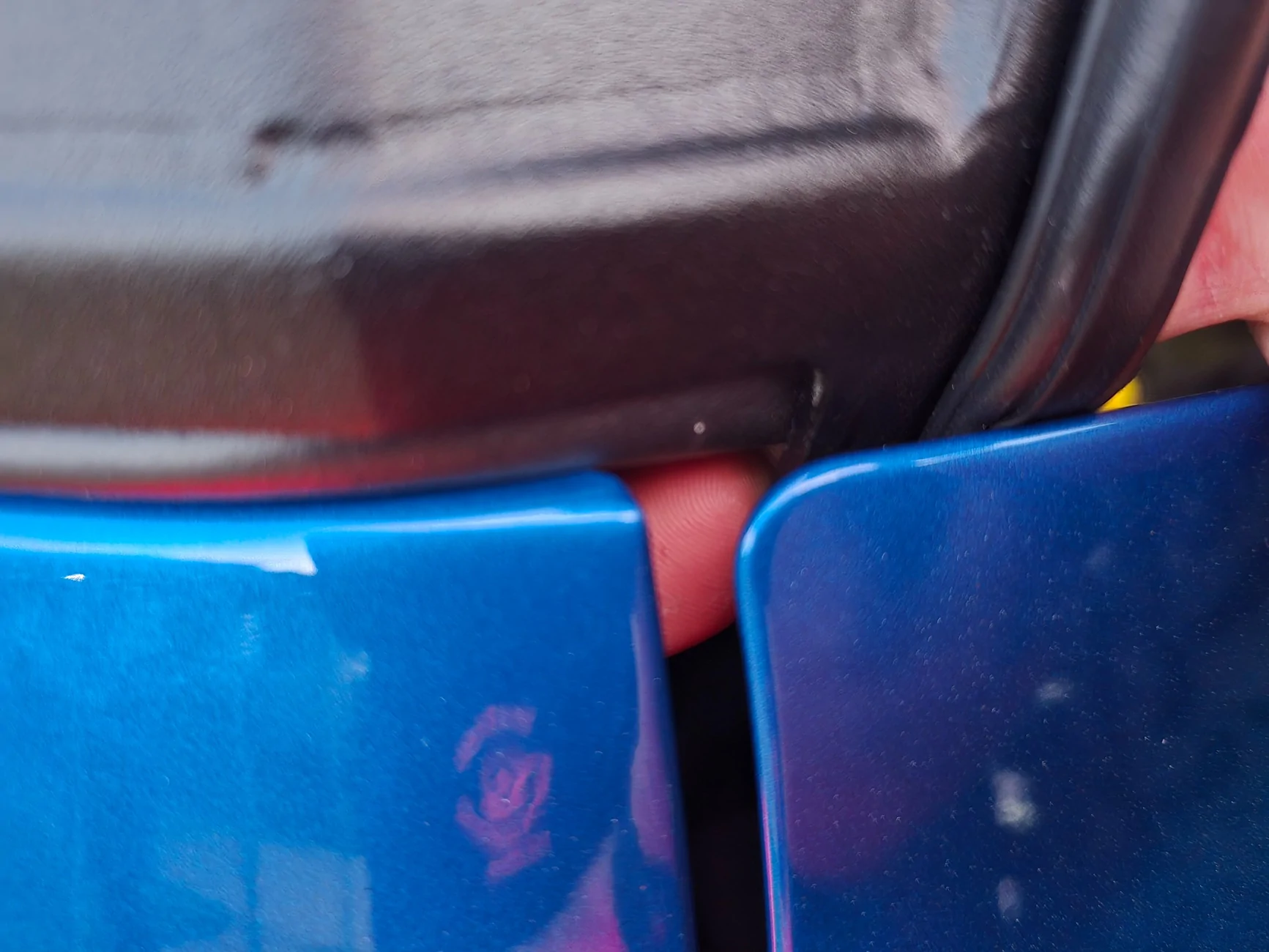

Dtrimpi87
Jul 3, 2025
52
86
2024 Bronco Badlands Sasquatch
Would you be able to grab a couple pictures of your top in those rear corner areas? I'd be curious to see what changed at some point if you don't have those gaps. It'd be much appreciated!
So I took pics, best I could get, and it appears I have a strip of rubber that runs dow past where the top connects, and this covers the gap.
Thanks! Hard to tell but looks pretty similiar. Strange.
No worries. I have had my RIG through countless washes, my pressure cleaner, and plenty of FL mud. No leaks ever. Also, I could not get a good shot, but looking from inside, I do not have that gap I saw in an earlier pick. It almost looks as if they are missing a piece of rubber.
