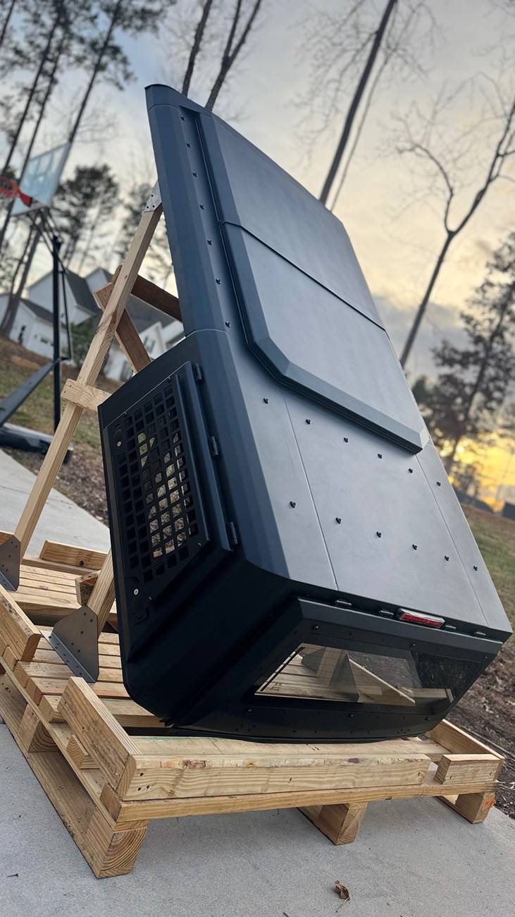

Ford Bronco Armadillo Designs Aluminum Hardtop IMG_3785
Ford Bronco Armadillo Designs Aluminum Hardtop IMG_3771
Ford Bronco Armadillo Designs Aluminum Hardtop IMG_3780
Ford Bronco Armadillo Designs Aluminum Hardtop IMG_3778
I think I’m missing bolts. The install video shows 8 supplied. I only have 4 and the first step is to install 6 to go on the rear. SOS

Thanks for sharing, *@BroncoBill44*. Check your assembly. They might already be installed in the frame holding the whole works in place on the pallet scaffolding. 👀

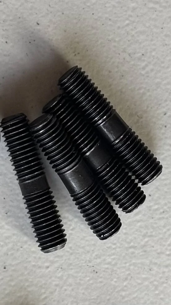

These… it says install 6. I only have 4. The bolts holding the shipment together are not this type.

Well, those are unique, meaning purpose built, double end studs with an apparently generous tolerance on the body length (unthreaded part). Looks like black zinc coating but also some dinged up threads. Hard to tell relative to themselves but could be a 1/2-13 (0.4891-0.5 major) thread if you have something to measure the OD. A fully threaded stud of the same dimensions might also work, or wait for the replacements. The latter being your safest option since this would not be an item you can find at Home Depot. Grainger, maybe. I would not consider the install complete without the other two studs. :(

Looks like metric exhaust studs to me with one shoulder not like the others

Only need four total. Goin in…. Lol
