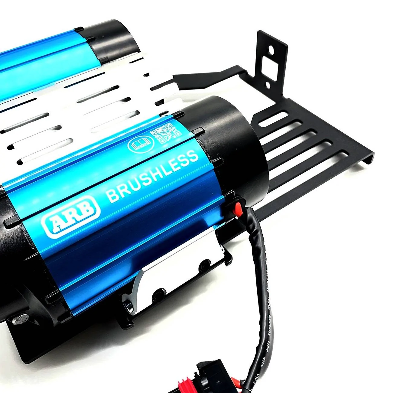

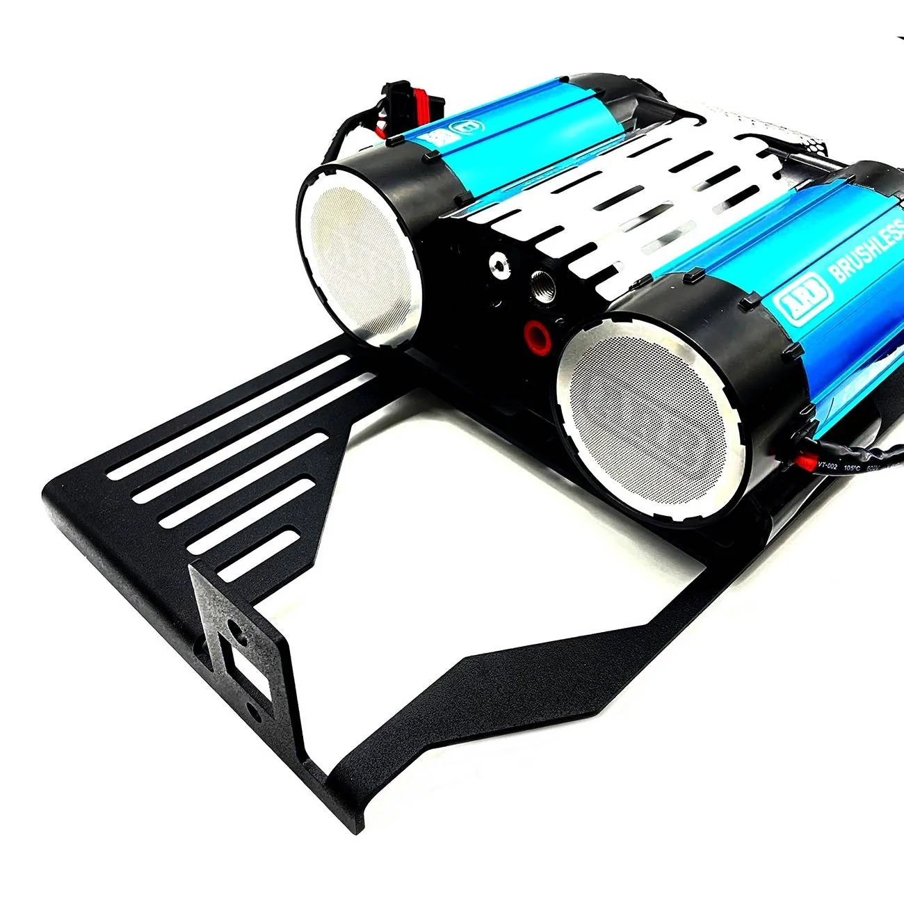

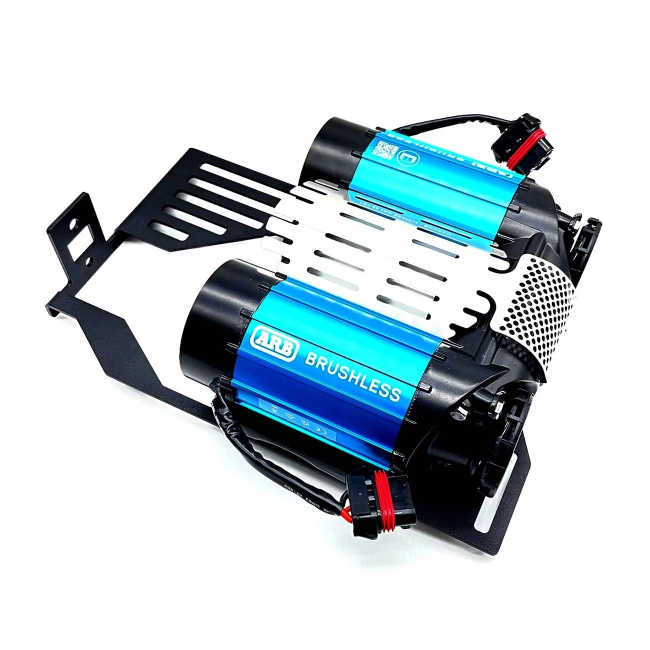

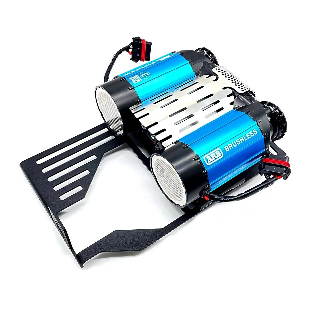

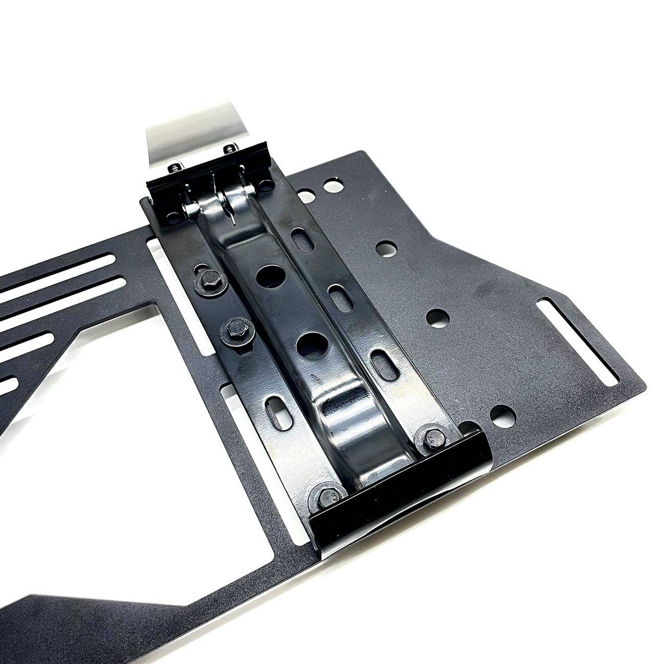

GOOD NEWS! We've confirmed that the new Brushless Air Compressors WILL fit on our KR Off-Road Brackets! You will need to have one of our more recent versions (which feature the extra mounting holes as shown in one of the photos below). BUT if you've purchased your bracket from us within the last 2 years or so it should have those additional holes.
We will make a running change on future brackets to add in additional mounting holes BUT our current brackets WILL WORK!
The wiring IS slightly different however. It utilizes a new dual style power plug. This should be an easy installation if you have upfitter switches as you'll plug the harness in and connect it to an upfitter.
The air coupler DOES get mounted to the side now instead of the top. That is one change ARB made.
You can still utilize our coupler/switch bracket BUT there is no more PLUG AND PLAY switch connection if you use that kit. This is because ARB did away with the extra plug for this. We will provide instructions at a later point in time on how to wire in a regular switch BUT for now, if you have upfitters it's still an easy wiring installation for you.
Here are some photos on our bracket. We'll take installation photos at a later point in time.
