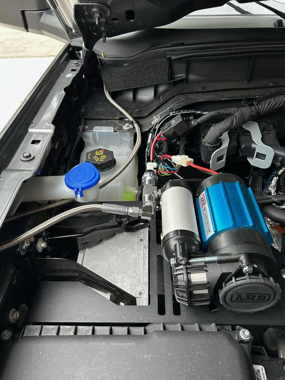

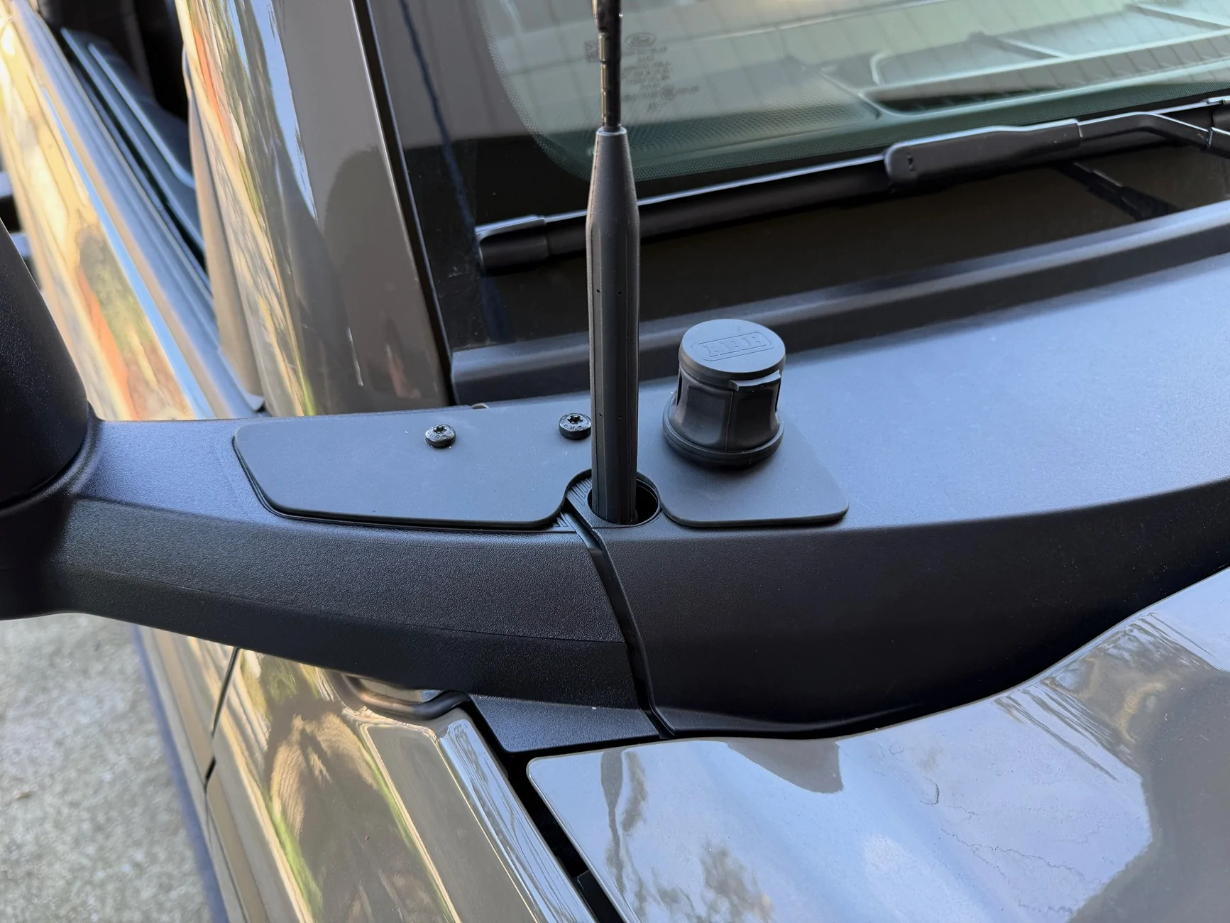

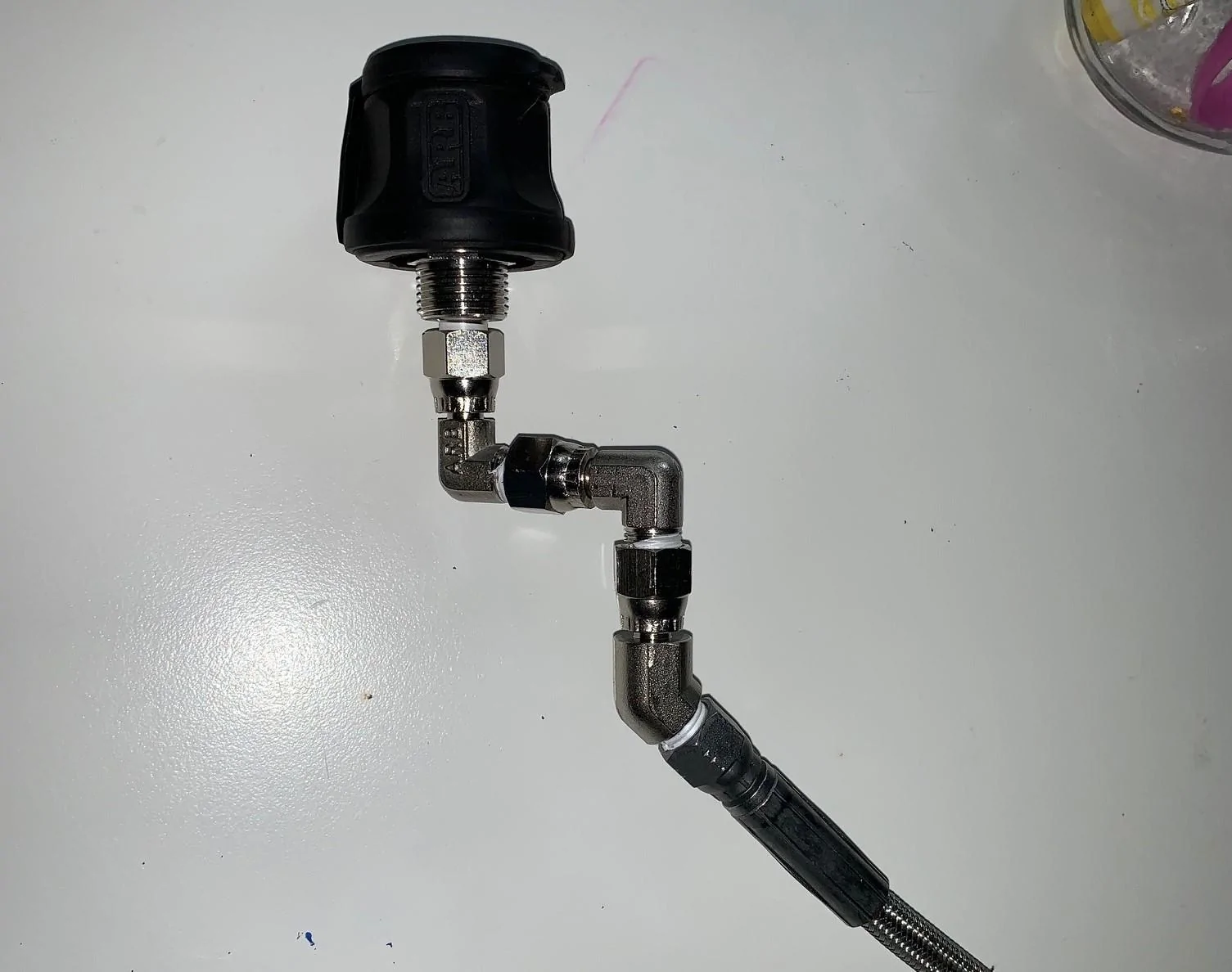

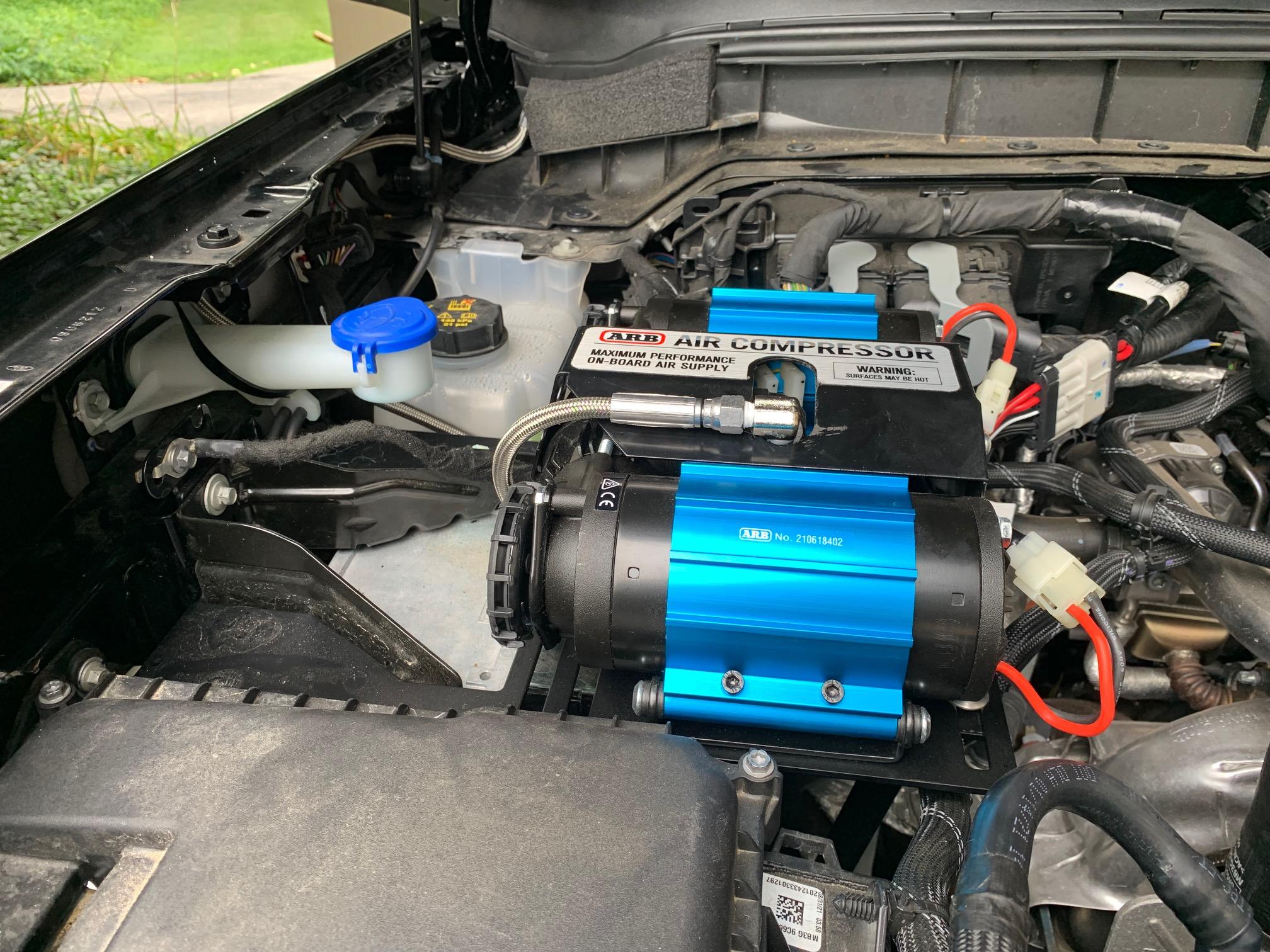

Finally got around to installing my ARB dual compressor and bracket by @4x4TruckLEDs.com. I was inspired by @das solution as seen here, and thought I'd post my results and parts list for anyone interested.
1 x ARB Air Hose Coupler (JIC version - NOT the one that comes with the pump up kit)
1 x ARB 90 JIC(m) to NPT(m) (for insertion into the compressor)
2 x ARB 90 Elbow JIC(m) to JIC(f)
1 x ARB 45 Elbow JIC(m) to JIC(f)
1 x ARB Reinforced Hose JIC, 1meter
Is there a reason you used to many fittings and didn't just go right into the back of the coupler with the hose???

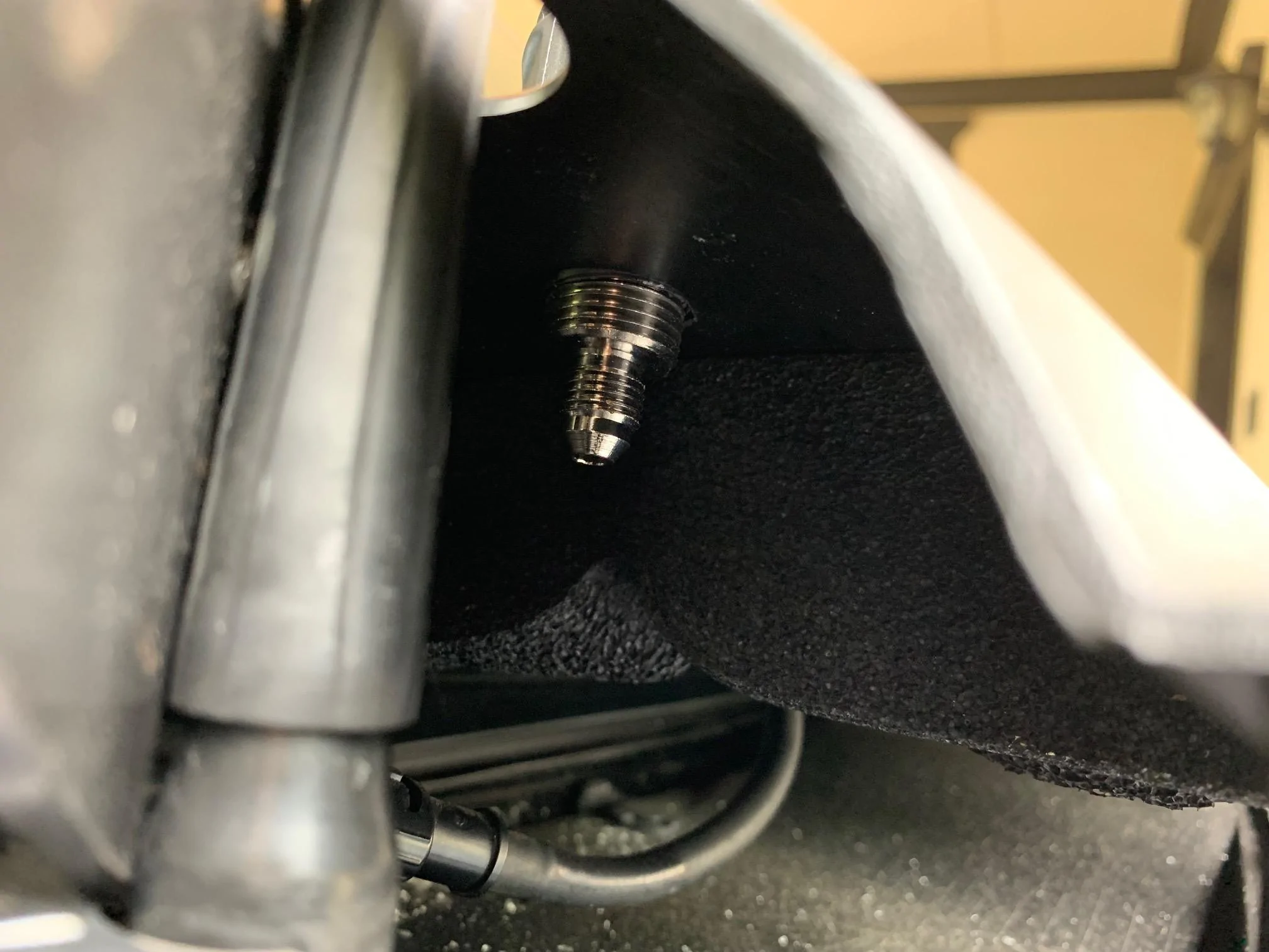

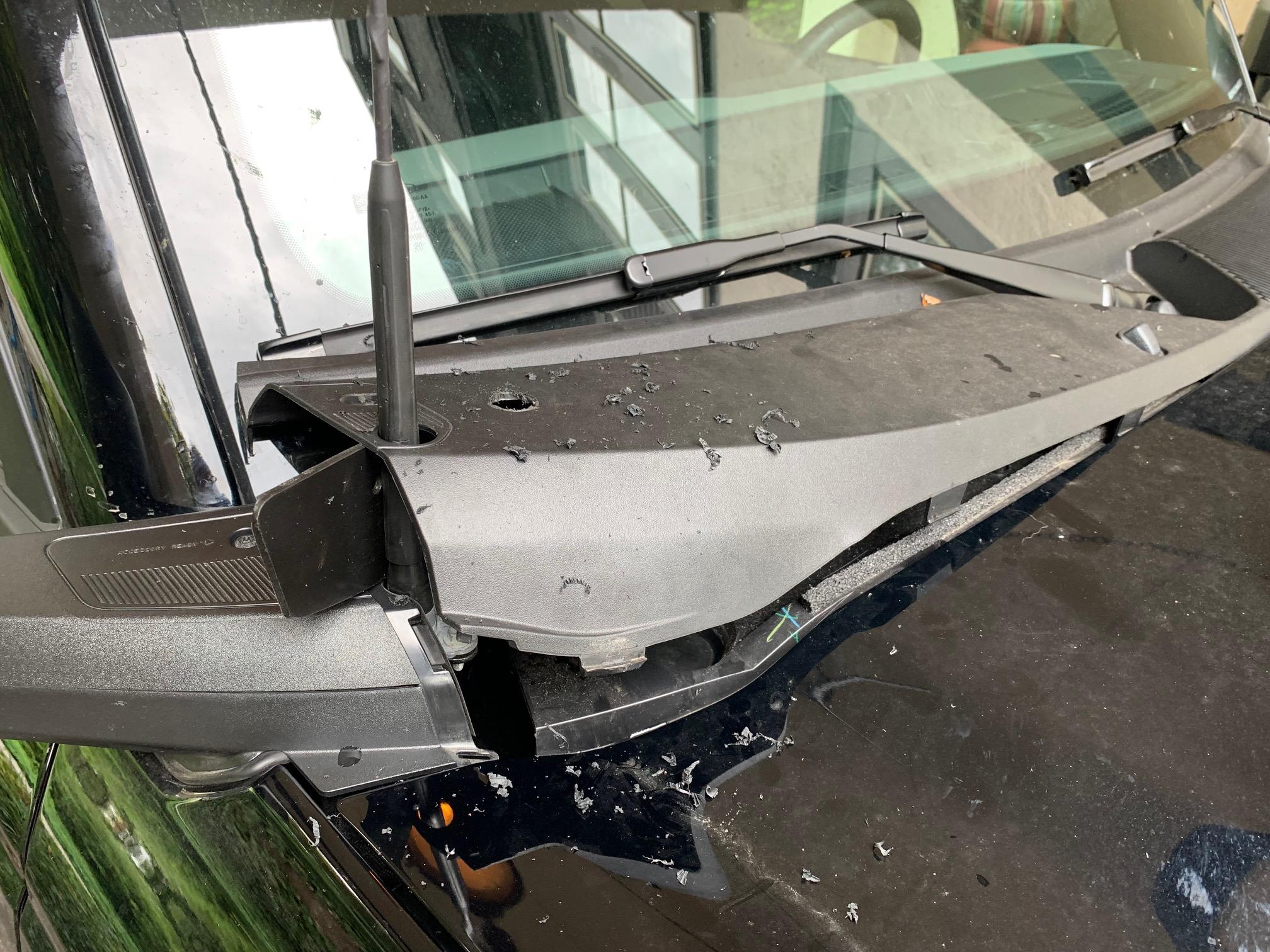

Yes, the location I choose in the windshield cowl is above whatever that black piece\tray is below it (can be seen in the pic of the hole drilled). The first couple inches of the hose have no bend, so it was not possible to fit the hose directly into the back of the coupler. I started out trying just a 45, but that didn't give the right clearance. I made a few attempts, and was trying to minimize fittings, but the best fit without any rubbing or pressure was the two 90's and a 45.

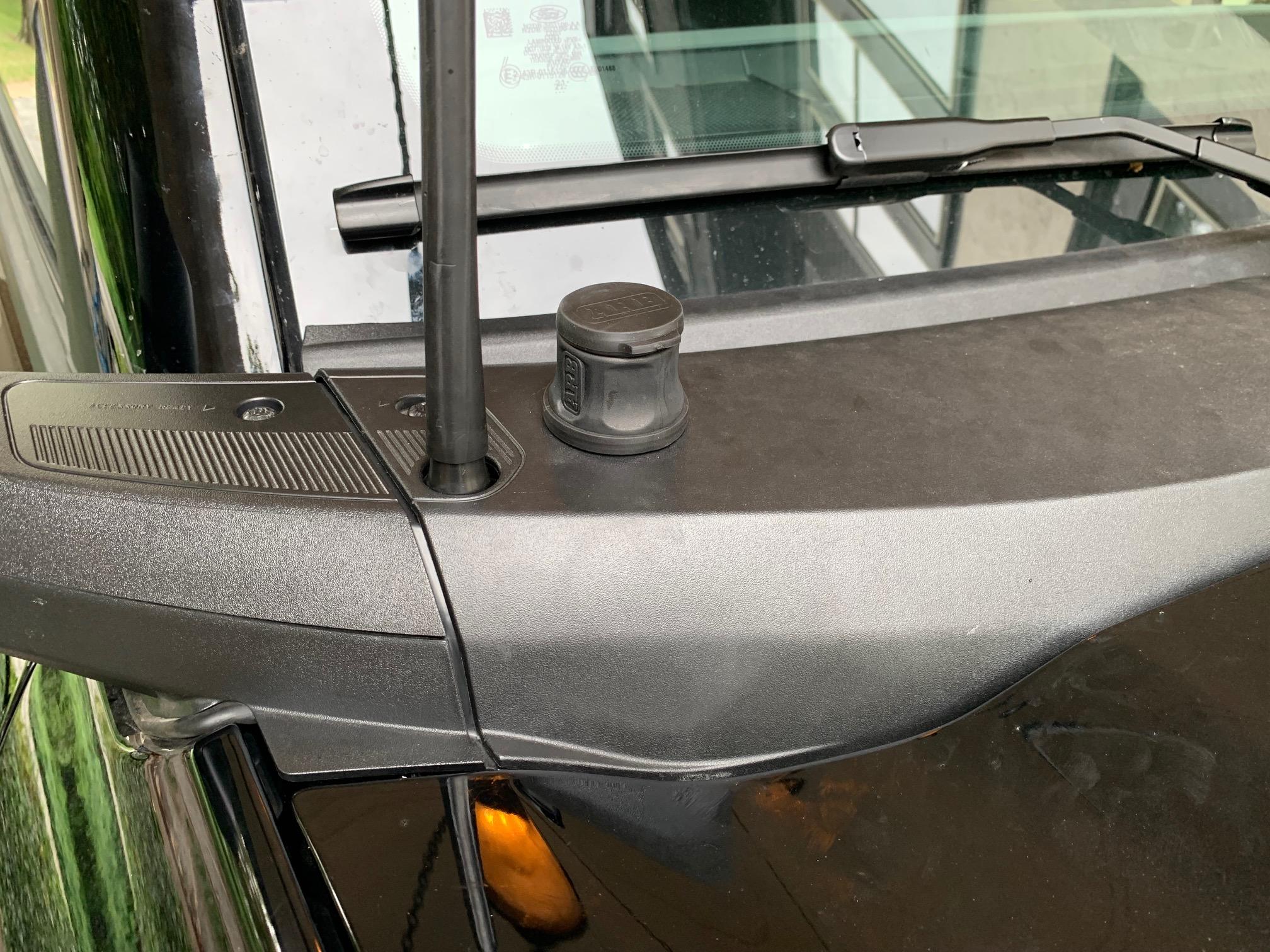

So is the coupling attached to the cowl with a threaded nut? Doesn’t the rubber on the coupling need to push back to release an attached hose? I’m trying to sort how to do the same. Thanks
nottinbe
nottinbe
207
376
St. Louis, MO
Yes that ARB coupling comes with a threaded nut.
Yeah you need to push down the rubber coupling to release it, but it sits in its normally-released position. When you insert the air hose it pops up. Then you push it back to that resting position it releases.

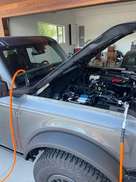

Got everything installed and tested out off-road last week! Ingenious air chuck location! I can top off tires without opening the hood. I dropped to 20 lbs off-road, and got back up to pressure using an ARB single for just a few minutes per tire. I did lift the hood for that. All in all, great mod and nice package from @4x4truckled. Another thread on the single ARB was also very helpful.

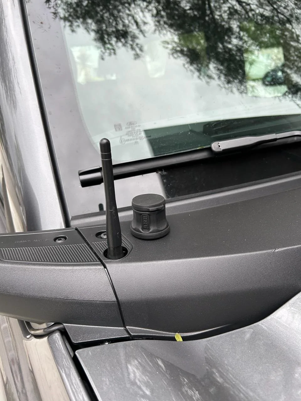

1 x ARB Dust Cap
Thanks for the inspiration (and the parts list). My install here.
