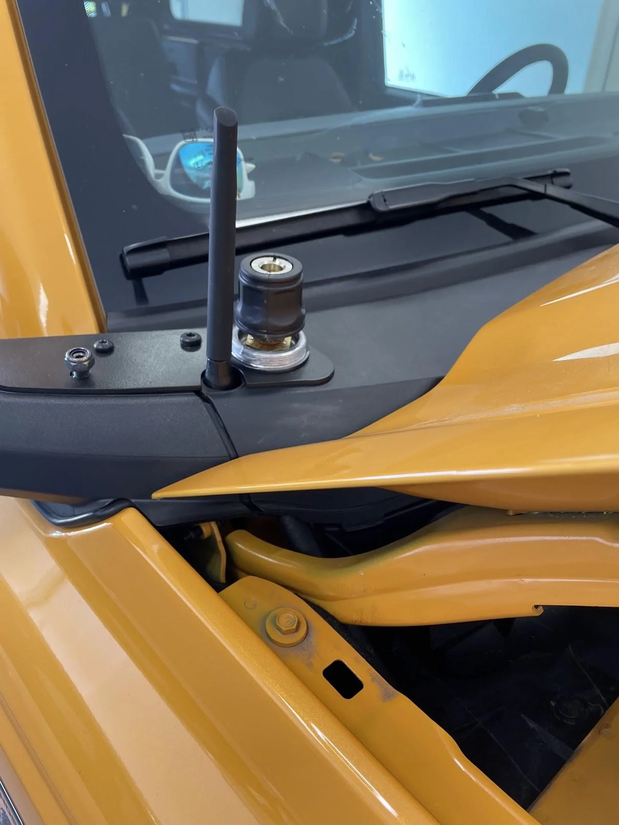

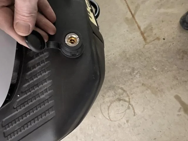

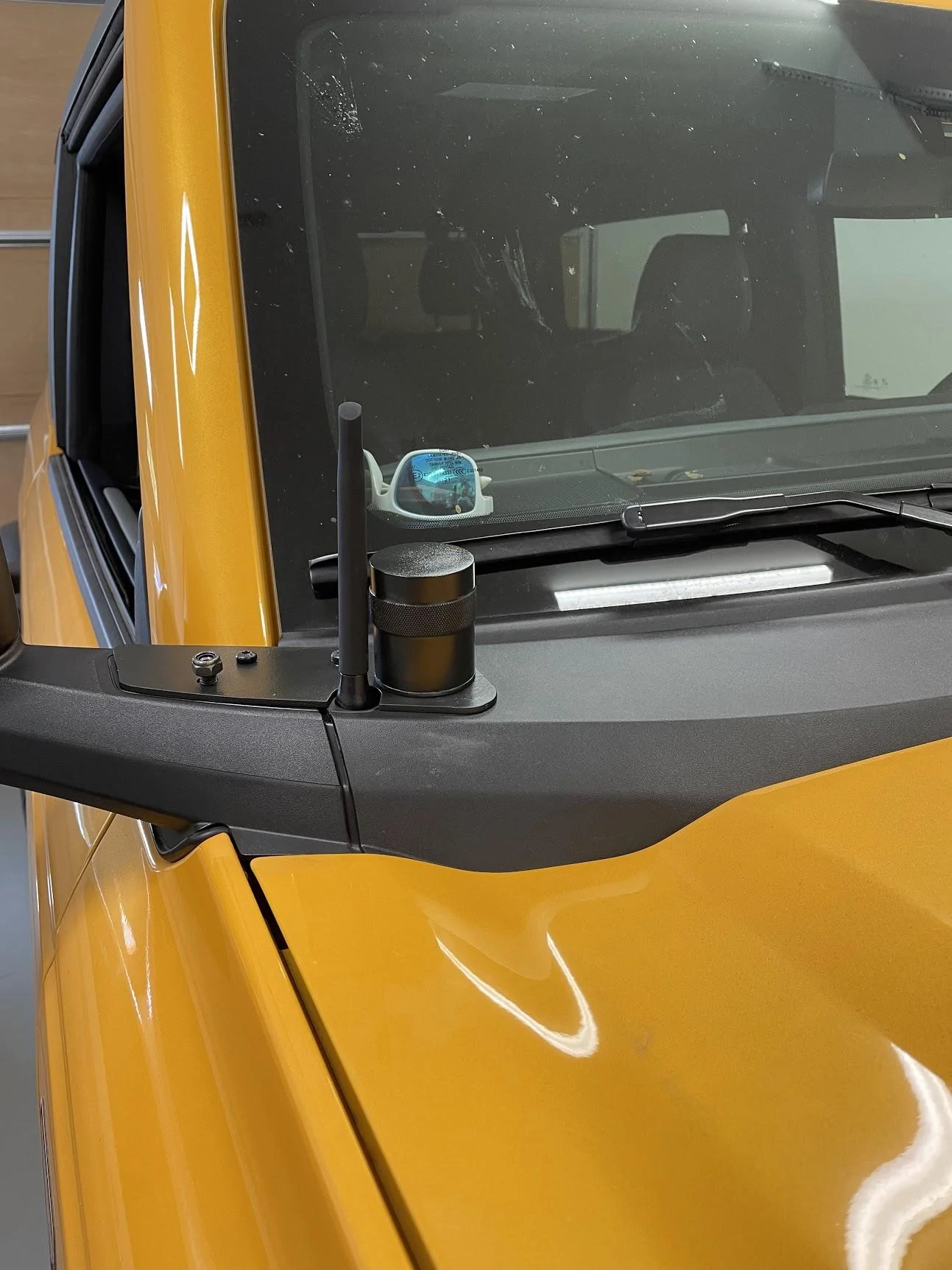

Here is where I put mine... I wired the upfitter to the last Aux switch so I could turn the compressor on/off from the passenger side with window open. I used a "Sherman cap" to hide it. And a dual light bracket (slightly modified with a hole drilled in it) to secure it.

Do you have a parts list(web link?) for the Sherman Cap and bracket you used
Rock Your 4x4 Sherman Cap
- I painted it black
Remote fitting kit
- In order to do this you have to attach things from the compressor (first) to the pillar (last). The space under the cowling is just enough to allow everything to clear.
MandR pillar light brackets
- I cut off 1 screw mount and drilled the hole
- I will use the other mount for a light (on both sides)
- In the future I think I will use the driver side unused mount space (where I did the sherman cap) for a radio antenna
You also might need:
Stubby antenna
Morrflate
- I extended the fitting so that it would clear the stubby antenna
