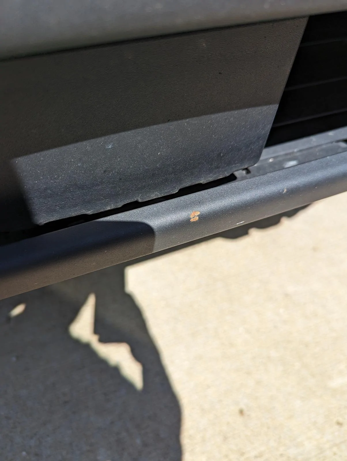

My steel bumper is showing some signs of rust. I'm guessing its where some rocks hit and chipped.
Anyone else got some rust going on? I know painting it is a way to stop it from spreading. But can I paint the steel bumper? Any other options?

Get Satin Black spray paint with a good primer paint combo at the hardware store like Krylon and spray some on a Qtip then just dab it on and almost like new. Let dry for a few minutes and do a few coats.

Yup could Linx it.

Once you get the paint touched up, I really can’t recommend CRC Marine Rust Inhibitor enough. I’ve applied it a few times, especially around the bronco bolts. Spray, wipe off excess with rag and forget about it. Once a season (assuming you have 4ish of those like we do in Michigan).

If it were me I would probably paint it with bed liner, Line-X, Raptor Liner, Rhino-Liner never need to worry about rock chips anymore

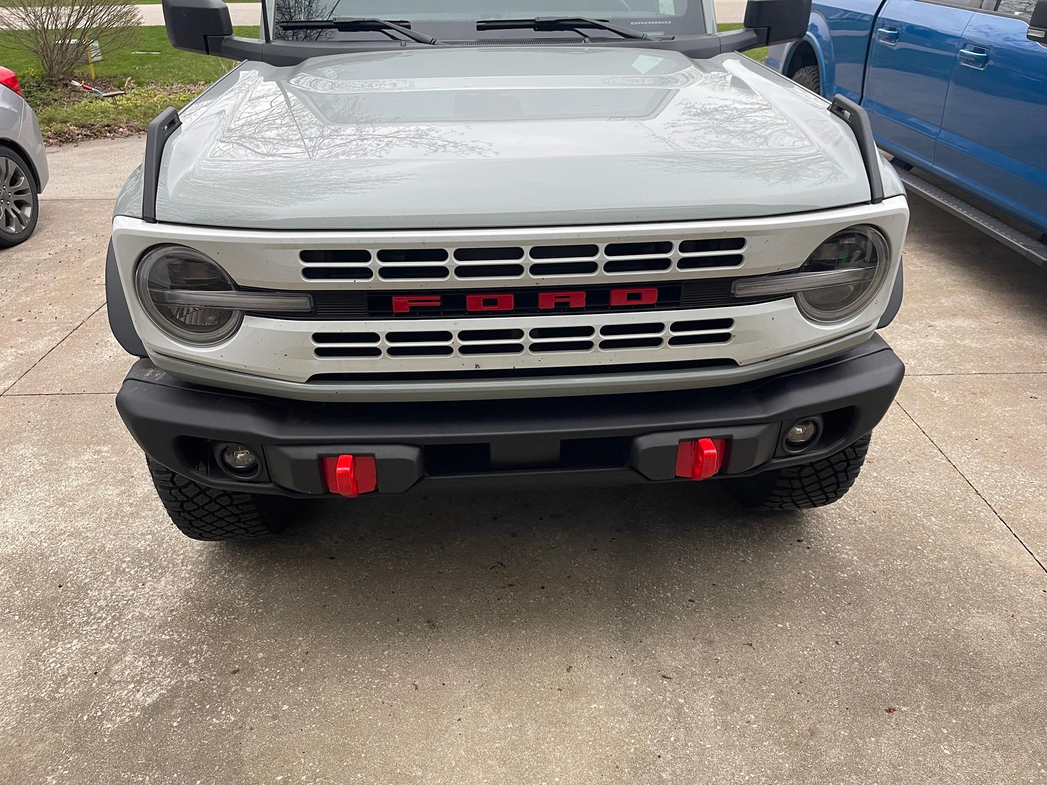

Capable bumper tow hook pins started to rust. Changed them out for the red motorcraft ones. Also have the white DV8 shackles ordered, the red ones didn’t match the ford performance red. Had to order isolators too because the ones the shackles come with are way too thick to work with the motor-craft tow hooks.

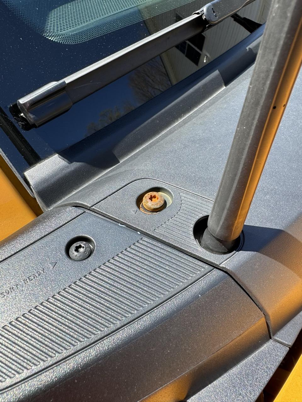

I have this one single effing rusty screw!
Ford Bronco Anyone else getting a little rusty? IMG_5552
Same screw on both driver and passenger sides is rusty on mine too.
There's several items under the car that get a little rusty, so I just take a rag and coat those spots with oil after oil changes.
