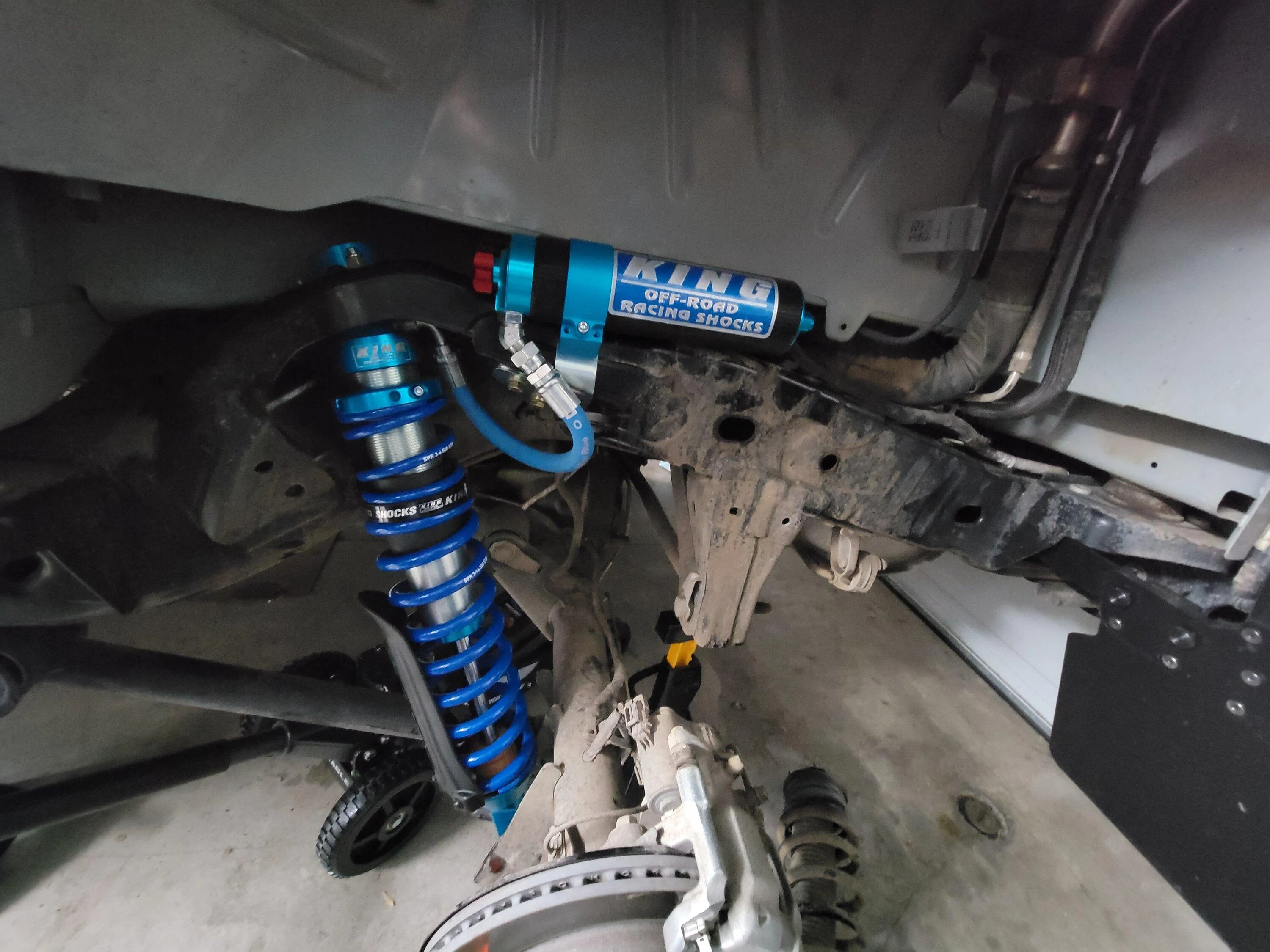

I installed the King adjustable coilovers last week and so far so good. I had the front for a few months sitting and just received the rear a couple weeks ago as they were waiting for springs. I had them ordered from November. Definitely smoother over the stock sasquatch suspension at higher speeds off road. It also seems a bit smoother on the highway. I also installed Camburg's upper control arms as well as the trailing arms.
The only complaint I have so far is I am getting noise from the back slider between the two springs. I called King and they mentioned it is coming from the slider and it should break in by 1000 miles. It has seemed to lessen, but I only have a couple hundred miles on them.

What do you have the compression adjuster set to for street driving?

Right now I have it on the softest setting. I have only done a slow offroad trail and on the highway. I am hoping to take it out to Johnson Valley in the coming weeks and try some other settings.

You can add a little dry silicone spray on the body where the slider rides. should help in quieting it down some. It should eventually wear in and get quieter.
