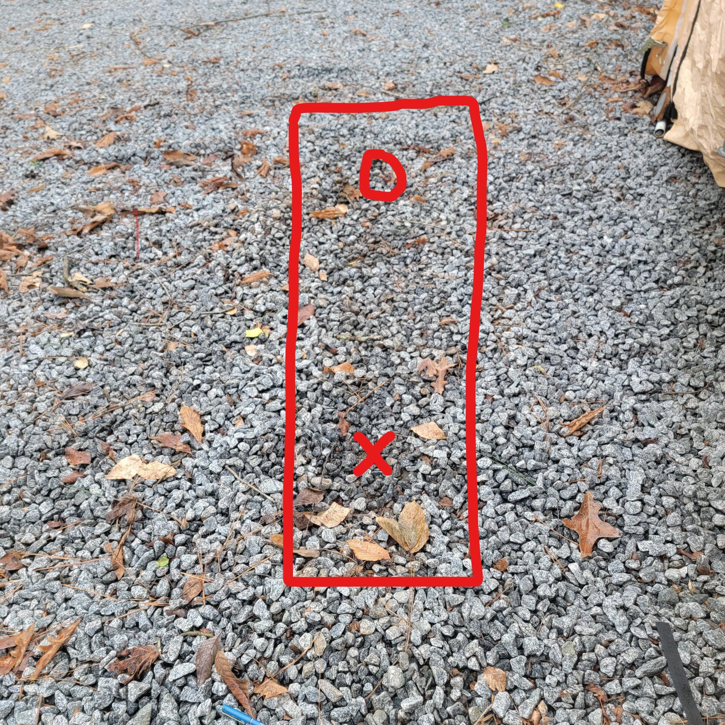

I also broke front passenger axle at the CV joint. Big Bend. 35inch tires, 2 inch Rough Country lift. I was in my driveway on a course gravel parking pad. I was backing up, passenger rear wheel spun. Thought, perfect time to try 4W options. I wanted to crawl out of hole, so did not use much pedal. I could not get out of the hole under any 4w modes. Gas'ed it and spun out. Gave the keys back to my wife (her ride) and said, your 4wd sucks. I am very seasoned 4wd guy. The next day she calls me on the way home from work and said there is a noise coming from the front end. Looked at the axle and boot twisted. Yes broken axle. Towed to dealership 5 days ago and still don't think they pulled it into the shop. I know it's broken, service dept wont know until they actually put eye on it. Today, I called parts dept to make sure they had new axle in stock, if not I would order. I was told that there are 8 axles on back order and should be at the parts hub on 1/14. That is all I know to date 1/10/22. Lots of posting here and didn't get through them all. I think there were two other reports of broken axles. Did I miss any. Picture: x represents rear tire and 0 the front. i filled in the divot for rear but realize after the front wheel barely spun if any at all.

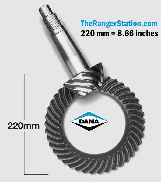

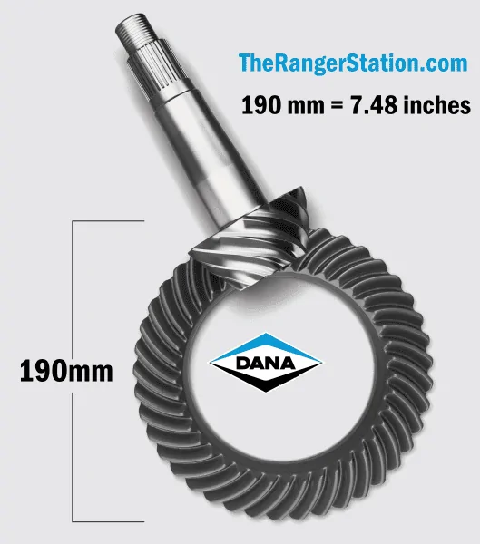

0.78 inch difference in the m210 axles. also the m210 has 1500nm more torque capacity.
i know the pic shows the m220 but you can see theres a difference. and 1500nm of torque is about 1100ft lbs of torque which is quite a difference.
Ford Bronco Another Broken Axle / CV Joint 1642623042512
Ford Bronco Another Broken Axle / CV Joint 1642623050592
https://www.therangerstation.com/ranger-tech/dana-advantek-axles-ford-ranger/
now i'm not saying the OP's axle should have broke so easily, but a reason why the larger wheels and tires get a larger axle.
