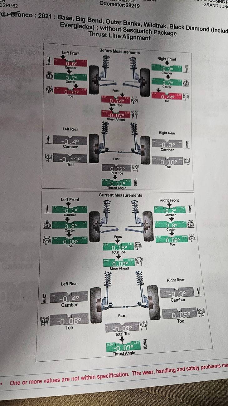

I just got done adding Pro Comp upper control arms and adjusting my Eibach's to, hopefully, their final height. I did a "Hillbilly Alignment" with strings and a level for camber and it drove fine but took it into Firestone, also have the lifetime alignment, and it was way off!!! On one side at least. I'll post pics of the before and after when I get home.
Ford Bronco Alignment after lift 20250702_151951
How much lift? and yes, doing UCAs I would assume it would be required, especially Camber. Good Info. I've felt I can usually see more than 1/2 degree camber but maybe not.
I'm curious on height too, I'm pretty close to stock but will no doubt be adjusting higher later this summer
Probably 2.5-3" from stock Black Diamond. From ground to fender front 39.5", back 40.25".
