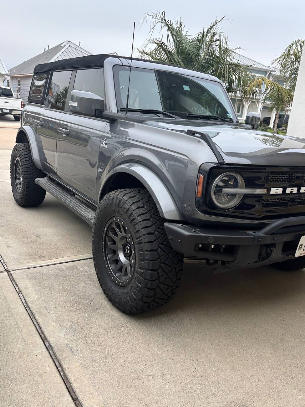

Good day all. Need some advice on leveling kit and fitment. I just had my dealer install the ford 2 inch performance lift (struts with coil overs) on my 2023 OBX. I like the product but still have the drop in the front. I purchased a KSP performance leveling kit (puck) but I’m not sure if it will fit. It seems as though the studs are too long at the top of the strut. Any advice would be greatly appreciated.
Ford Bronco Rear spacer lift - no alignment needed? IMG_2279
Advice would be to leave it that way such that its then level if you put basically anything in the back (like people, stuff, etc). Otherwise you don't look as good as you think you do in the driveway unloaded when you're driving around dragging tail
Fisher
Randy
Jan 4, 2025
2023 OBX
Thanks. I did think about that but just can’t get past the 2 inch difference
Fisher
Randy
Jan 4, 2025
2023 OBX
I would think that the coil overs would take a lot of weight to squat it down a huge amount. Your thoughts?
