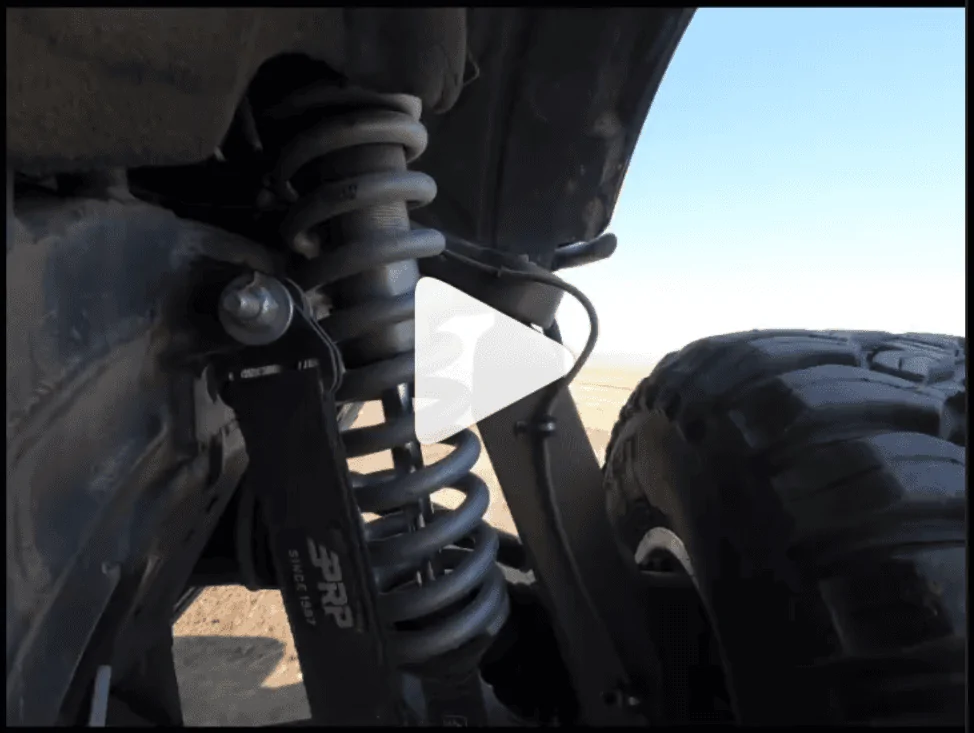

Here is screen shot from kracker fab insta video watching ADS shocks.
I would like to know if the limit strap is significantly trimming the extended length of the shock.
But, even if it was limiting the extended length to that of the Fox, it would still have more travel. (according to numbers provided above).
Check out that CV angle.
*this is an ultra 4 car with front portals and aftermarket lower control arms. I can't imagine they would use stock axles.
I’ll ask them what they are limiting at. Limit straps are an easy fix we can do if needed or wanted by anyone.
