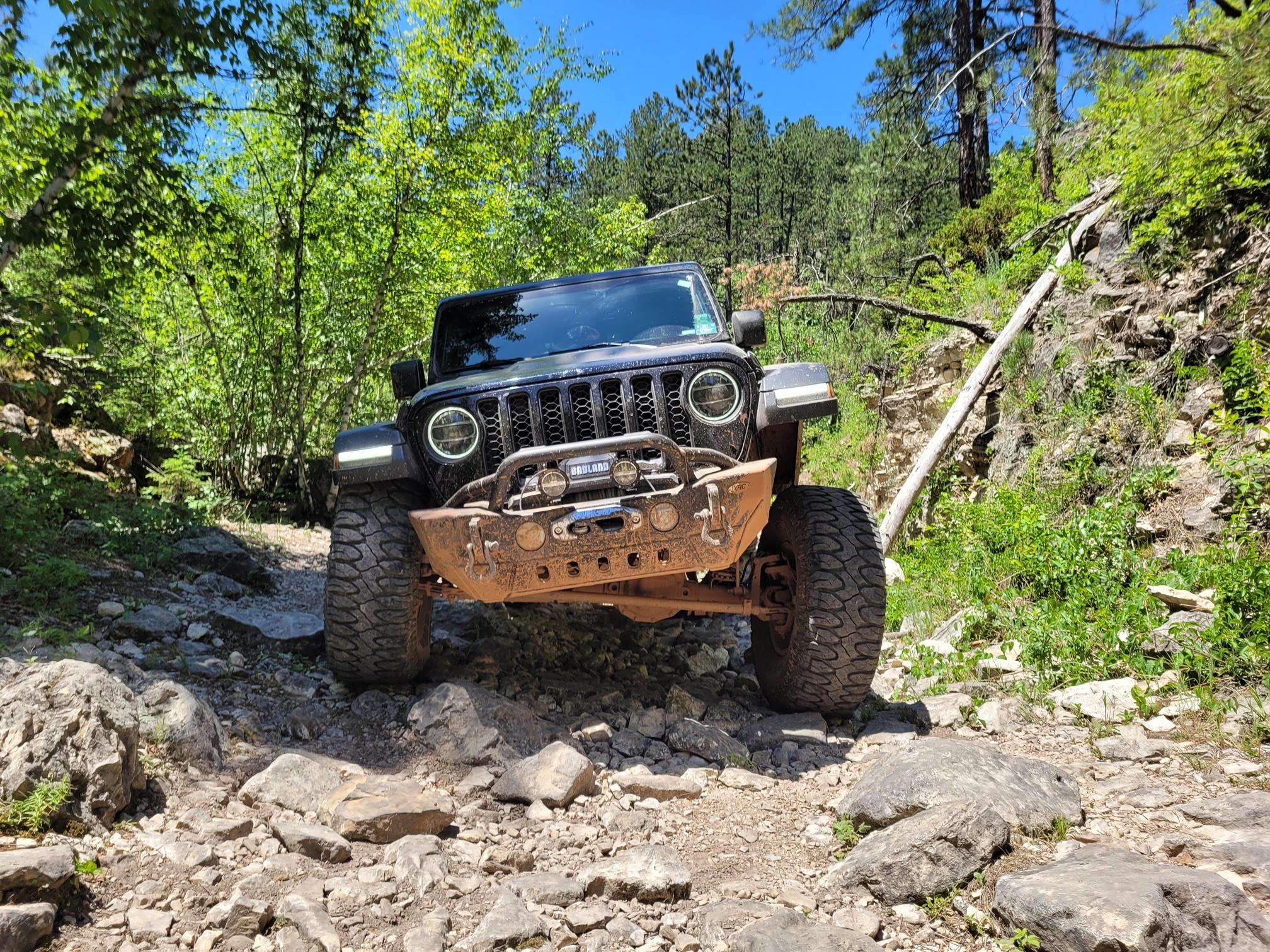

I am spoiled and I'm trying to get close to this. Those are 38's with three inches of lift
