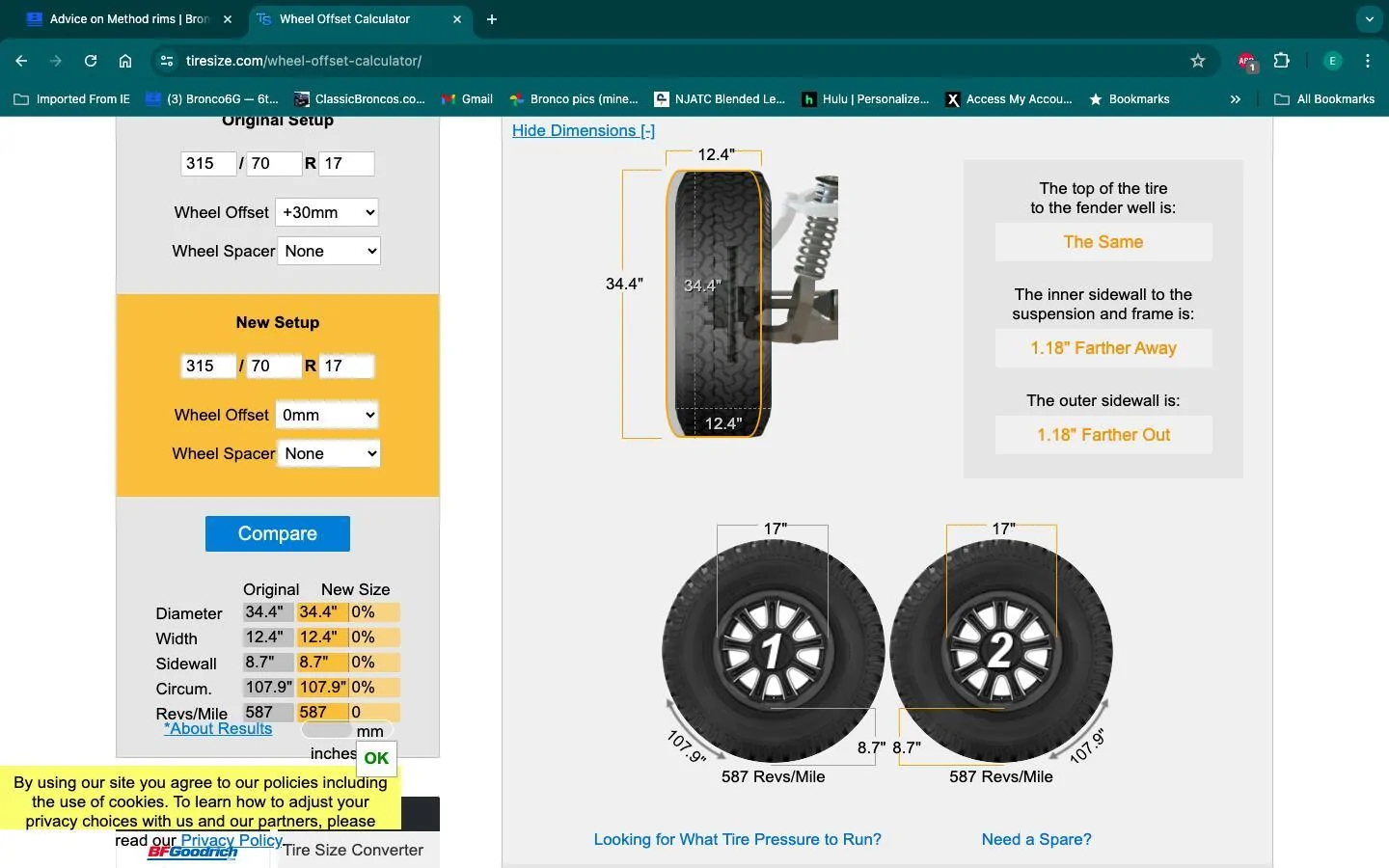

Going zero offset now will move the tire out 1.18"
Seems like some folks with 37's have been fine with 0 offset, others add the spacers.
That is pushing it way out there, in my opinion, but I have not really dug into the fitment needs for 37's.
https://tiresize.com/wheel-offset-calculator/
