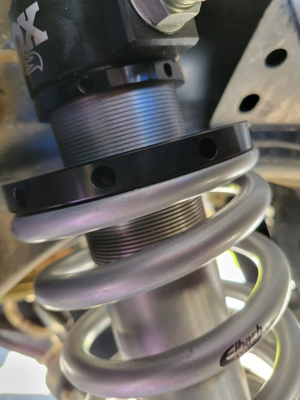

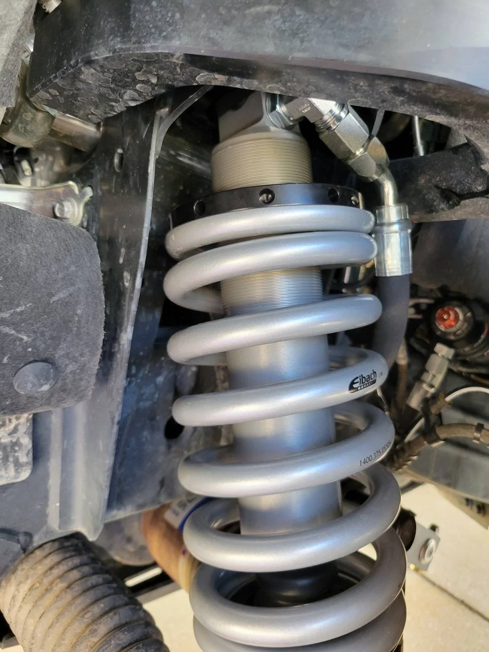

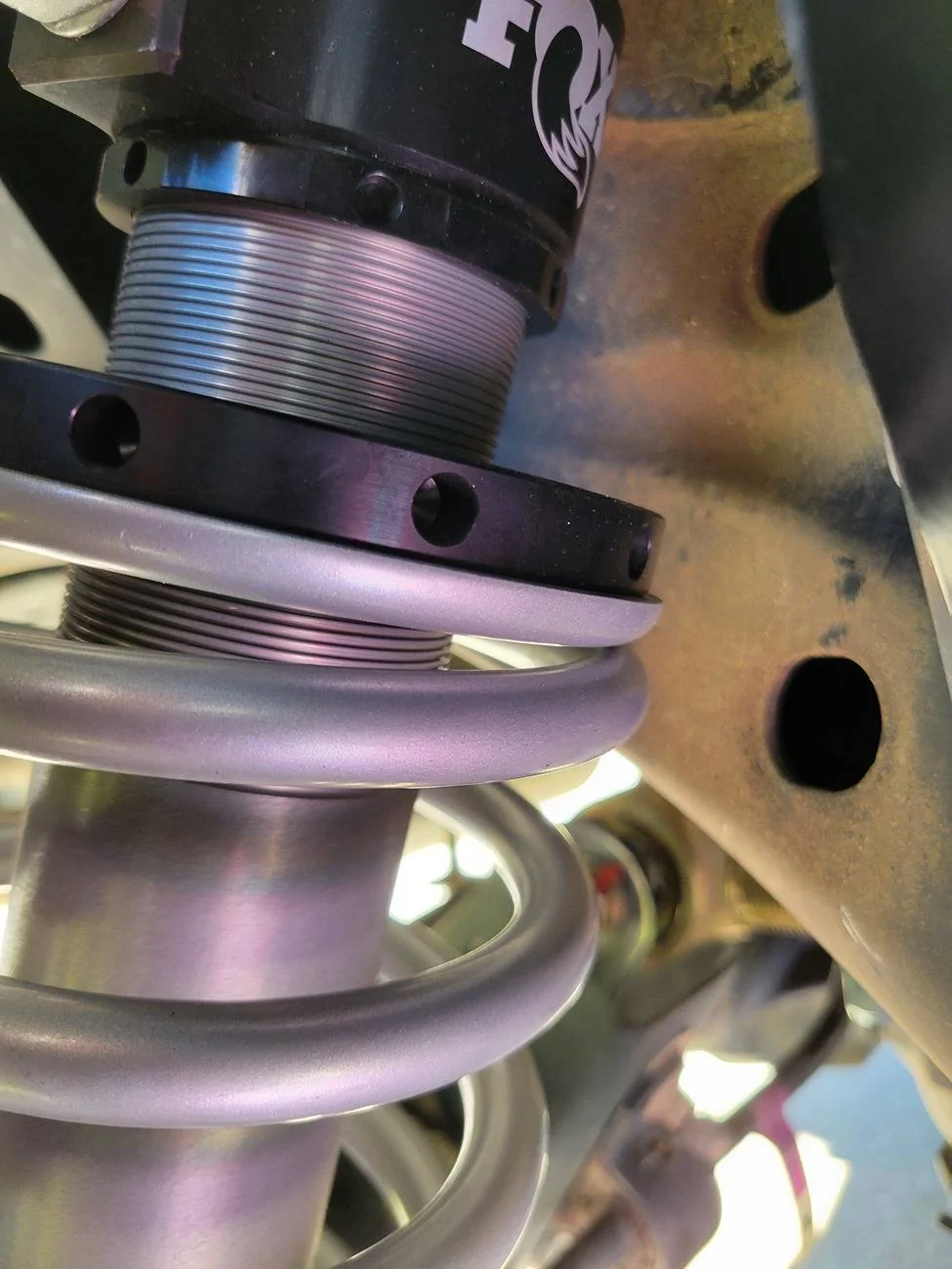

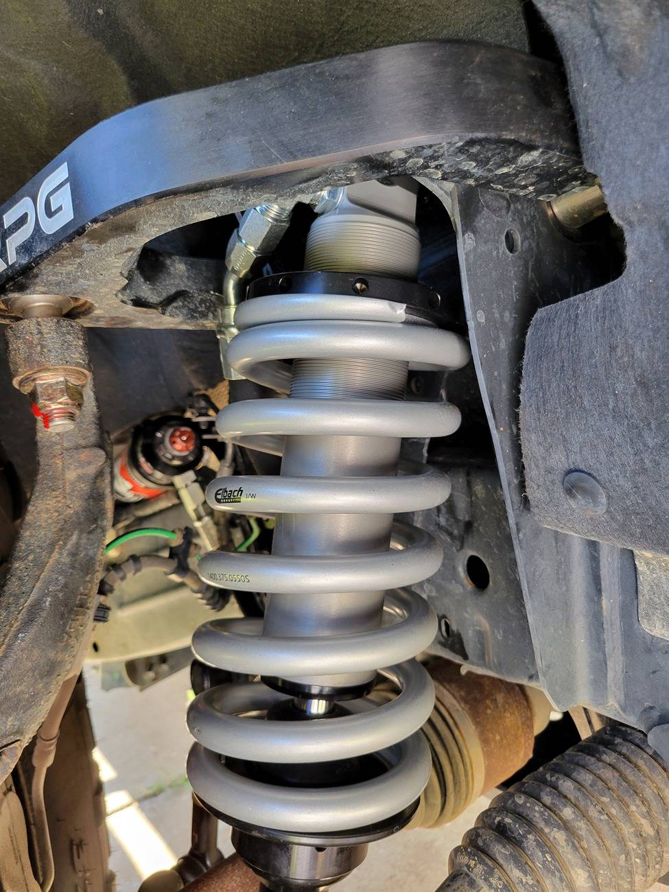

These are the measurements I came up with
Front Driver preload adjustment 1 5/8" above the ring 1 5/8" below ring, spring 9 1/2", total shock length from top of bucket to center of bottom mount 21 1/2"
Front passenger 1 5/8" top 1 5/8" bottom, 9 5/8" spring, 21 5/8 total length
Rear driver 1" top 1" bottom, 9 3/4" spring, 23 3/8" length
Rear passenger 1" top 1" bottom, 9 3/4" spring, 23 3/8 length

The fox shocks are at the limit of extended length wrt CV binding. Anything more than 24.3” is the danger zone. I would not add even a 1 mm spacer to your setup. First thing to check is the spring preload. As mentioned make sure the rear is set to lowest allowable and try to adjust the front. I assume the fox shocks have a threaded collar. This is fairly easy to do yourself.
Can you get pics of the current location of the threaded collar? Did you get installation instructions from shocks? Collar upper and lower limits should be included. Take some measurements and see where you are wrt to guidelines from fox.

In case you grab a beer and head out to the garage to make an adjustment - a few notes to spare you some drama. First - assuming Fox is still using the terrible single split ring design for the preload collar be VERY careful not to loosen the pinch bolt more than a few turns with spring tension still on the collar. The collar will jump the threads on the shock body and you'll be disasembling the thing to get it back in place after you take spring tension off completely. Ask me how I know this.. haha
Two - that preload collar is going to be under quite a bit of tension with that 550 lb spring as you try and crank it down some. The pros will tell you not to try and make adjustments with any spring tension but the garage mechanics will tell you its possible but hard. The proper collar wrench makes it easier though I've seen it done without it. Make sure the threads below the collar are clean and lubed if you're trying to raw dog it under tension. Easiest way to do it is just remove the whole unit and throw it in a spring compressor to get the tension off.. but I understand not everybody has the ability and resources to do so.
Did you take heigh measurements before the install? I'd ease the rears off to as low a setting as you can get to then match the fronts and see where things sit. If its all installed correctly it shouldn't be wild.

Definitely start with rear, lower spring rate will be easier to move collar. Get weight of the tire by jacking up that wheel a little.
before you start adjusting collar I would see what guidance fox supplies with these coilovers. They should have some documentation online to what the adjustment limits are in their opinion. See if your rear is at the lower limit first. If not then lower some by relieving preload. Collar moves towards increased spring length to reduce preload and this will then lower ride height.
edit. Be careful with compressed springs if you are not comfortable doing this. They have a significant amount of stored energy.
it looks like the shop just randomly set the collars at their mid point. You should have some room to ad preload in front and remove preload in rear. This will help with ride height.
