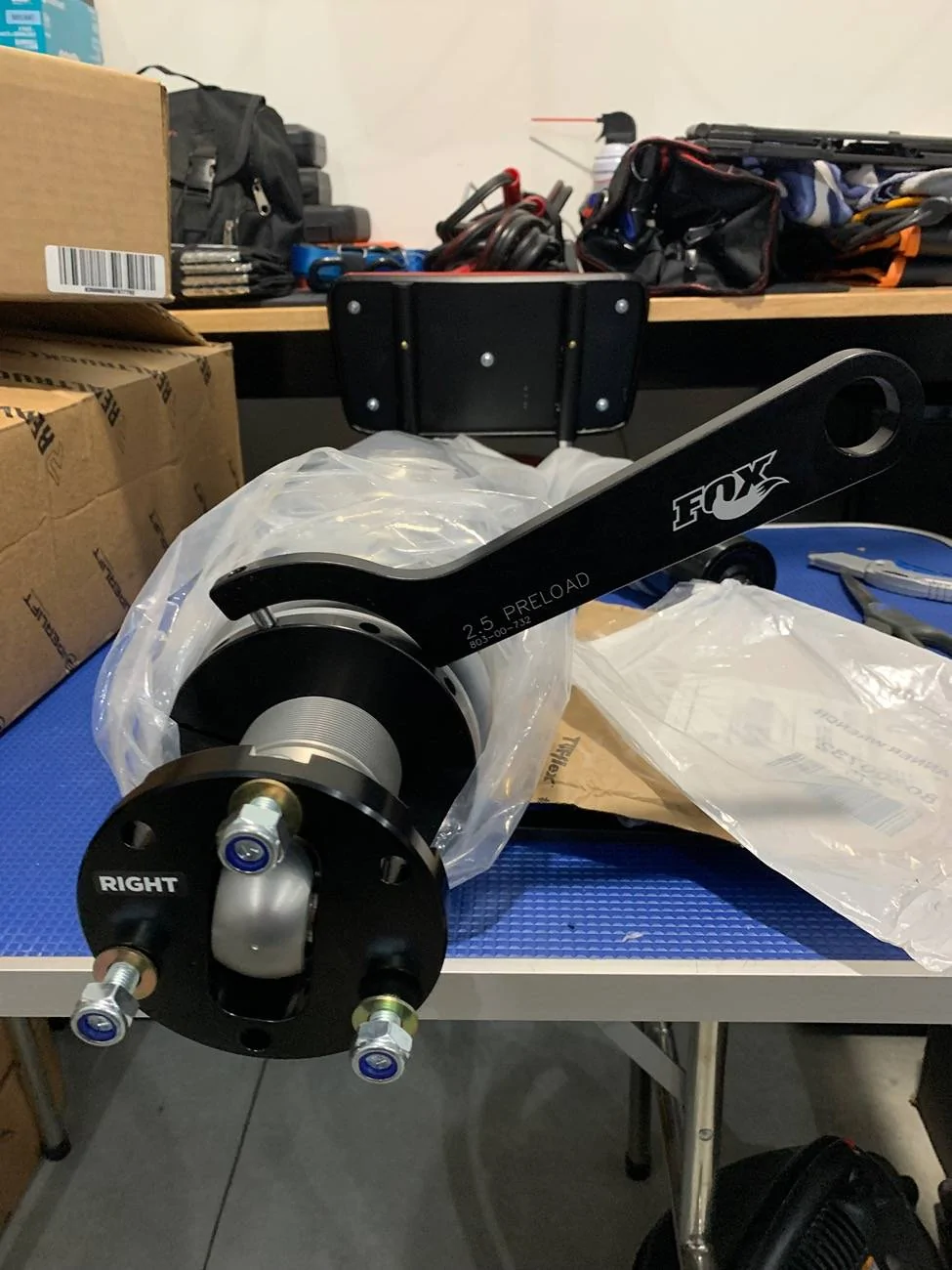

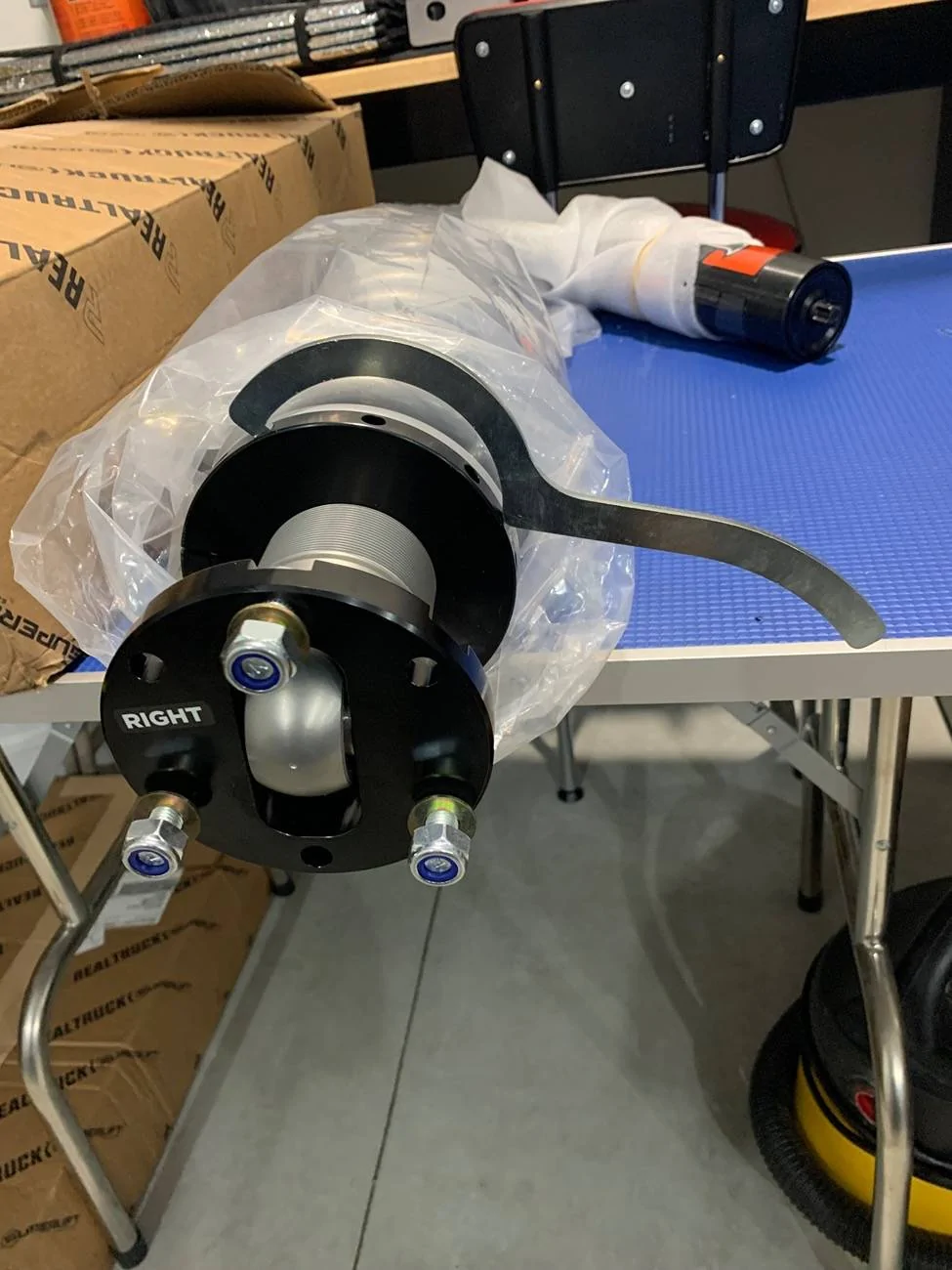

To those of you that have the 2.5 elite coilovers on your Broncos have you had any success on finding the correct Spanner wrench. I purchased a 2.5 preload wrench does not fit flush then bought the 3.0 sits flush but pin in wrench is to big for whole on preload adjuster then bought 398-00-370 Spanner wrench that Fox said was just for those coilovers and of course does not fit flush. Fox needs to educate there sales and tech as they have no clue. i did buy the 8” punches at Harbor Freight and one works perfect it’s just i would like the correct wrench. Here are picks of the 2.5” preload wrench and 398-00-370 wrench now I know I could probably grind the 2.5 to work but come on. Thanks for any help

If you put the peg in angled above the collar, can you rotate it down to the collar?

What is the size of the hole in the adjusting collar? I have the 4WP/ProComp adjustable coilovers and got the wrench from Boss4X4 with the fronts. I used the pin on the end to do adjustments, it looks like it's 5/16".

The pin is not the problem in fits in the hole just won’t go in all the way because of the arch of the wrench not sitting flush with the adjusting collar. I think what bothers me the most is Fox can’t throw in an a wrench that cost under a $100 with coilovers costing around $5k

I can see the arch is wrong, that is why the Boss4x4 one works well by using the pin on the end so the arch isn't an issue. Not knowing how hard your collars are to turn might be an issue, but with the 4WP/ProComps, lifting the truck by the frame makes it easy to turn the collars.

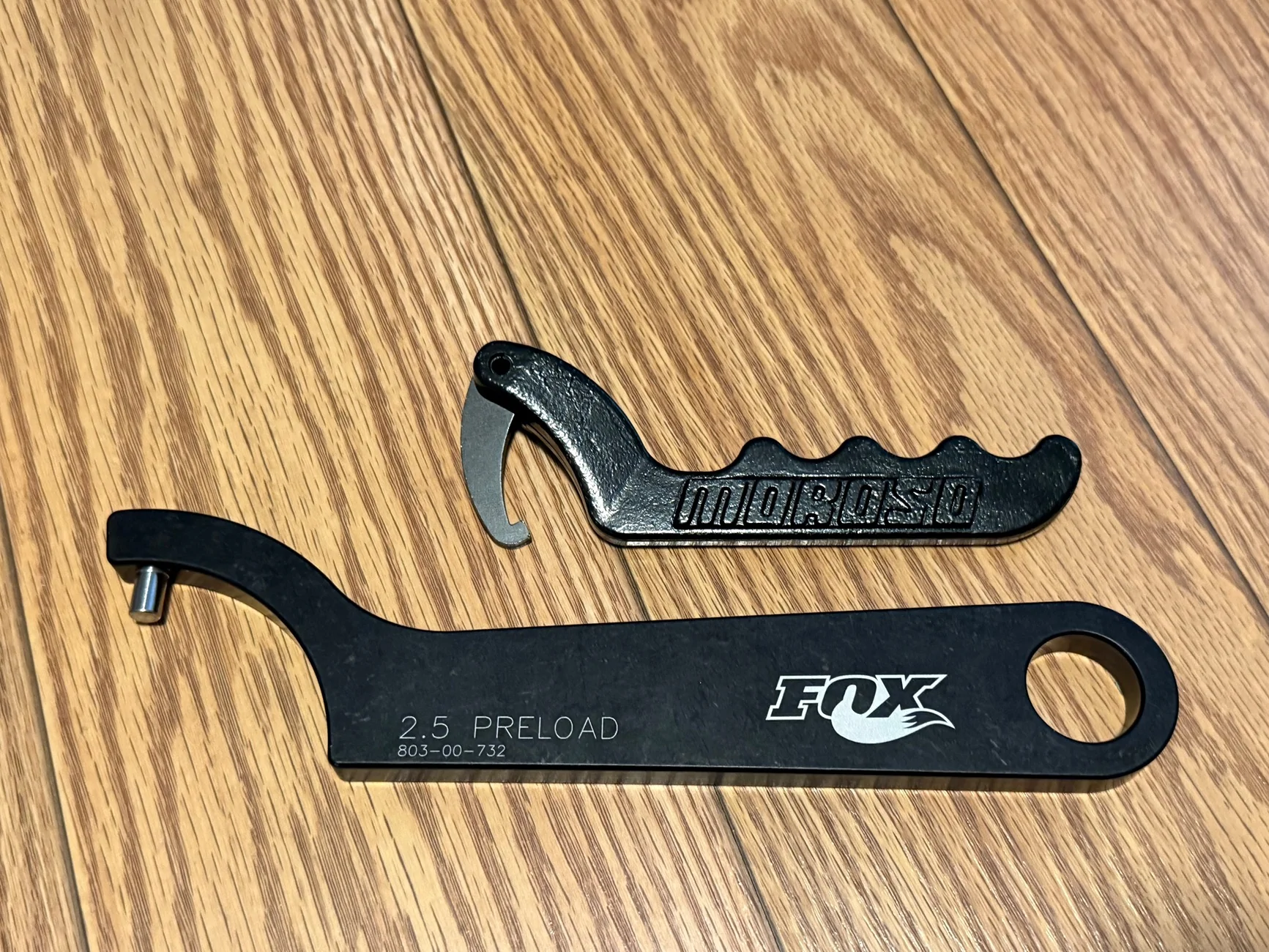

That’s odd. I bought the same one and it does not work. Called Fox and they said they to take the pin from the 2.5 and put it in the 3.0. But it needs to be pressed in

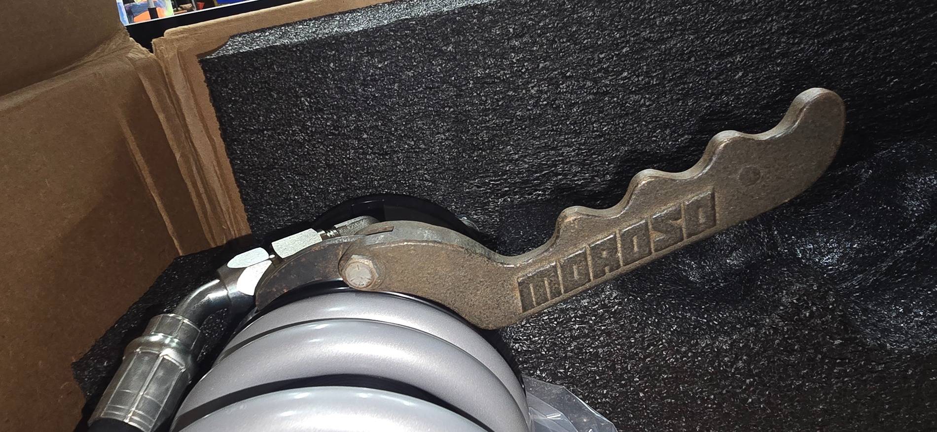

So the Moroso is much smaller than the Fox. Wondering how hard the collar is when they are on the Bronco and would it be enough?
It does fit a lot better than the fox!
