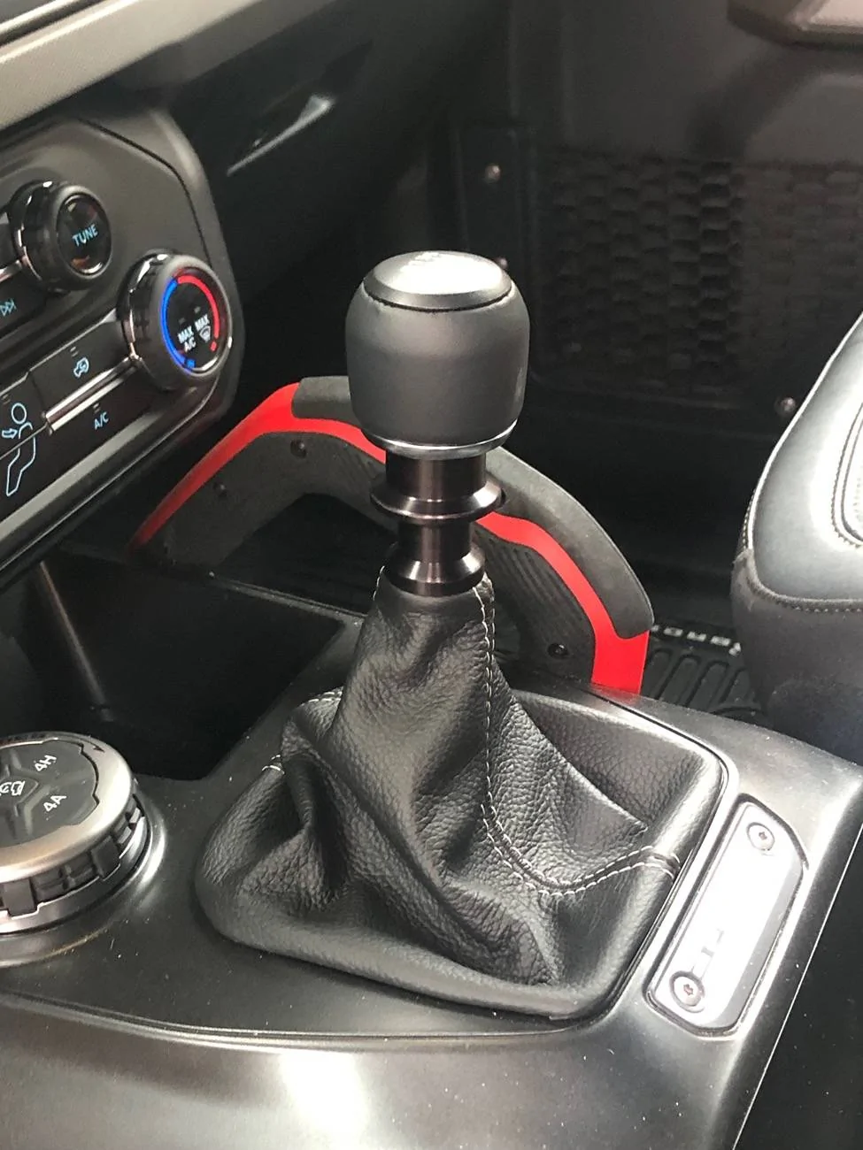

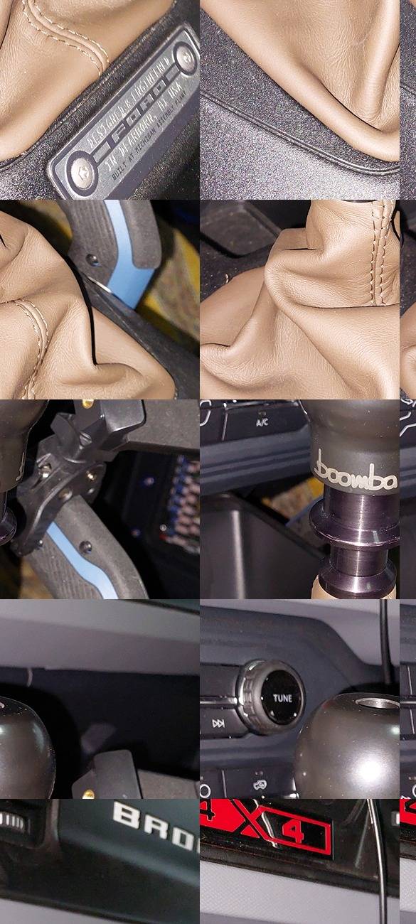

Tried pics, but they all messed up. Installed, 5 minute job if you've done it before. I lost my boomba top. It went flying when I pried it off. So now I'll spend the next 3 hours looking for that
Feels a little tight, doesn't want to drop like the plastic did

I think what's making it tight is the clear rubber (probably plastic) ring/bushing that sits between the spring and the lockout. The inner diameter is ever so slightly smaller in the new metal lockout piece, it puts a little pressure on the rubber, tightening it against the shift shaft.
Easy fix, but im lazy and i left it.
It will wear in at some point
