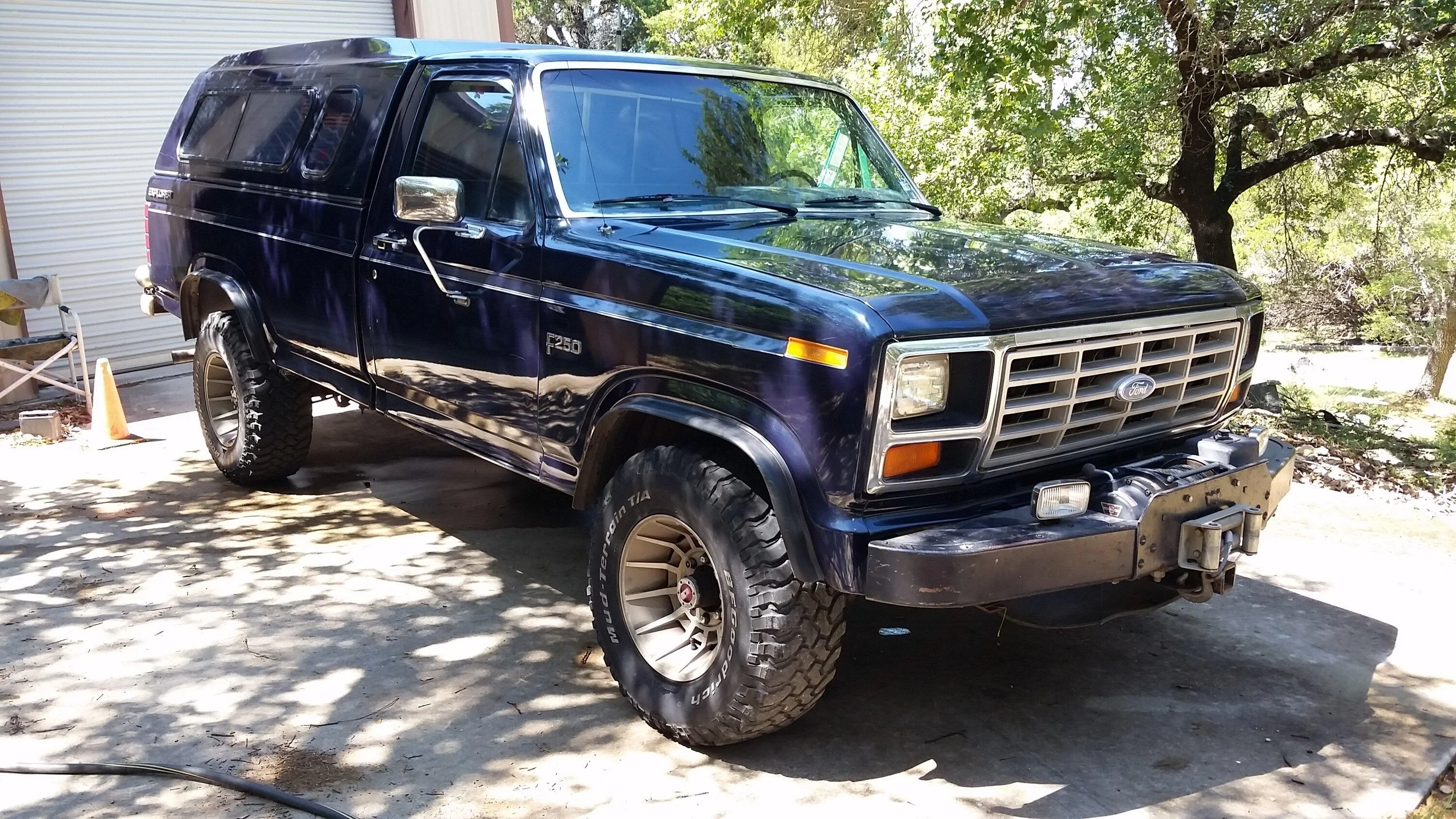

I rotated five BFG MT 33x12.5x16.5 on three sets of tires over 30 years...I was younger then.
Know what I figgered out? Rotating five vs four they last about 20% longer!!!
Your mileage will vary!!!
Ford Bronco 5 wheel tire rotation... Why you should do it! old_blue_apr_2018
