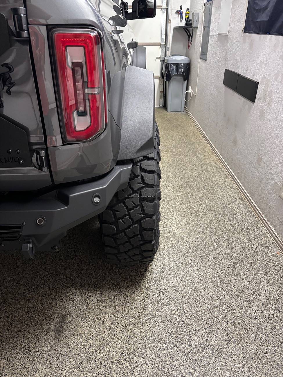

Get ya some aftermarket 17x8.5" wheels with 0 offset and 4.75" BS
This is what it will look like.
My tires are the newly released Toyo Open Country R/T Pros 37x12.50-17
For the front tires, you will have to unbolt the front crash bars and remove them, otherwise the front tires will rub against them.
Ford Bronco 37 wheel question IMG_0946

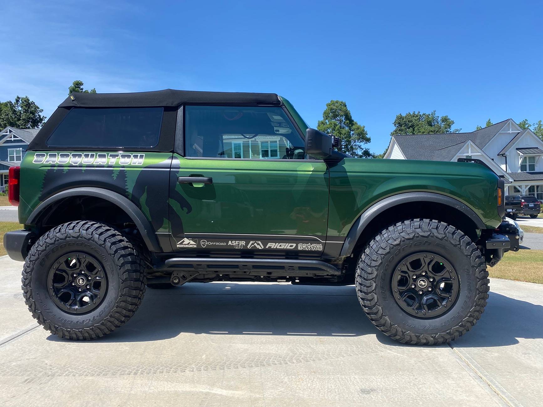

To use the factory wheels, 1.25” wheel spacers do the trick nicely for this situation. I’ve run this same setup along with a couple of friends. We have wheeled them hard. One friend even has the factory beadlock rings.
Ford Bronco 37 wheel question IMG_2732
