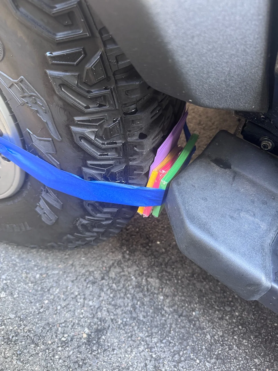

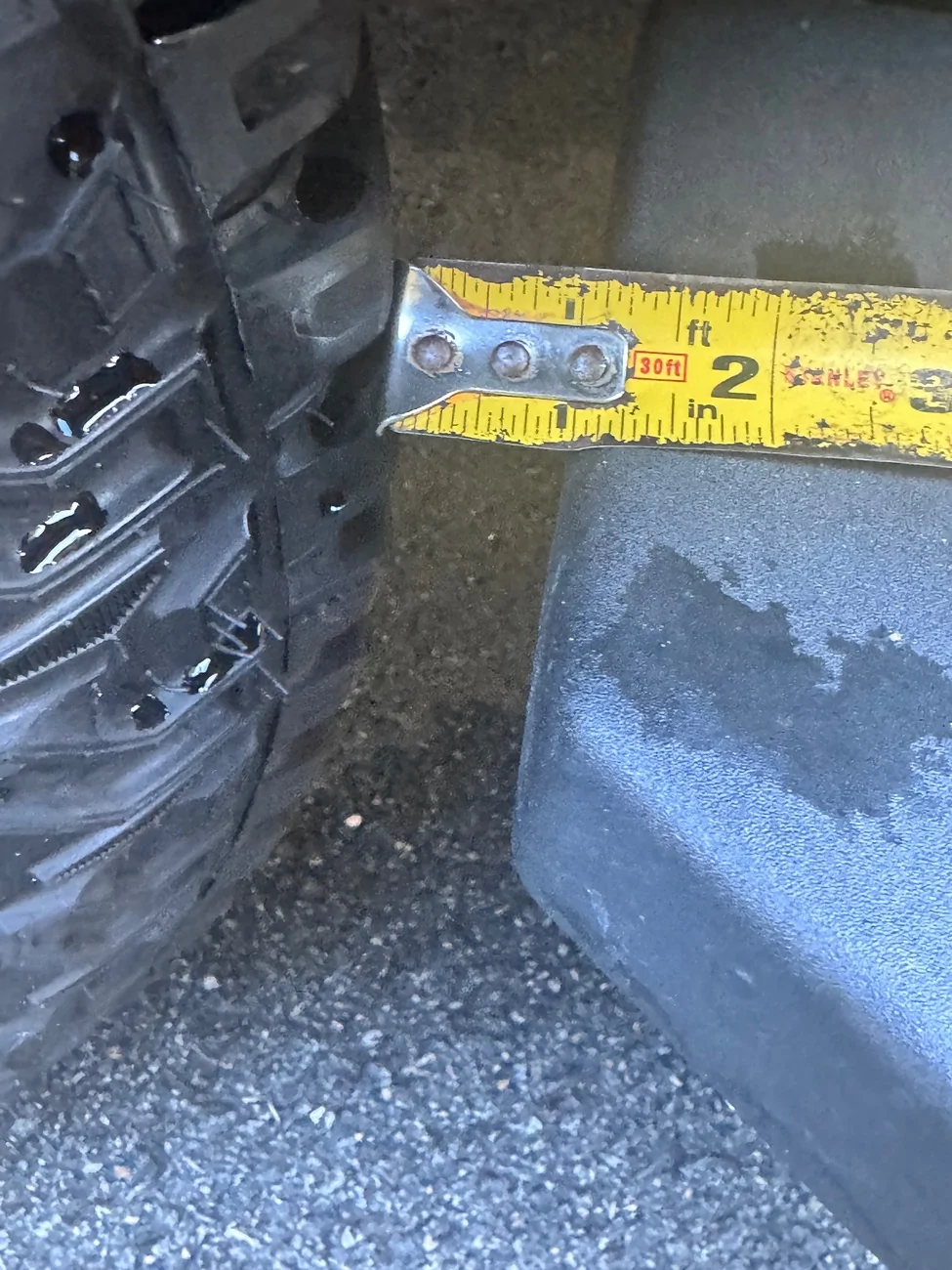

Seems like a really tight fit. Seeing just a hair over an inch of clearance at the tights on stock sasquatch Goodyears.

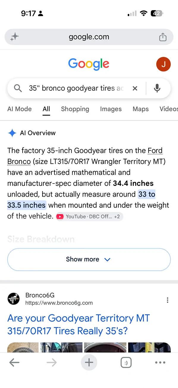

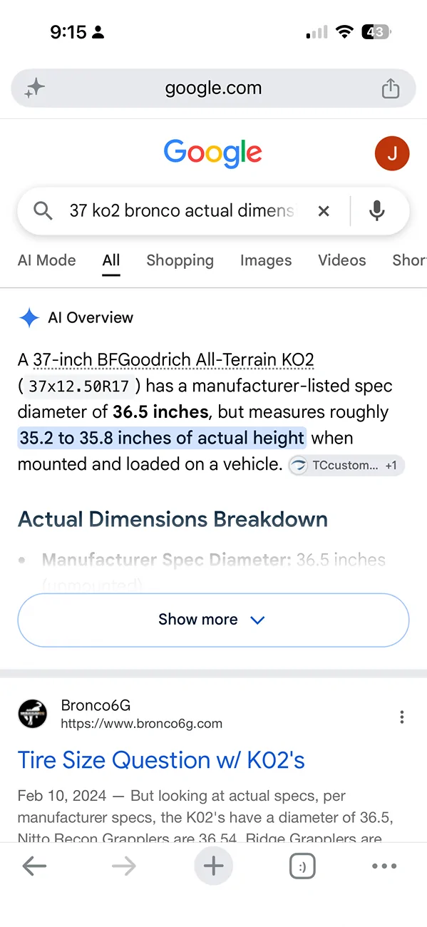

I have stock wheels with 1.4” spacers so slight negative offset. Plan on keeping both wheels and spacers and getting 37 KO2s. Reading actual size of stock tires are 34.4 vs k02 at 36.5 so there goes my inch of clearance. Maybe I clear by a millimeter or two. Unless those dimensions are off and the ko2 is closer to 36.0?
I don’t think articulation comes into play, nor would a 1 or 2” lift change anything (which I’m considering) since the running board is so closely aligned to the center of the tire at it’s widest.
thoughts from actual experience?
I don’t want to remove the boards or hack away at them. Other people need them. And the investment for aftermarket boards will probably be a non starter to simply get 37s. So this decision really boils down to whether the KO2s hit the boards are not.

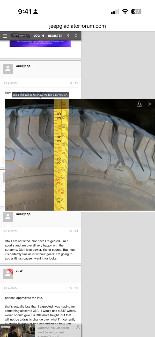

edit found a photo of a ko2 - looks to be around 35.2”. Just measure my Goodyear at 32.8” so that’s a 1.2” difference in radius about the same if slightly greater than the clearance I have now. Ugh. Just measured out 1.2” of index cards to the tire and it indeed hits.

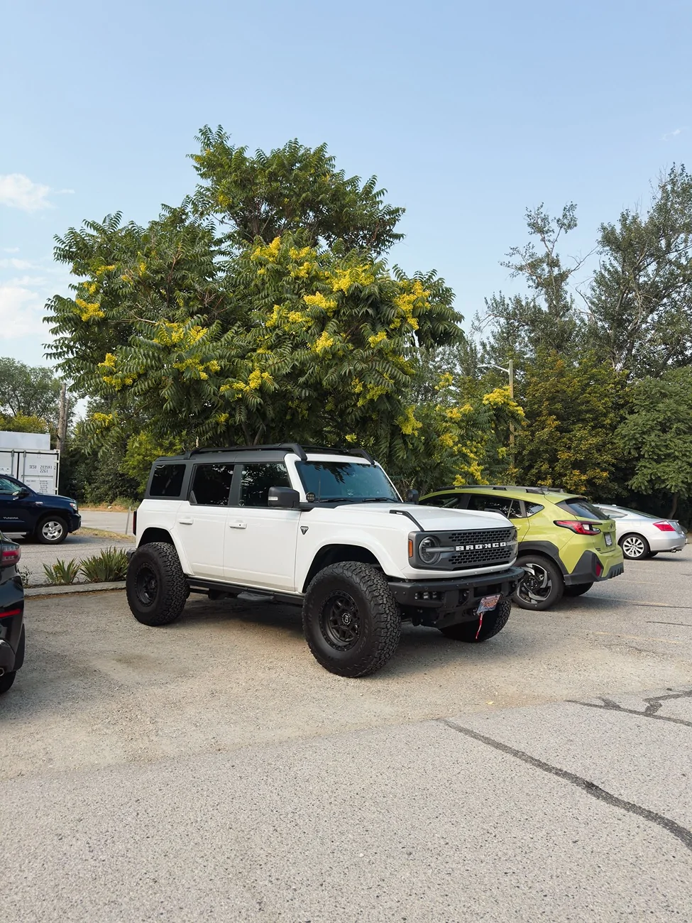

I’m running ko2 37s with no lift and zero offset wheels. I had to trim the front edge of the rocksliders, cut off the crash bars, heat bend and push the front inner fender liners up as much as I could, I also removed some plastic pieces behind the inner liners and to move some wiring to protect them, replaced the fender flares for a high clearance one. My alignment is done by my friends offroad shop, he moves the front wheels forward so I can get a bit more clearance. I slightly touch the inner liners at full articulation with the wheel turned. Nothing that would damage anything tho.
If you’re one of those that like to have a house in your roof you may want to consider a 1.5” lift to put you back at stock height when fully loaded. For me a .25-1” leveling kit would be more than enough.
