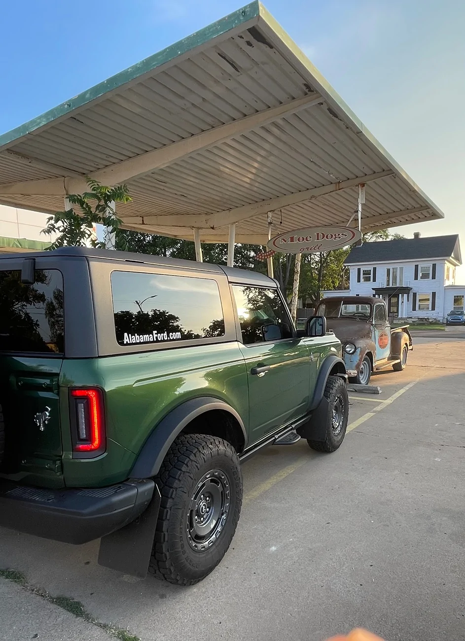

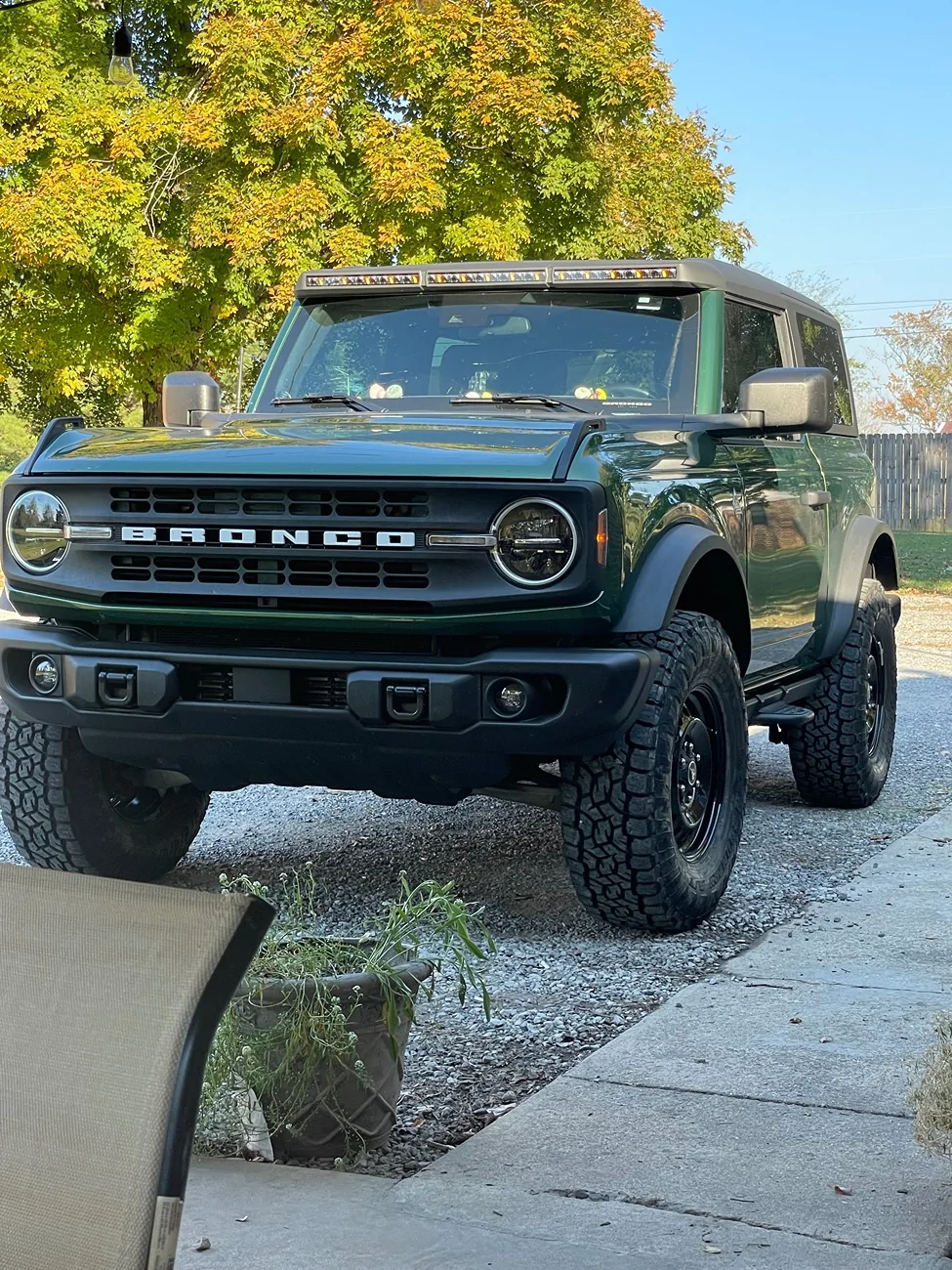

I’ve been running 285/75s Toyo open country a/t 3s on both factory wheels I have I just swap wheels when I get new tires 87k first set last over 60k second set counting
Ford Bronco 35 skinny's?? Sasquatch IMG_6889
Ford Bronco 35 skinny's?? Sasquatch IMG_9811
