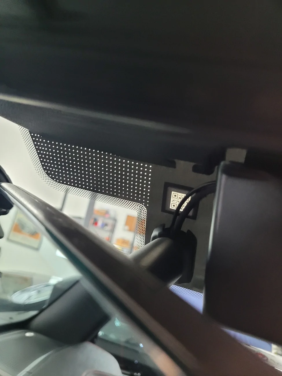

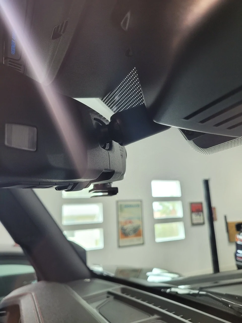

Ok excellent information, thank you. With regard to that harness, this is what the back of my mirror looks like. Do you think it would work? The wires seem to go into the shaft that holds the mirror to the glass.
Unfortunately, the Dongar solution that I suggested will NOT work with your set up - I guess Ford changed the wire connections and no longer use the 16 pin set up on the ‘26 Braptor

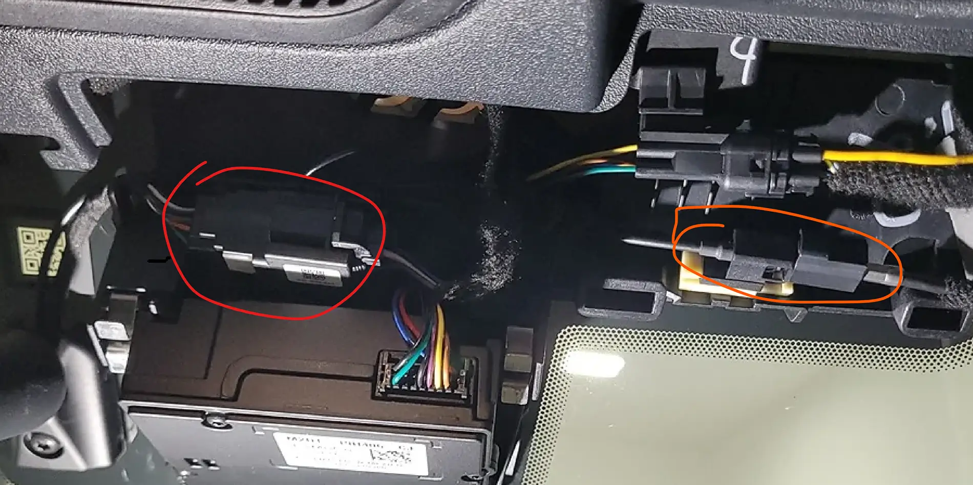

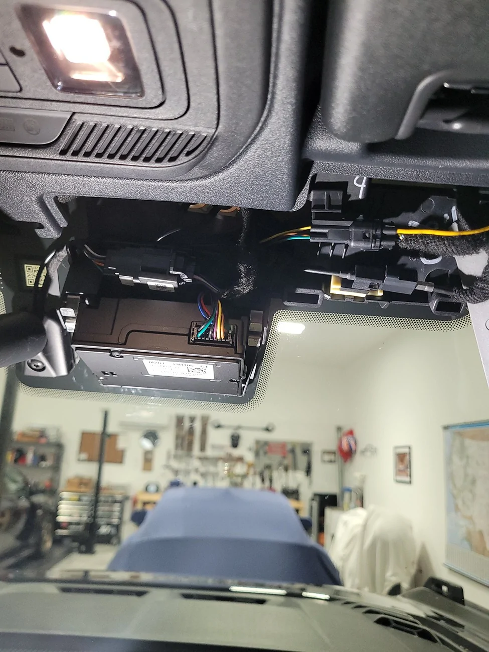

I got it figured out using your advice for removing the plastic box. Here is what it looks like removed and I tapped into the wires coming out of the bottom of that black rectangle in the middle of the picture. I could not gain decent access to the wires up and to the left because the clip that the harness was attached to just wouldn't budge (I didn't try to force it too much).
It's because the 26 uses the Gentex Digital mirror and for some reason Gentex uses a different connector. Same 3 wires run to it, just a different plug. The additional wire you see is the coax to the rear view mirror camera on the third brake light.

Can you take a few close up photos of there the wires from the mirror lead to and are connected? I know they have clips to attach, just curious where they attach and then where that power harness runs to. I am retrofitting my 2025 with the Gentex digital mirror... and want to have everything as close to factory :) thx!

I could be wrong but, I believe the connector in post #7 above illustrates a 16 pin…
The connector circled in red is the 12pin connector to the mirror. The mirror side has a bunch of wires, most aren't used. The car side of the connector should just have three wires. The mirror really only needs power and ground to work.
The connector circled in orange is the coax cable that runs back to the rear view camera in the 3rd brake light.
