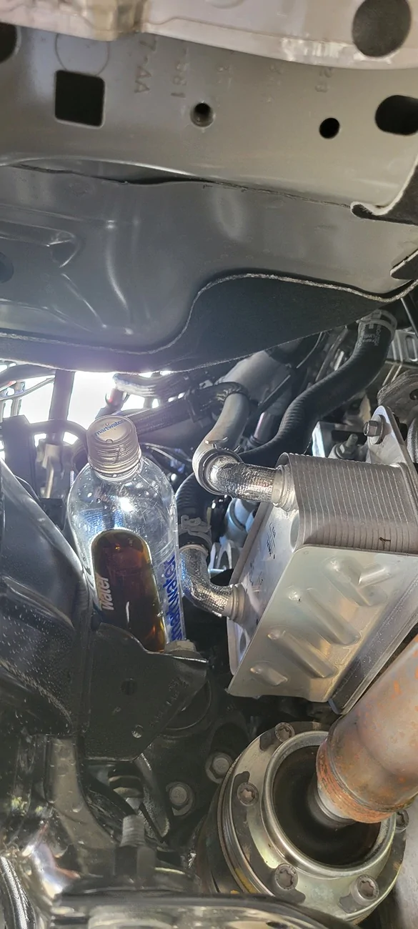

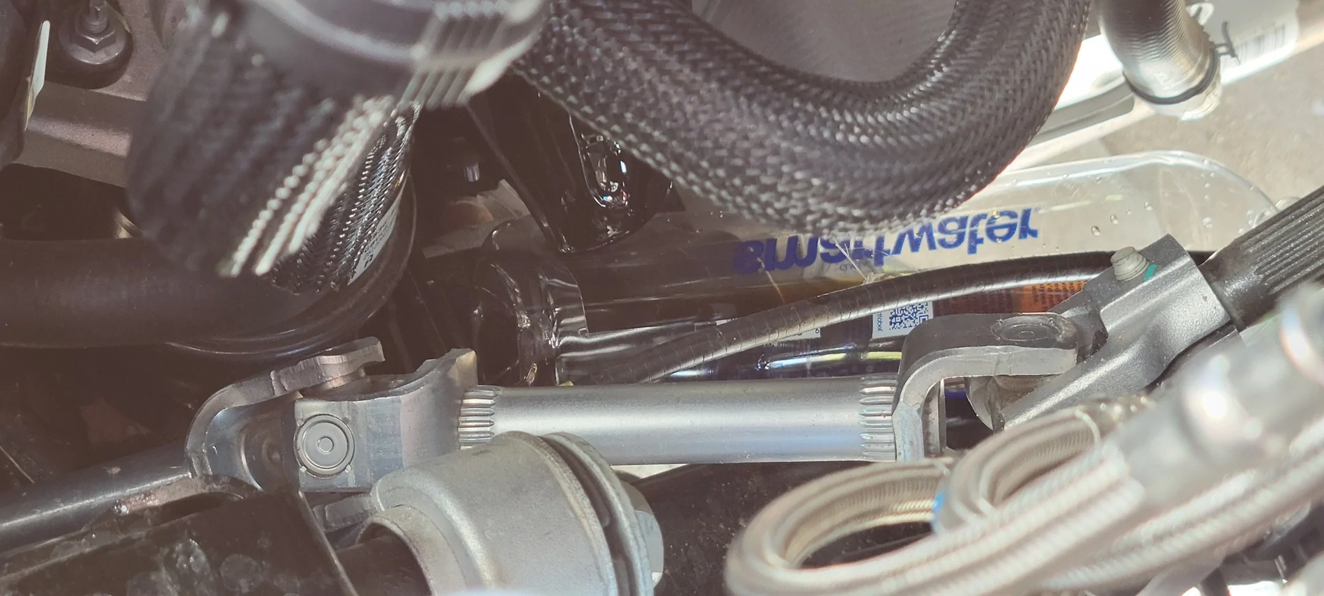

Isn't there supposed to be an oil chute at the oil filter on the 2.3L? My 2026 doesn't have one!
Been driving my new BL a bunch since pickup 9 days ago and already at 700 miles. Thought I would do my due diligence before forgetting and get my break-in oil change in. I've never had a Bronco before, but know there is SUPPOSED to be an oil chute on the 2.3L just behind the driver CV.
Can any new recipients check theirs and verify if it is there or not? I'm also missing my center console lock, so I am already building a list of missing items to get remedied. Knowing if this is a 2026 wide issue or just me would be helpful. Knowing there was a chute, due to all the videos out there, I made my own catch before things got messy.
Ford Bronco 2026 2.3L Oil Chute Missing? [SOLVED] 20260308_151532
Ford Bronco 2026 2.3L Oil Chute Missing? [SOLVED] 20260308_151552

From your pictures, it looks like it’s there. Just the small black plastic piece under the filter.

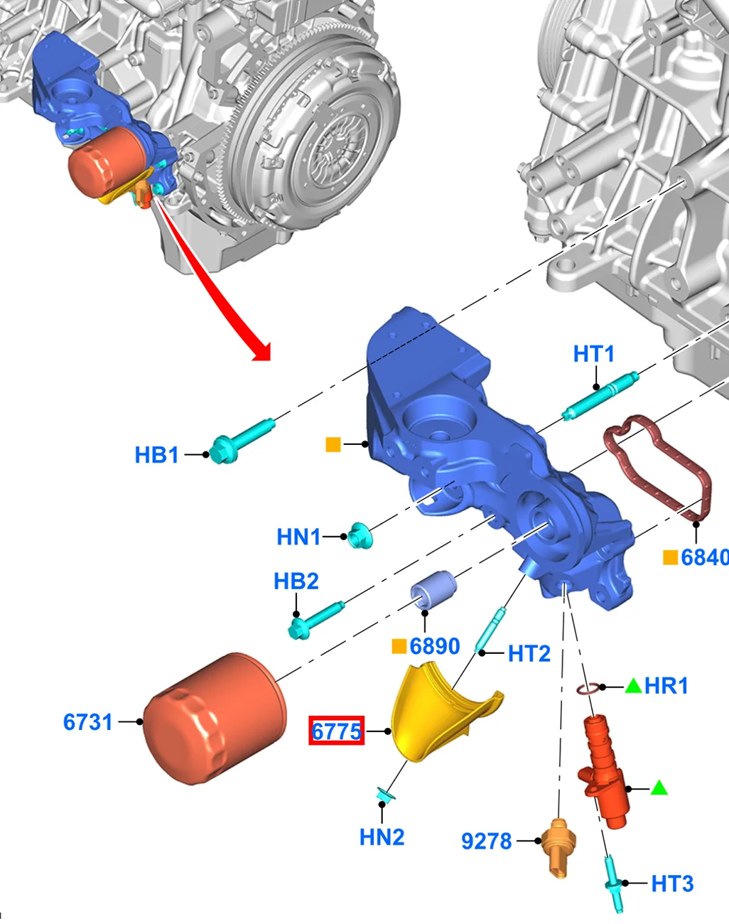

You’re missing this piece:
Ford Bronco 2026 2.3L Oil Chute Missing? [SOLVED] IMG_0127
I think it should still be there for 26MY, I don’t see anything in the parts catalog showing they stopped using it.
Part number is RB3Z-6N634-A

Oh never mind, I see what you’re talking about now.
Thanks! This will help with my dealer.
