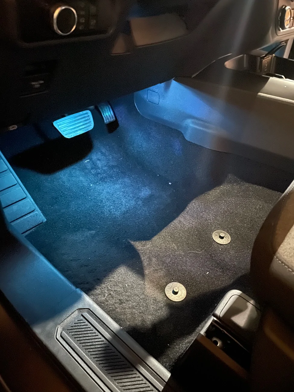

Ford Bronco 2025 base ambient lights IMG_2021
Unsure of build date. But 2025 Base. Lighting in footwell but not in other areas. Setting to change brightness and colors buried in the controls
