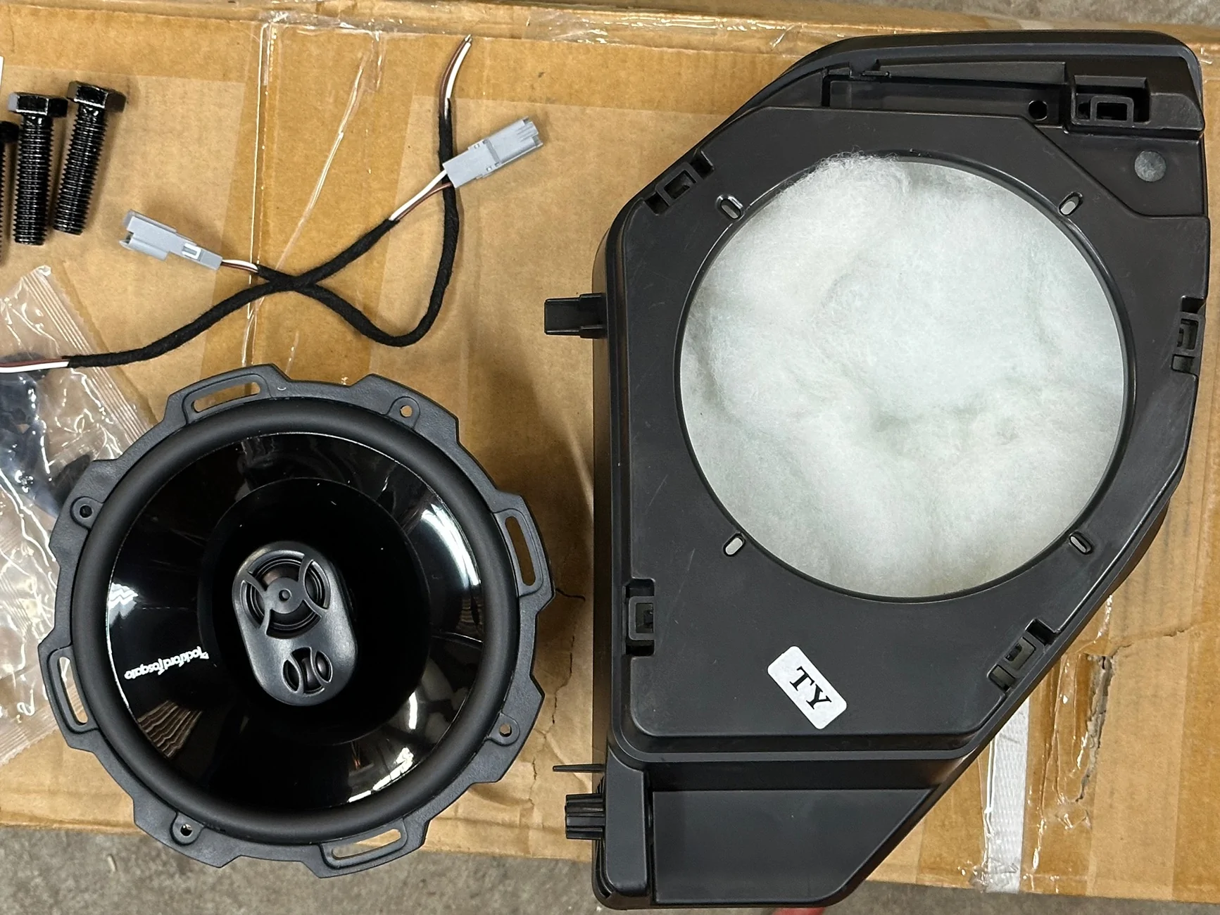

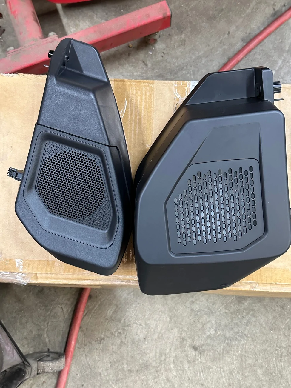

I just changed out all of my speakers with Rockford Fosgates. I also changed the rear pods to new 6.5’s.they are currently all still running on the factory non B&O amp and factory head unit. I just purchased a 12 inch Stinger tailgate mount box and am debating on going with a Mon block just the subs, changing out the factory amp for a new one for the highs and mids and a mono block for the sub, or going with one 5 channel amo for everything. I’m currently waiting for SEMA next week for hopefully some company will unveil a wiring plug and play packet for the 2025’s.🤞
Ford Bronco 2025 B&O… upgrade? IMG_3109
Ford Bronco 2025 B&O… upgrade? IMG_3110

I forgot to also say that I used Forscan after installing all the new speakers and turned off the factory EQ which made everything sound 100% better!
