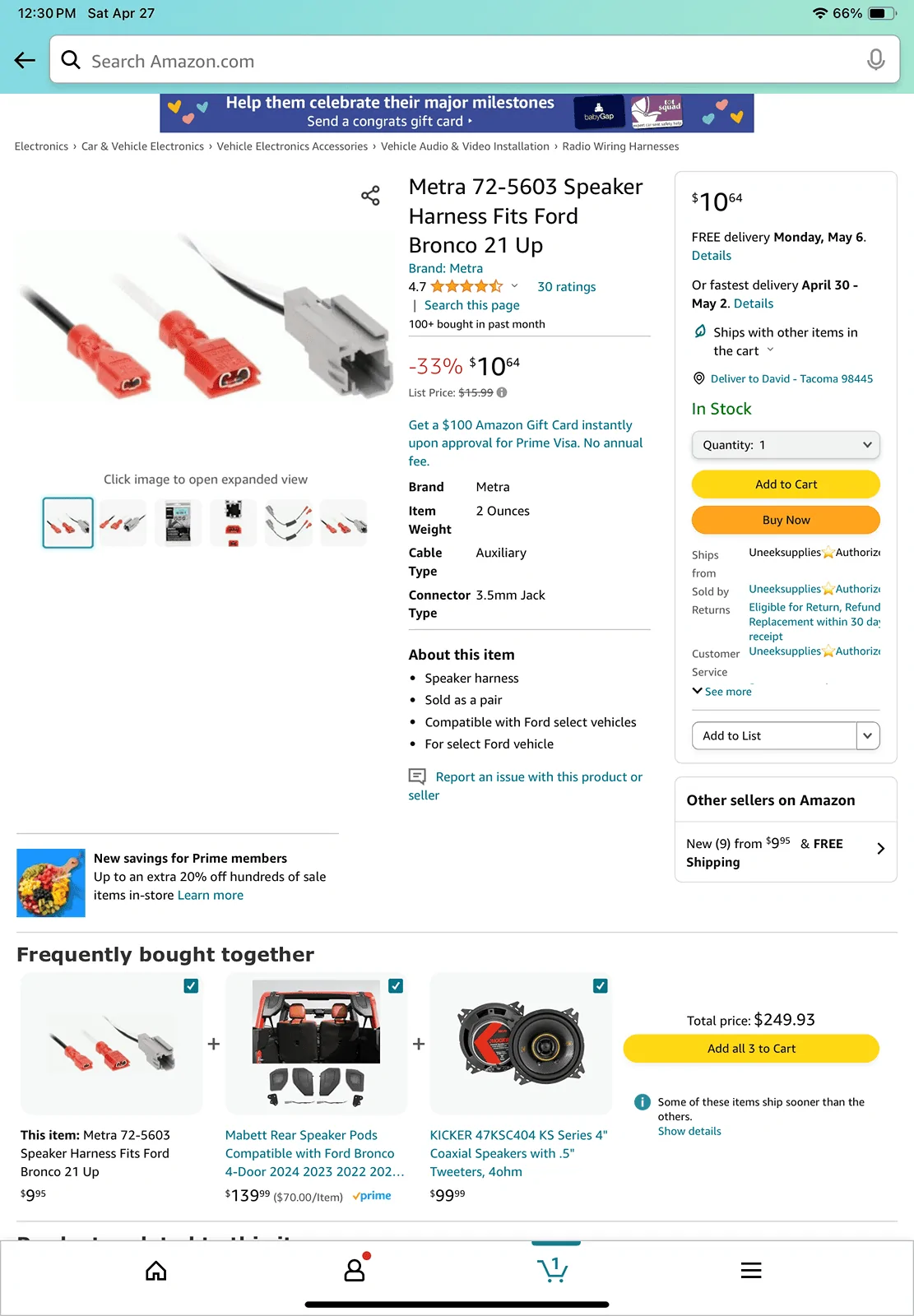

thanks, just want to be sure I have everything needed when I tear it apart. Will these work without any cutting/splicing? Can do butt splicing and heat shrink if you think it would be easier/ more effective. I appreciate your opinion, just want to have as much info as possible

Seconded. Deutsch connectors are awesome ... albeit can be a bit pricey.

I don't see why that wouldn't work for you, but your weak point is the spade connector. If you ever notice static on your speakers, just remember to check that exact connector first - they loosen over time and can hiss/pop. That's true for every spade style connector in history though, not these in particular.
You could go 30 years with it not being a problem - or it could be next week. The good news is it only takes about 15 seconds to pop the plastic off in front of the speakers and fix it. With the money you save over doing DT connectors, you can likely replace this harness adapter ~5-7 times.

The Metra's work fine - I got them included with my speakers from Crutchfield - I went with Infinity Reference 407f in all the 4" locations and Memphis MJP6 in the kick panels, Kicker Comp R 8" mated to a Kicker Key 500.1 for the sub. Couldn't be happier with it now. Even with top and doors off it sounds great. Not quite plug and play on the sub though.
