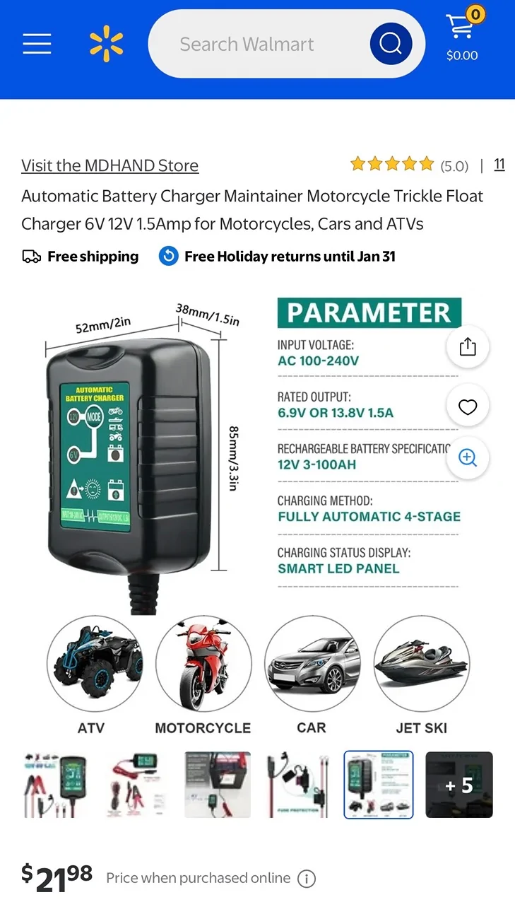

I don’t know for sure what systems run in the background and could be draining power but it’s possible
If you plan on storing it for a long period put one of these on it.
