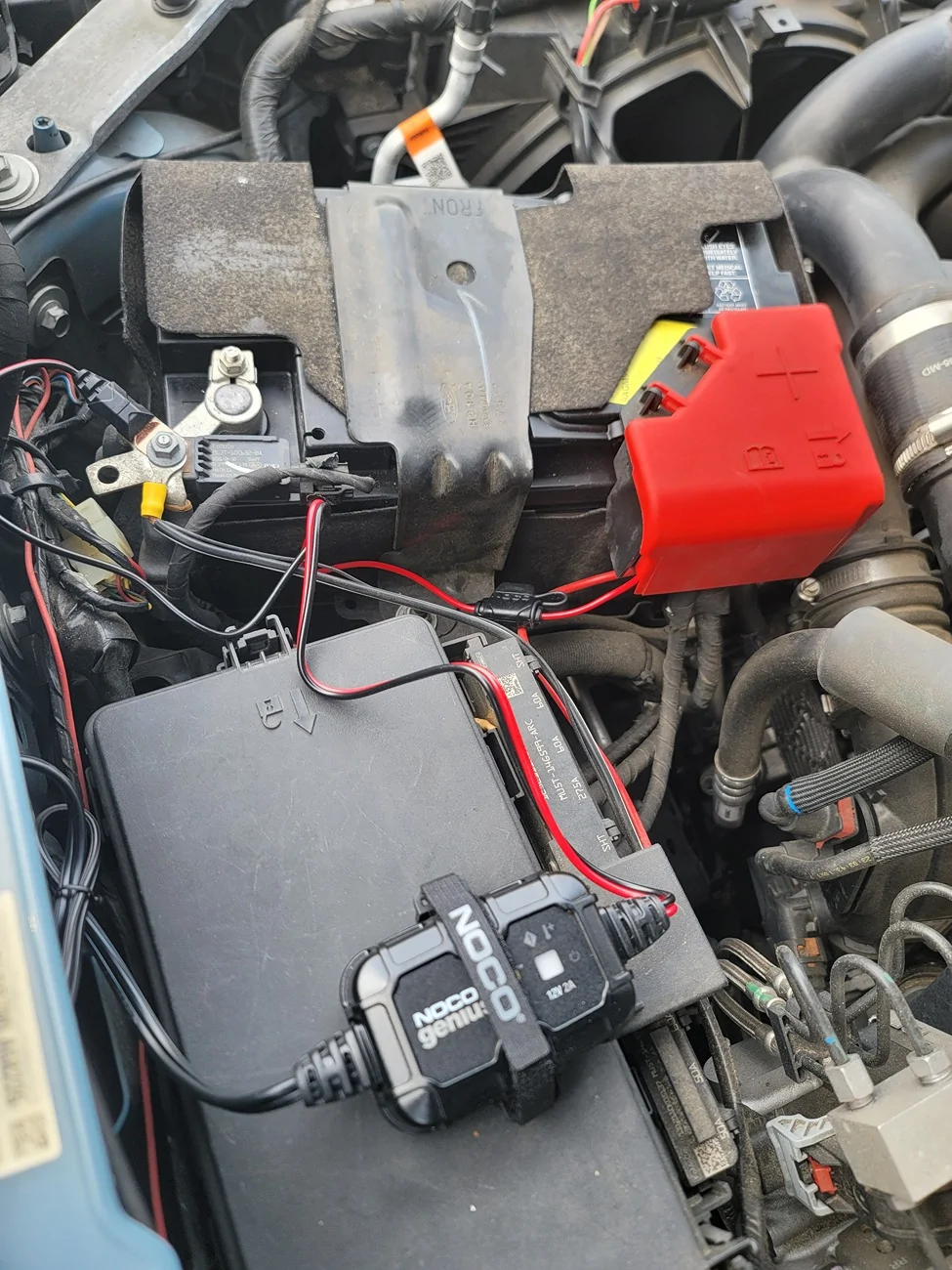

Photo of charger installed, which I might use if I went away for a week.
