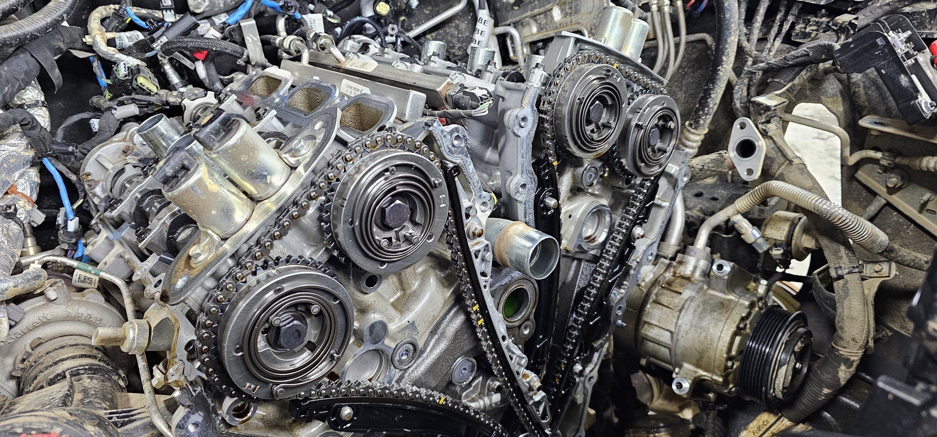

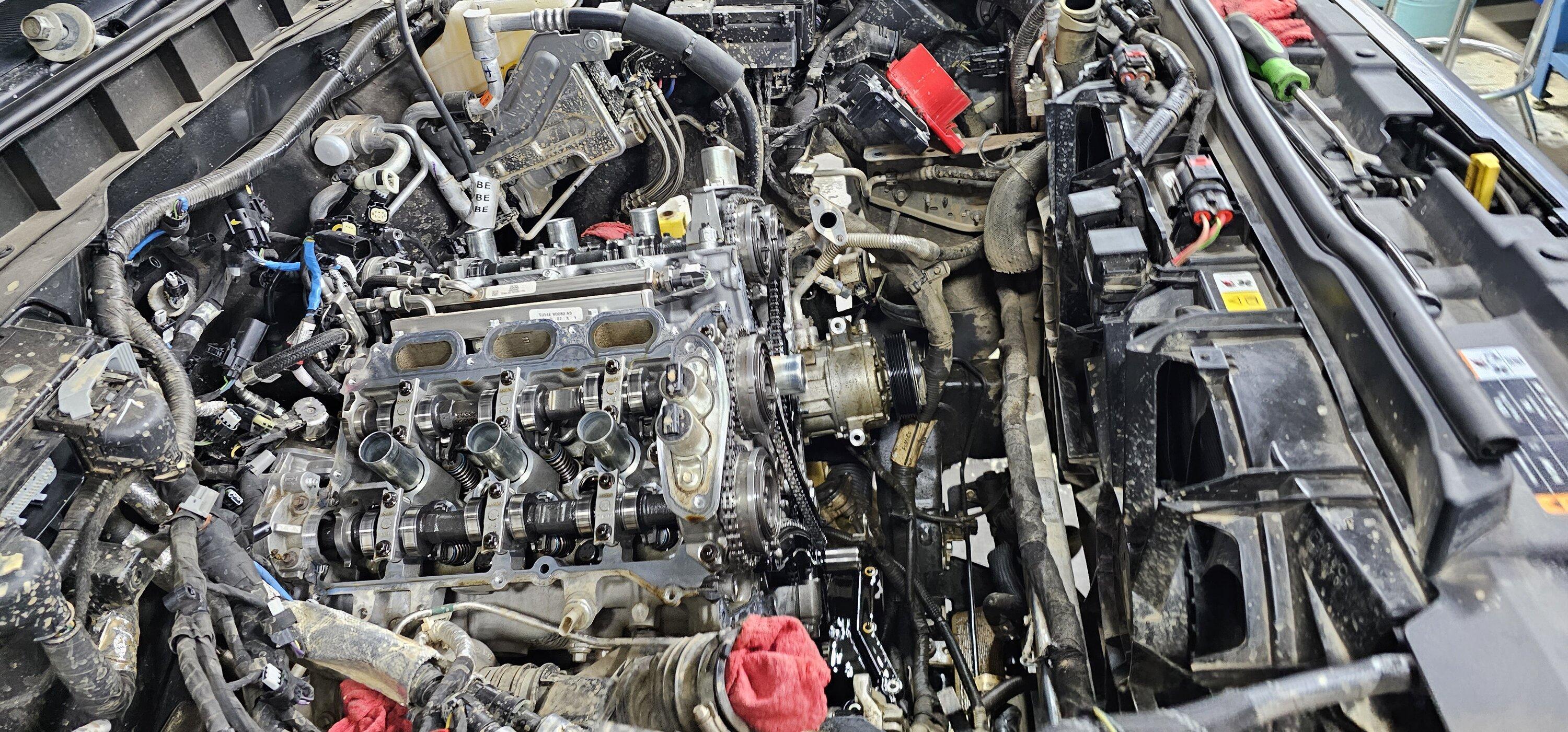

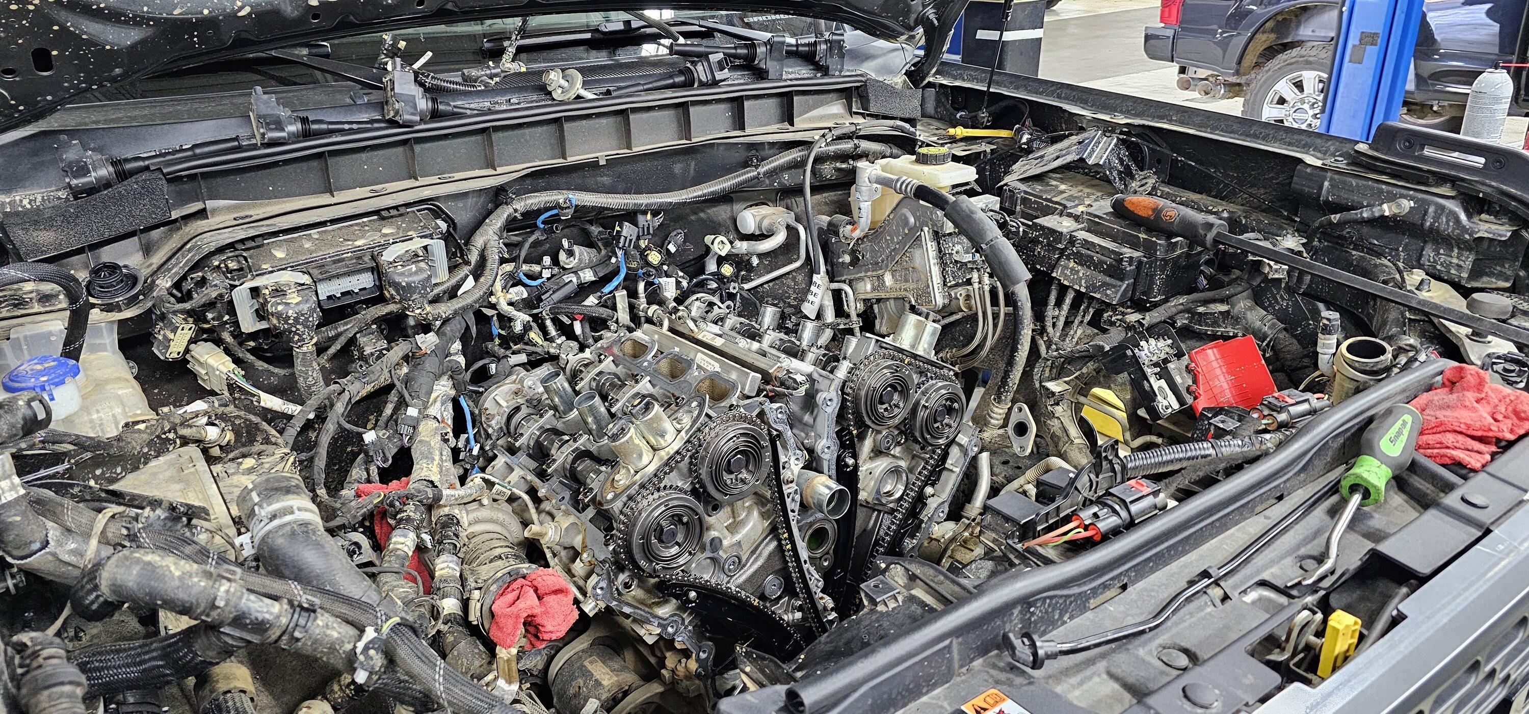

Update for all y'all knuckle heads and wrenchers.
Finally found a dealer worth a shit and they got my rig in right away after the last place strung me along for 6 months.
Stopped in today and talked with the mech doing the work and he let me get some photos of the open block and a good shot of the cam phasers he's changing out.
Happy to answer any questions.

Out of curiosity, what oil and change interval were you running?

He’s doing it the smart way
I did all my oil changes with a certified ford dealer I'll have to look at the receipt to be sure and the truck is at the shop... will update you on that.
First interval was at 2500, second was at 5k, (phaser failed at about 6500) and i did one at 10k right before it went in for service.
Wow, I guess no need to pull the motor out. Mine was done at 5600 miles. Supposedly they did not pull the motor out either. This sucks though so many guys continue to have these phasers fail. So I guess Ford never fixed the problem. So can we expect to have these phasers fail once again after replacing?
It is the same part iteration so the possibility that the cam phaser can fail again is possible. The issue is an engenering design flaw in how oil reaches and lubricates these parts.
