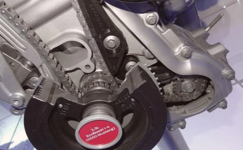

Yeah for sure. The new updated 2.3 in the mustang uses the same style now also. I believe the Ranger was the first 2.3 released to use this type of pump.
I know some Mustang guys swear by deleting to keep the block from windowing on the #3 cylinder. I doubt I'm ever going to do it on the Bronco though. And now we're wayyy off tangent.

Chain driven.
Far better than a timing belt, especially one bathed in oil.
I see enough timing belt failures at work to know I don't want one driving a vehicle oil pump...
Ducati1098
9,976
23,179
Midwest
6 years in since Ford switched to the oil pump belt design and I haven't seen a single failure on any V6 Ecoboosts or the 5.0, so I don't think there is too much to worry about.
The only ones that have had any issues were the 1.0 ecoboosts, and that belt destruction was caused by a poorly designed belt tensioner, not the belt itself. Those are also the only ones that utilize a tensioner for the belt.

@Ducati1098 What is the service life for this belt? Is there a reasonable way to inspect it?
Ducati1098
9,976
23,179
Midwest
I'd have to look it up. Not sure if Ford has an interval for it or not.
No good way of inspecting it really. Probably the "easiest" way is to remove the front cover.
If anyone is having their cam phasers replaced at higher mileage, I'd recommend asking your dealership to take a peek at the belt while they are there.
