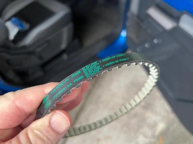

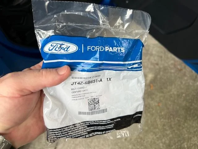

I was able to put my hands on a new Ford oil sump belt. This is the 70k mile belt everyone seems to be worried about with regard to durability and use with nano lubricants to solve the cam phaser issues.
I’ll be watching to see if any issues come up. My cam phasers are still quiet. Next oil change I will drain all the oil and nano stuff and just use a synthetic oil to see how it holds up.

A timing belt driven oil pump. Genius.
How is the pump driven on the 2.3??? Directly by the crank, as it should be?

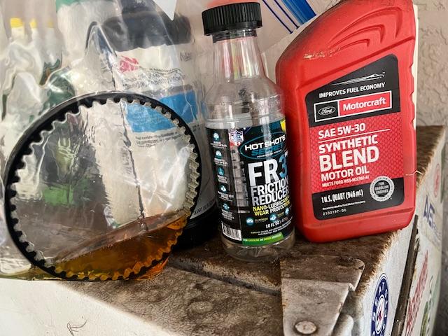

Are you willing to soak that belt in a pan of the FR3 for a few weeks? Then report back in February?
If it does not degrade in pure FR3 then it will probably hold up in a very diluted mix with engine oil.
At least this seems like it would test it.

I put roughly a 50% mix. I’m also going to add some blow by out of the catch can and cycle it up to 185 degrees. The only thing I can’t simulate is belt tension. That said, it should still be an interesting test.

That does sound like a good test. At least if the magic juice is eating the belt it should show up.
