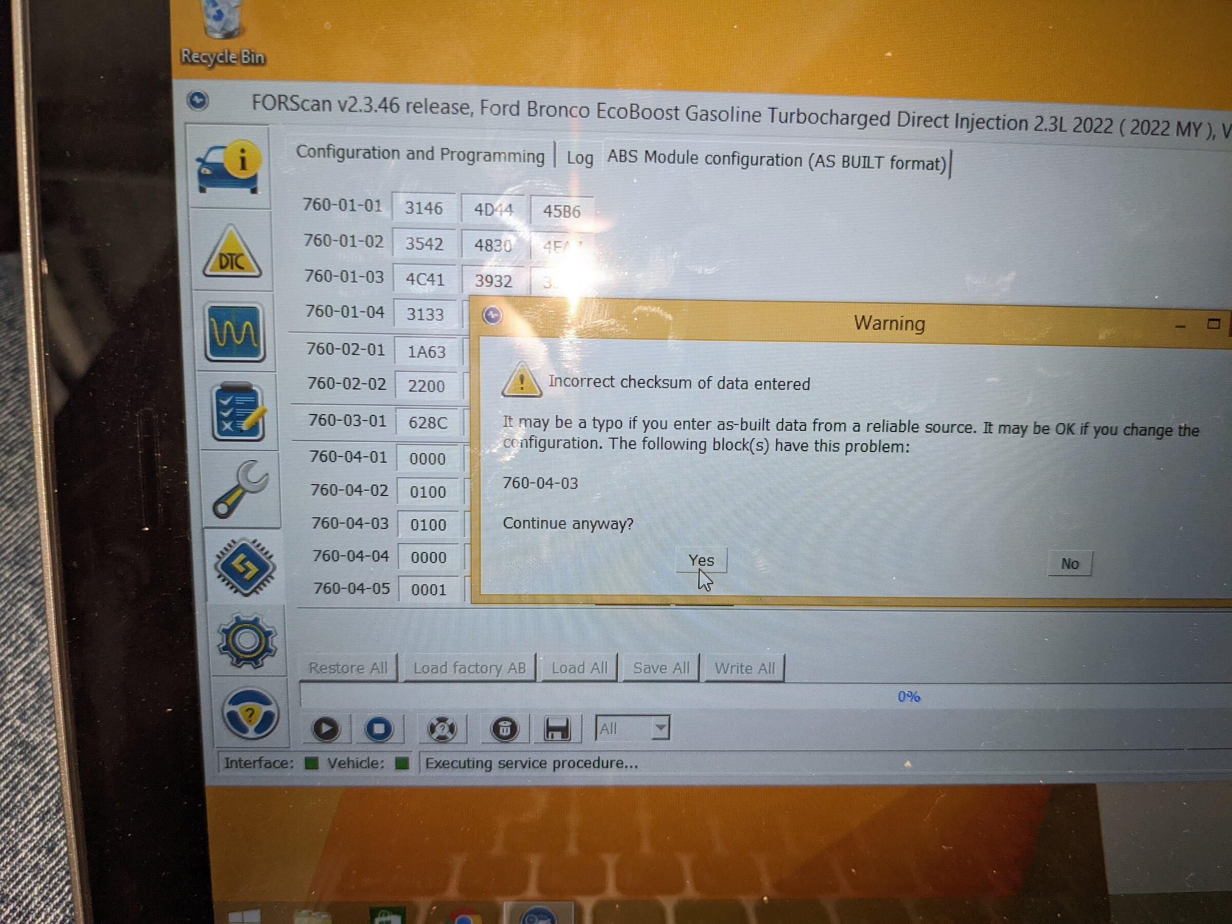

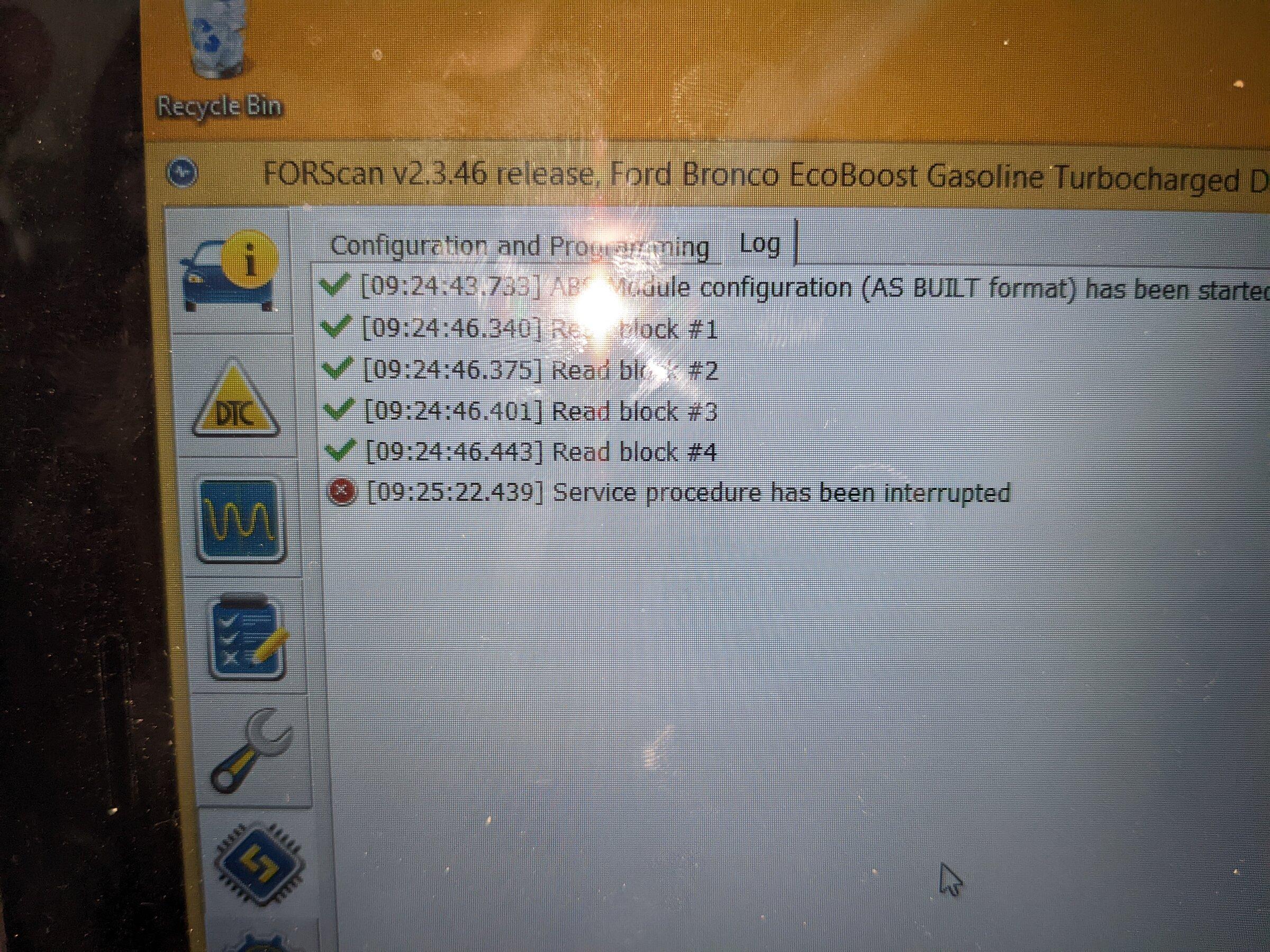

Still can't add Goat modes, please see errors. Pretty sure it's a conflict with not having a locker.
The checksum error is completely normal and you can just hit yes safely. ForScan automatically applies the correct checksum value.
The service procedure has been interrupted could be one of two things. You’re not on the latest ForScan version (I believe it’s still the new beta you need) or you need to re-load your vehicle as a new vehicle profile when you first connect.
It could be a combination of both causing the issues. This error was very prominent on 2022 models until you used the beta
Regardless of lockers the ABS module will accept the codes otherwise. I believe there’s been many people here who have added various modes successfully without lockers.

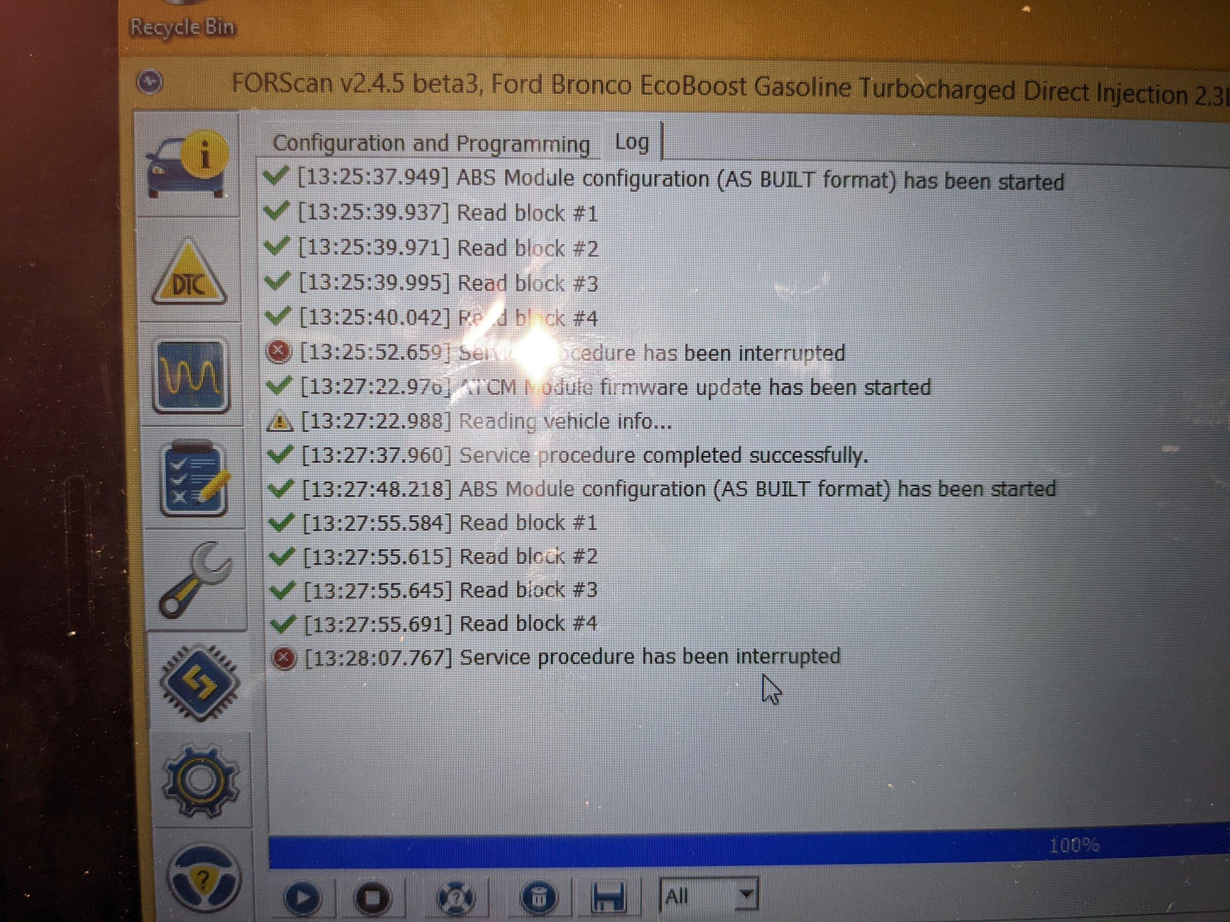

Loaded beta and new vehicle profile. Still faulting when try to write over.
Could be an issue with your programmer but I am in no way an expert on this stuff so you may be better to go to the ForScan forum and ask for help there.
