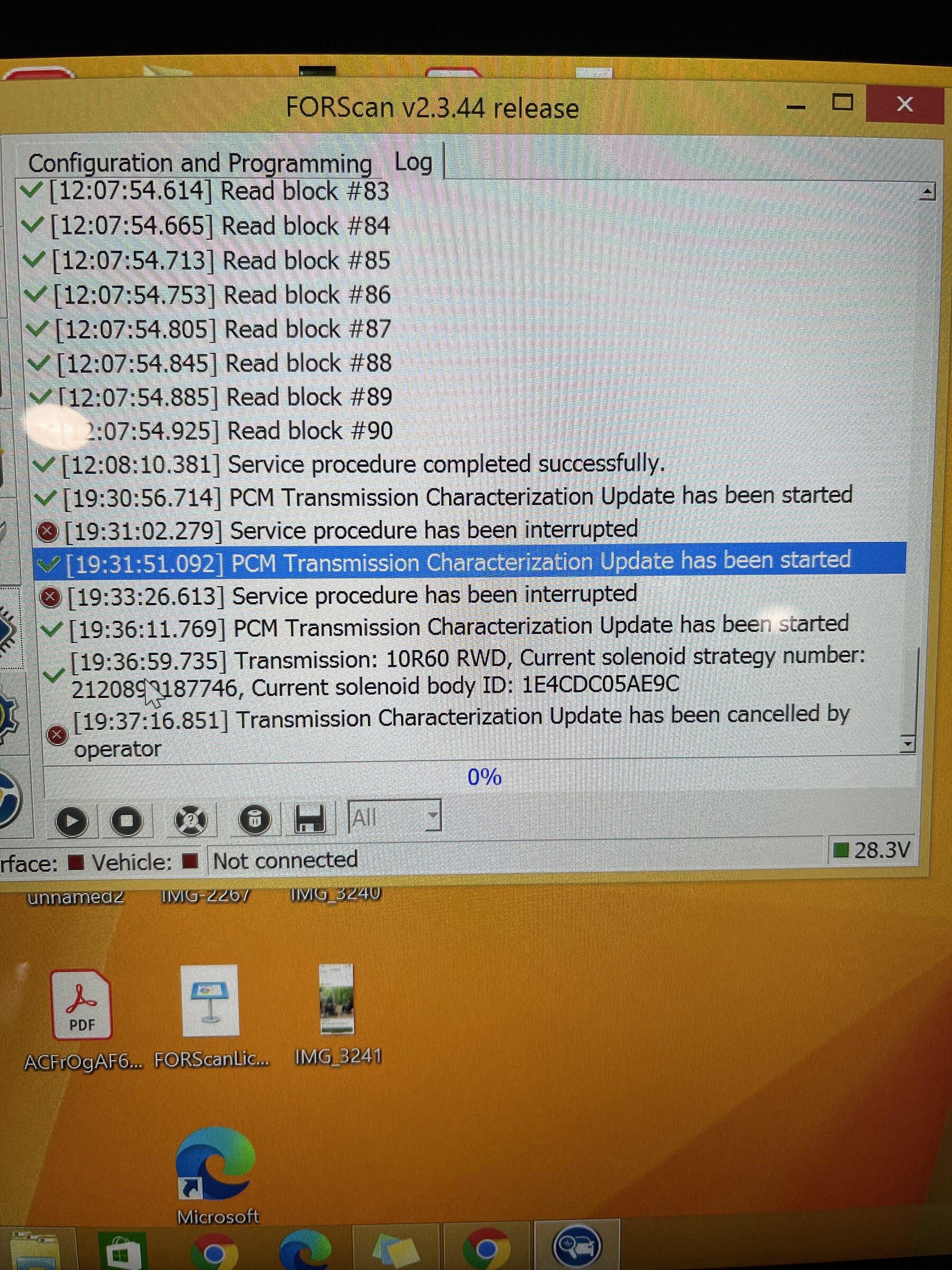

This may have been asked. I have a question regarding forscan and enabling baja mode. I plug in the adaptor follow all the instructions everything is linked properly. I go to configuration and programming and it won't recognize the transmission (10R60) I select that and I get a couple boxes to confirm that's the right one (see pic) and that's where I stopped because that differs from everyone else. Do I just need to confirm and keep going? Most yt vids they didn't have to go through this step. Tia
