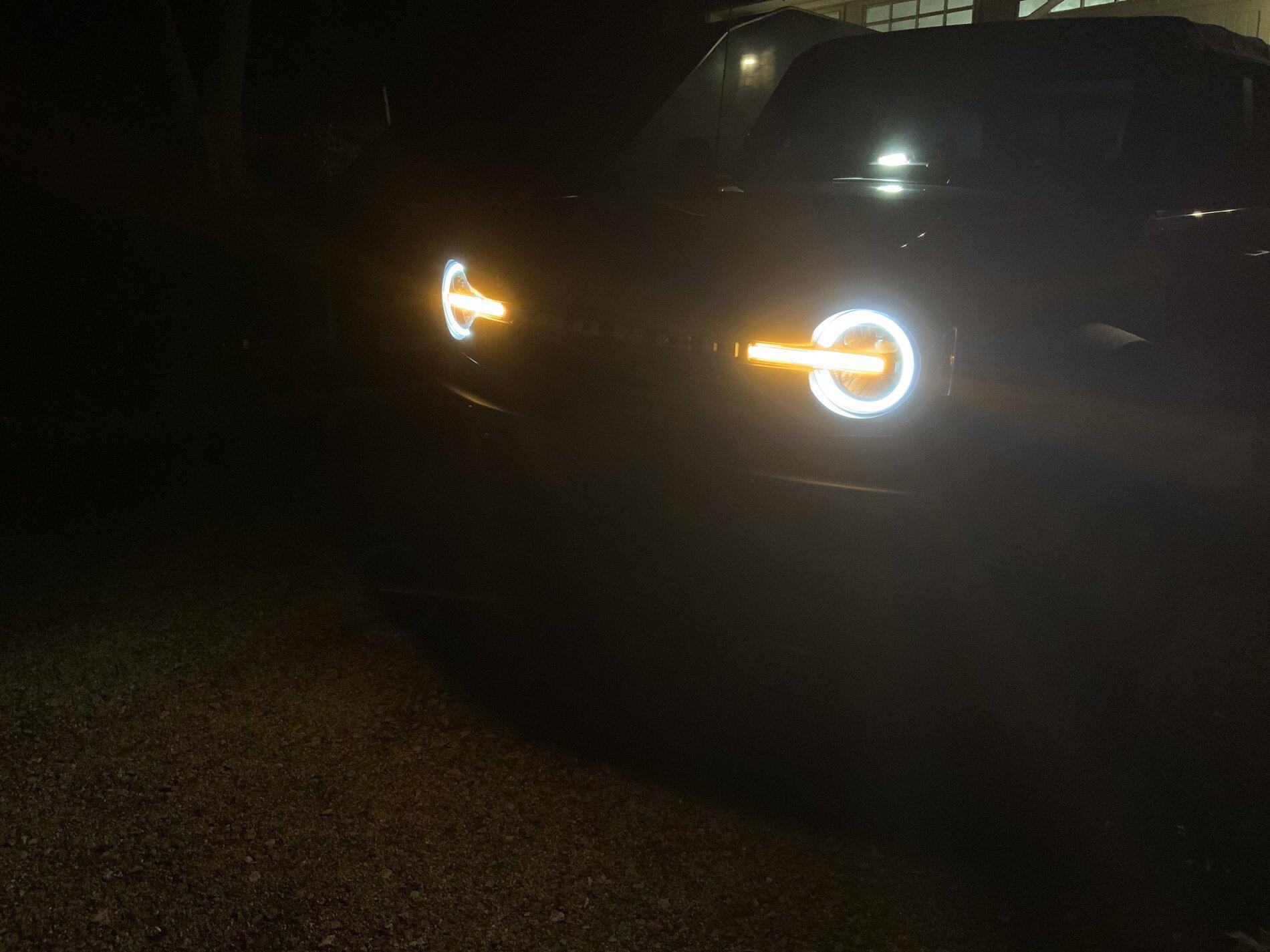

Any luck enabling amber parking lights as DRLs?
Sorry if it has been posted, the thread is getting long

I was able to replicate the amber post as DRL setting tonight. I did it in the IPC module (the easy to navigate one) and changed the Left Turn Signal to “Turn and DRL” from “Turn”. I did the same with the right. In the photo I have the wheels chocked, the parking brake on, a flashlight tricking the DRL sensor on the dash and you can see the amber bars.
I still can’t get the damn doo-doo-doo chime to stop. I tried it in both the IPC and the IPC as-built and no luck. I even tried F-150 settings and no luck.
What do the lights do at night?
I'm looking as well. The one option someone posted worked as DLR but they were always on. And it disabled the use as a turn signal. Anyways after much messing...
