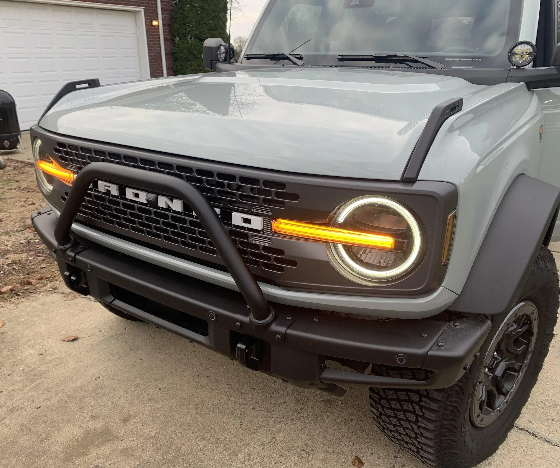

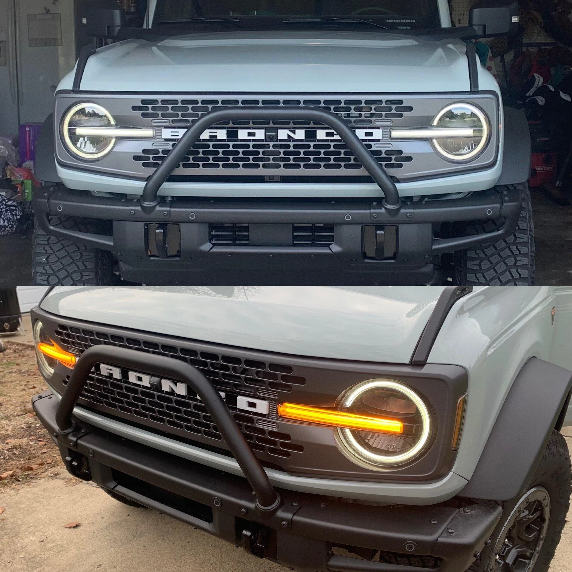

I did some research earlier about it though and I actually might not think this is possible. What I was thinking of was "parking lights as DRL" however our parking lights are white. I haven't seen any proven settings that would allow you to use the turn signal itself as DRL though I do see this option. I'm wondering if 01 would be the change needed. I know I said I was going to try this out but I got lost in other things. No promises but I'll try to give it a shot soon.
I quickly referenced mine, a First Edition and a BaseSquatch and they all have 02 as the default setting.
726-43-01**xxxxxxxx--LF_Turn_Lamp_Ckt_Usage_Cfg: 00=Not Used 01=Turn DRL 02=Turn Only 03=Turn Position 04=Turn Position DRL
726-43-01xx**xxxxxx--RF_Turn_Lamp_Ckt_Usage_Cfg: 00=Not Used 01=Turn DRL 02=Turn Only 03=Turn Position 04=Turn Position DRL
I tried doing this and it didn’t seem to change anything. Then again it’s night time so I can’t really test the DRL’s. Guess we will see tomorrow.
One last thing, while I was in there I enabled remote close windows. Could be a handy feature if someone leaves a window down as I walk away from the car. But I tried adding it to the sync4 menu like the note said by changing to the letter “E” and nothing changed. I already had the option for remote open in vehicle settings. I figured this would add a toggle for remote close. Am I wrong or did I miss something?

Well it worked. Kind of. The ring is still on around the lights, but I changed the center bar from white to amber. I prefer the stock look better so I’m going to change back, but if you can figure out how to deactivate the circular DRL this is the look people are wanting.

Before/after. Definitely like it all white.

I think it looks great!
Hard to tell from the pics, but is the amber bar half bright or full bright?
(Does it even have a half bright setting…?)
