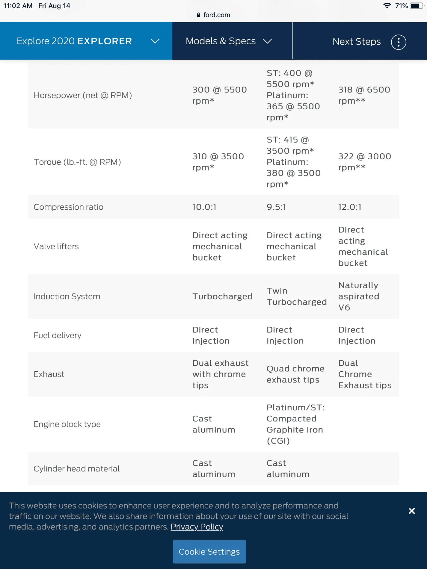

It took me four attempts before I succeded in changing this completly wrong information at Wikipedia.
It´s CGI in both Nanos.
The lower part of the block is in aluminium but the main parts with higher loads are CGI
https://www.chastangford.com/static/dealer-18817/pdf/Specs-Houston-TX.pdf
from
https://www.sintercast.com/market/sintercast-passenger-vehicles/
You are correct even per ford the 3.0 is CGI (only direct injection though)
https://www.ford.com/suvs/explorer/models/explorer-st/

Felix808
55
4,902
10,469
SRV CA
Just proving that Wiki anything is complete
Ford Bronco 2.7L CAST IRON BLOCK - WHY? bull
People can write anything true or false but mostly false, but sheeple will believe because they saw it on the internet.
thanks for correcting it. ?

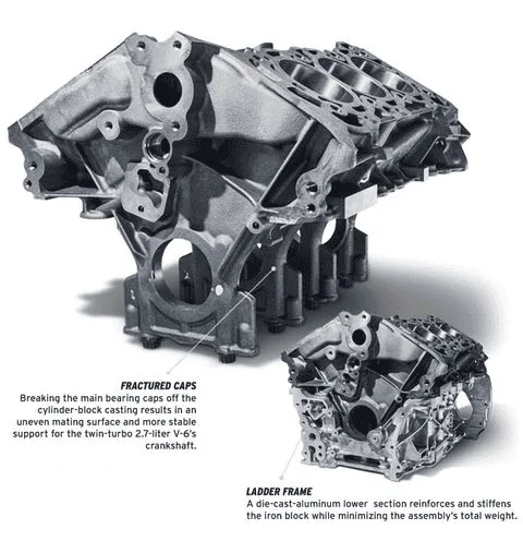

My concern for the 2.7 is how much plastic is used in the engine package. The plastic oil pan is my main issue. Also does anyone know how many main journals bearings is holding the crank down
Mechanic here - plastic oil pans are amazing. Unless there's an error in the mold you really don't have to worry about them unless you plan on dropping the engine on a rock. Regardless of pan in that situation though, you're going to be losing your oil. That's why there's skid plates.
It's a V6... there's four. It's also REALLY cool how they attach. They're fracture-split, the same way you're starting to see new connecting rods. The block gets cast with the main journals as one piece, then they laser-etch where the bearing cap and block are going to be split. They use a special machine to essentially break off the caps from the block. This is an extremely strong setup. What once took six studs to secure a main cap to a block now only takes two bolts, while still being stronger. The big downside is that if you mess up either the block's or the main cap's mating surface, then you need a new block.
Paccar has been using CGI blocks for over a decade now with the MX-13, and even longer in Europe where the engine originated. IMO they have the toughest long block in the industry. The technology is beyond proven and very strong. So much so that all of the next-gen Cummins engines that will based on their modular platforms (like the upcoming X12) are going to be CGI blocks. It's so much stronger and much, much lighter than traditional iron since you don't need as much material.
Main caps:
