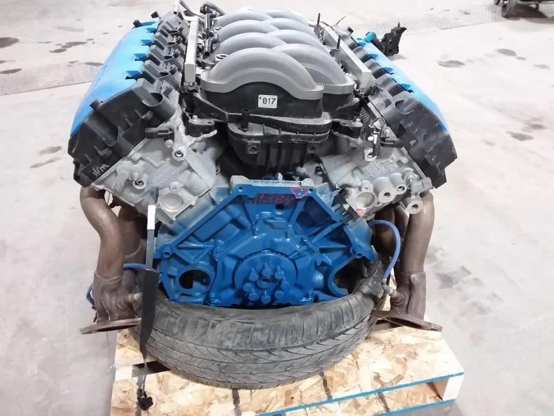

- Modular (Coyote, 7.3 Godzilla, VooDoo, Predator, V10, 6.2) - note the squared-off top similar to the older SBF pattern

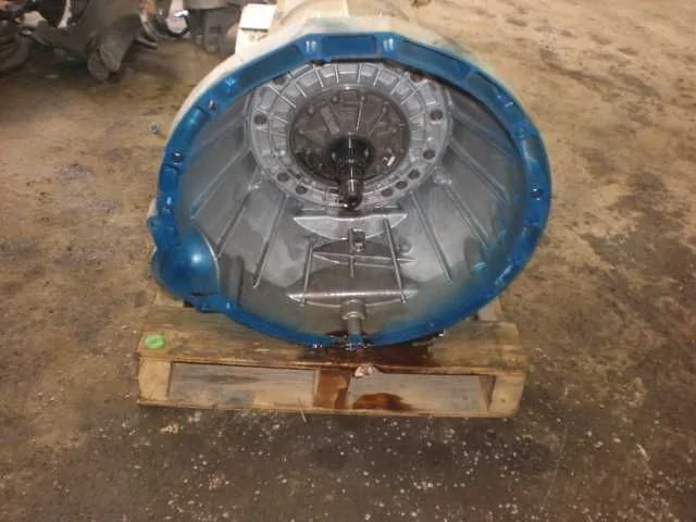

- V6 (3.3 NA, 3.5 NA, 3.7 NA, EcoBoost V6s) - note the more round profile. I'm 99% sure this is the same on transverse and longitudinal applications
Ford Bronco 2.7L CAST IRON BLOCK - WHY? f150 at

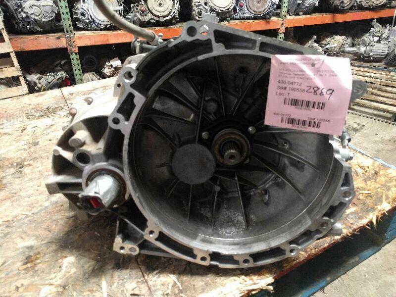

- Duratec (2.0/2.3 NA and EcoBoost, same as Mazda 4cyl - you can use a Miata trans to make an EcoBoost engine RWD)
Ford Bronco 2.7L CAST IRON BLOCK - WHY? focus-5s

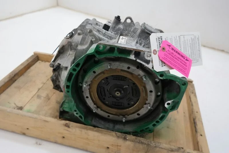

- Sigma (1.5/1.6 EcoBoost)
Ford Bronco 2.7L CAST IRON BLOCK - WHY? fiesta-trans
