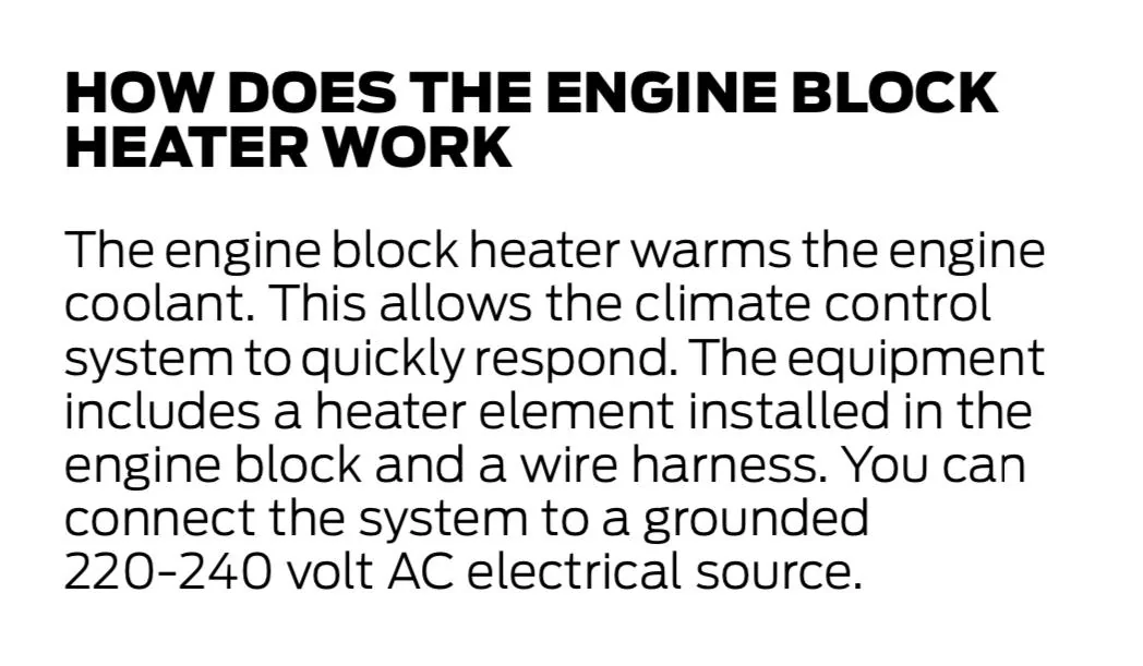

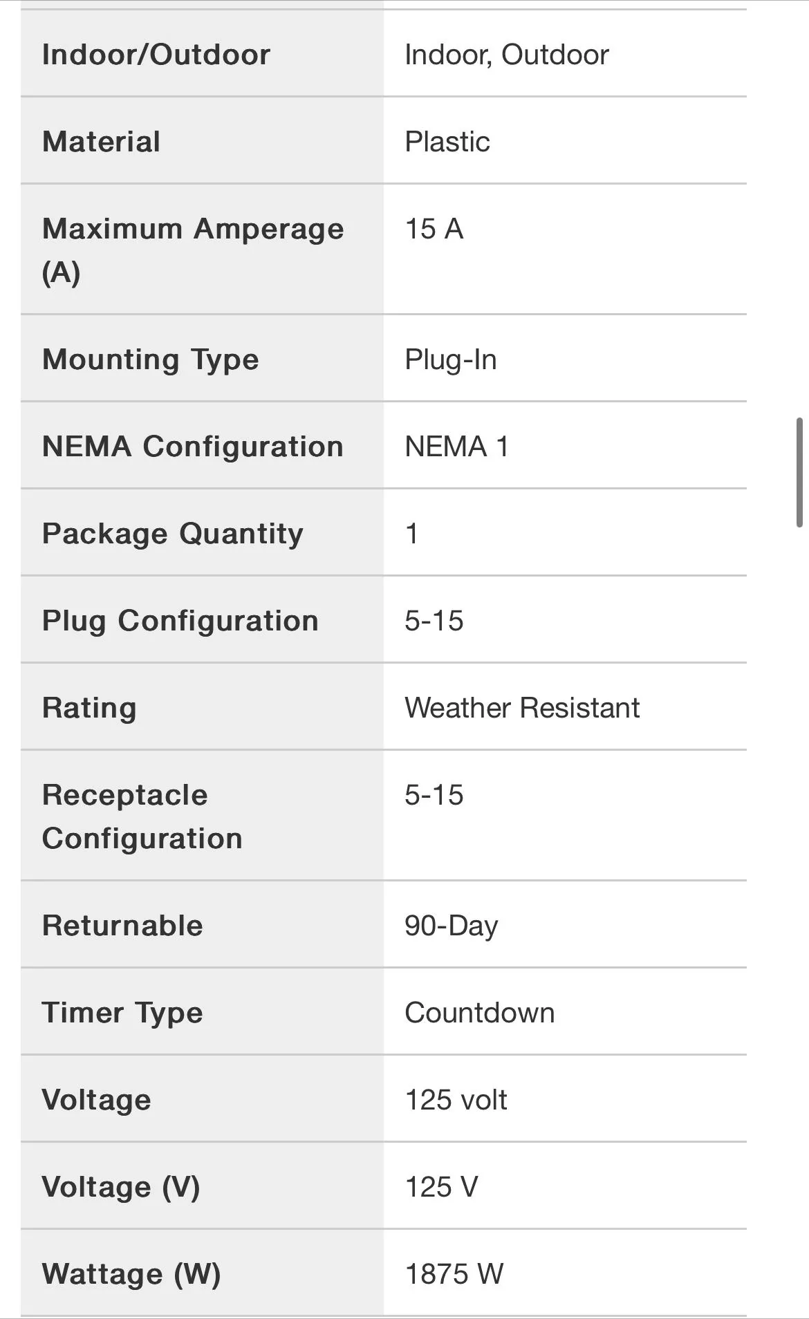

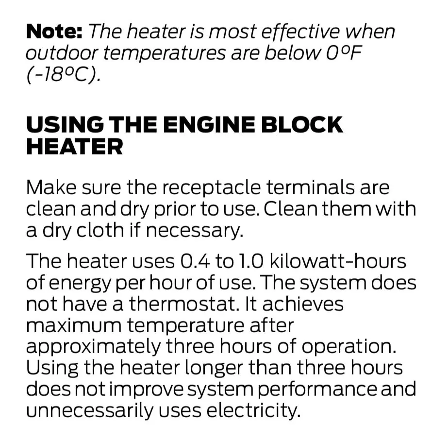

So, I just realized that the user manual states that it requires 220v and optimal temps are reached after 3 hours.
I guess my search for a different timer is required because the one I got isn’t rated for 220-240v nor is the outlet I’m using. So, I guess I need a dedicated outlet, timer and outdoor extension cord.
I agree that the coolant should be 100°F+ in those ambient temps. Oil + coolant hitting 50-60°F after a few miles has been normal operation without the heater. I’m expecting to be able to turn the heater on and immediately be at near operating temps pulling out of the driveway.
