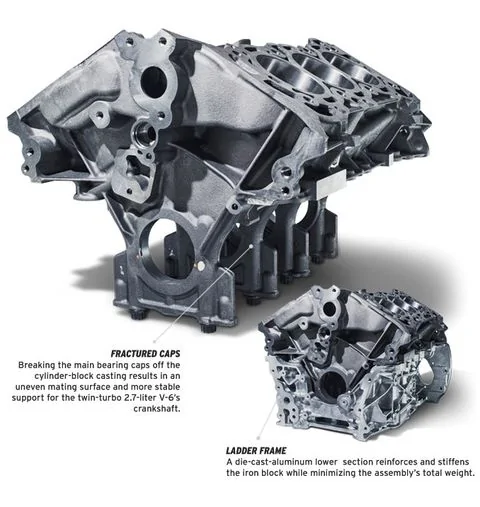

I've been really curious, and maybe some of you experts know's the answer... why is the 2.7L TTV6 the _only_ ecoboost engine with a cast iron block?
The 3.5TTV6 is aluminum, and the 2.3T4 is aluminum... why the odd construction for the 2.7?
TIA
CGI.. it's an Iron Graphite composite ..almost as light as aluminum but stronger

The 2.7 is not cast iron. It's CGI (compacted graphite iron). It's tougher and lighter than cast. The 2.7 was engineered from the very start to be turbocharged and be able to have extreme durability.

It's a V6... there's four. It's also REALLY cool how they attach. They're fracture-split, the same way you're starting to see new connecting rods. The block gets cast with the main journals as one piece, then they laser-etch where the bearing cap and block are going to be split. They use a special machine to essentially break off the caps from the block. This is an extremely strong setup. What once took six studs to secure a main cap to a block now only takes two bolts, while still being stronger. The big downside is that if you mess up either the block's or the main cap's mating surface, then you need a new block.
Paccar has been using CGI blocks for over a decade now with the MX-13, and even longer in Europe where the engine originated. IMO they have the toughest long block in the industry. The technology is beyond proven and very strong. So much so that all of the next-gen Cummins engines that will based on their modular platforms (like the upcoming X12) are going to be CGI blocks. It's so much stronger and much, much lighter than traditional iron since you don't need as much material.
Main caps:
Maiting point of a con-rod (notice how you can't see it since it was originally made as a single unit then fracture-split)
Main caps:
Thank you for your insight!!!!!! I actually had to do a little bit of research because I thought it was an aluminum block that was going to be sprayed with CGI. Now that i know it will be a whole casted block I am blown away this is the stuff, I am nerding out over the potential this will bring to the platform itself
Now for the bottom end I was worried they would have skimped out. This would be very ideal way to increase strength of the con- rods, as the performance after market has con rods like this.
dare i say 500-600ft*lbs might not look like a stretch on stock engine platform
