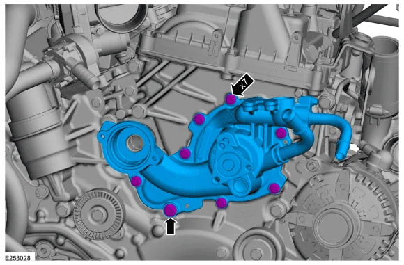

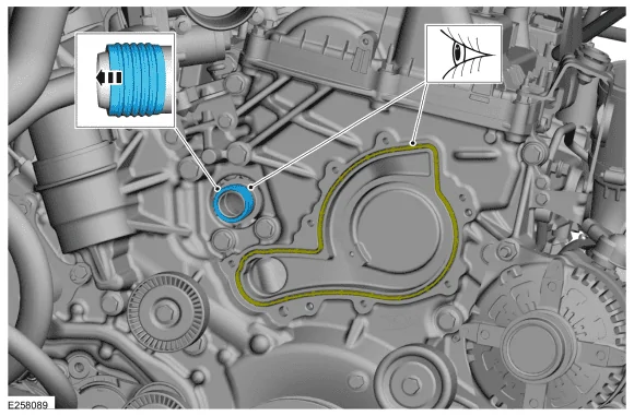

I just hope the new 2.7 ecoboost don’t have that internal water pump like fords 3.5 V6 have
This got me curious, so I looked up a '19 F150 with the 2.7 via Identifix and from what I'm seeing there, it doesn't appear to have a timing driven water pump (That's what I'm assuming you mean by 'internal water pump'). Looks like a traditional bolt on assembly, but who knows! Maybe something has changed. Or maybe I'm just ignorant of a completely newer version of the 2.7, I'm not above being corrected.
