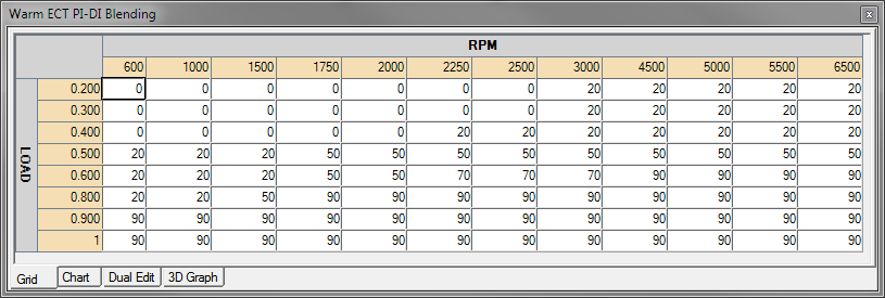

The 2.7L will have "port", and "direct" injection. So, a catch can really isn't needed unless you want one.

The vehicles that benefit from a catch can have higher performance engines that significantly increase crankcase pressures by causing more cylinder blow-by and are direct injected. The 2.7 is not one of those engines and in addition, has port injection in addition to direct which washes the intake channel and valve where carbon could build up.
So, there is no necessity to add a catch can to the 2.7. I know the 2.3 in the Ranger has a built-in air/oil separator that accomplishes most of what a catch can could. I don’t know if the 2.7 also has one.
