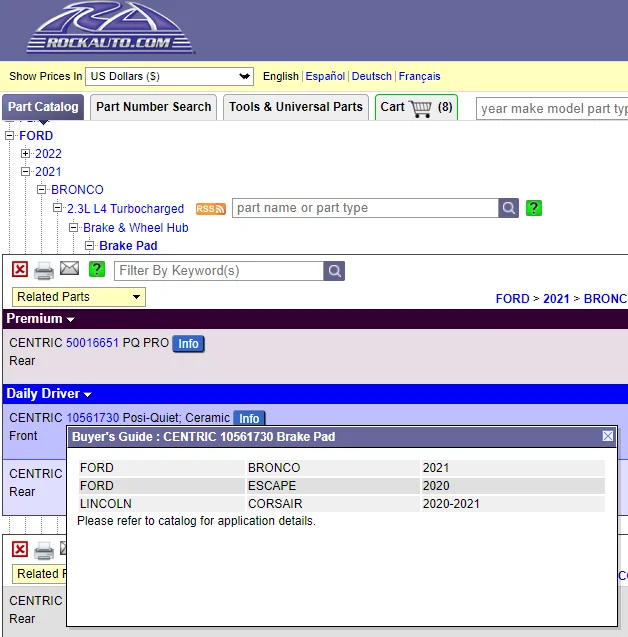

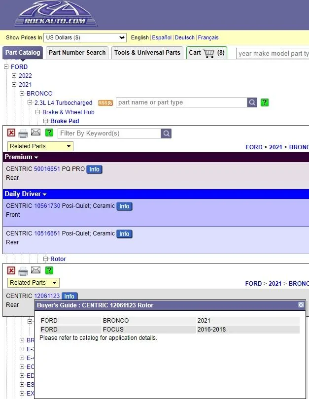

I was browsing RockAuto today and noticed 2021 Bronco on there. Not sure if this is correct, but Bronco uses the same rear brake rotors as a 2016-2018 Focus and the same brake pads as a Ford Escape?
Ford Bronco Recommended Oils, Fluids, Coolants, Filters, Components for 2021 Ford Bronco BRONCO BRAKES
Ford Bronco Recommended Oils, Fluids, Coolants, Filters, Components for 2021 Ford Bronco BRONCO BRAKES 2
