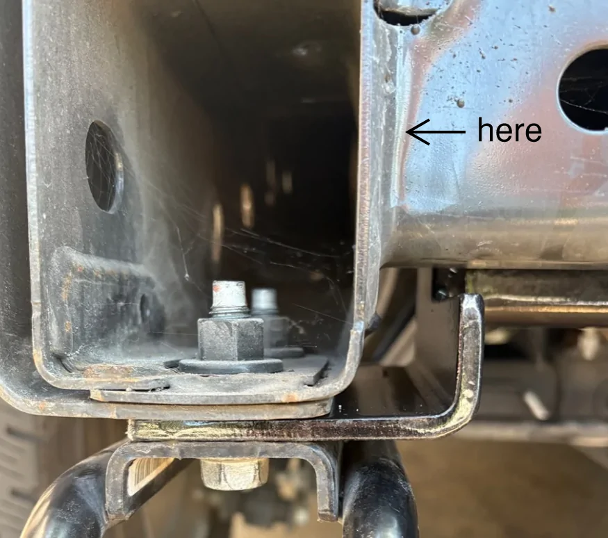

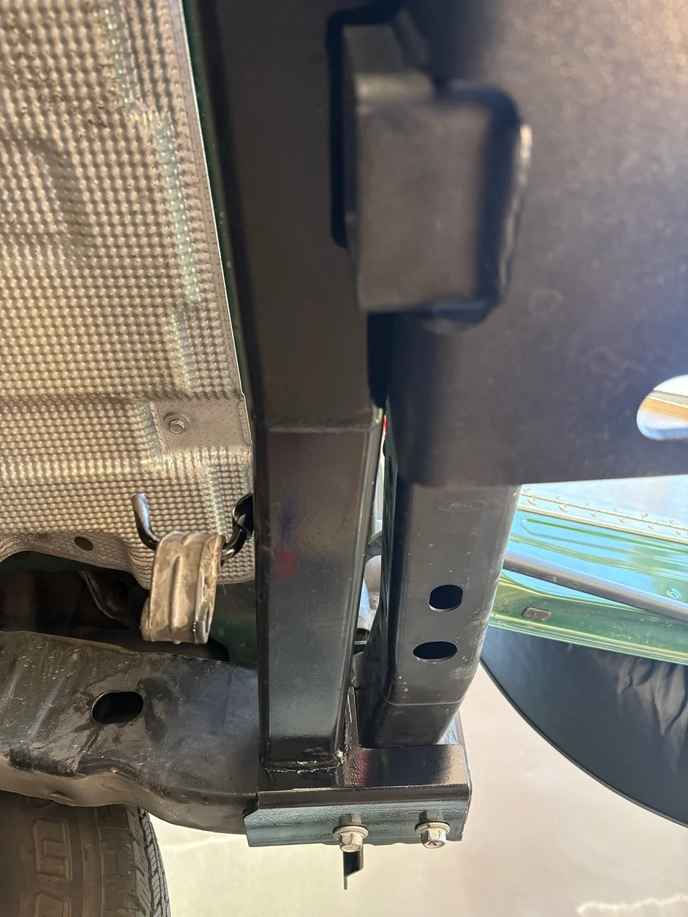

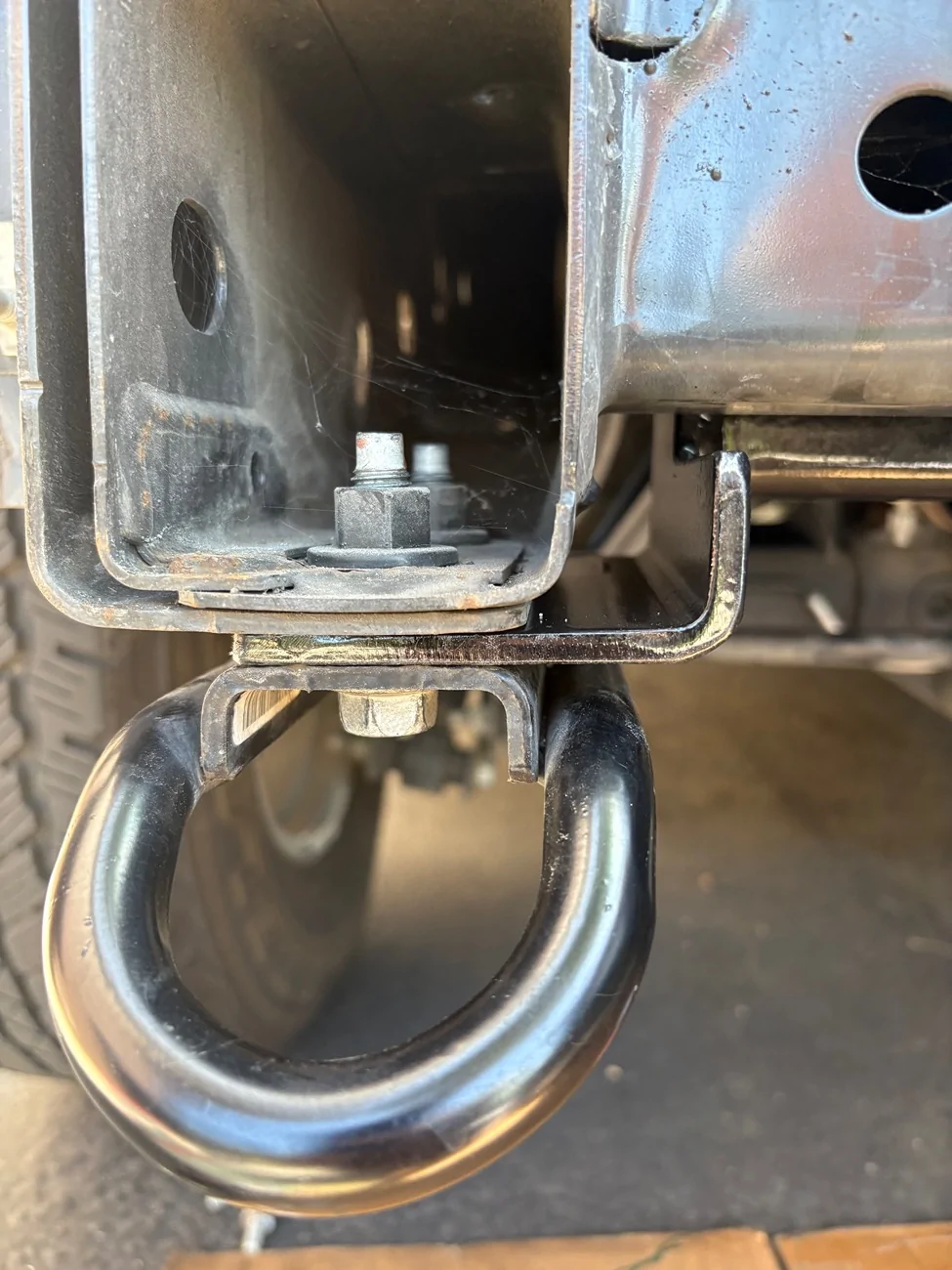

OEM tongue weight is 350 lbs and I want to carry my exc-f on the hitch and since the load would be farther I doubled the rear frame to beef up the hitch tongue capacity.
Super tedious work and had to modify the muffler location to make space for a second cross frame.
Ford Bronco Doubled rear cross frame to increase hitch tongue weight. OEM frame is 1/8” thin! IMG_0225
Ford Bronco Doubled rear cross frame to increase hitch tongue weight. OEM frame is 1/8” thin! IMG_0222

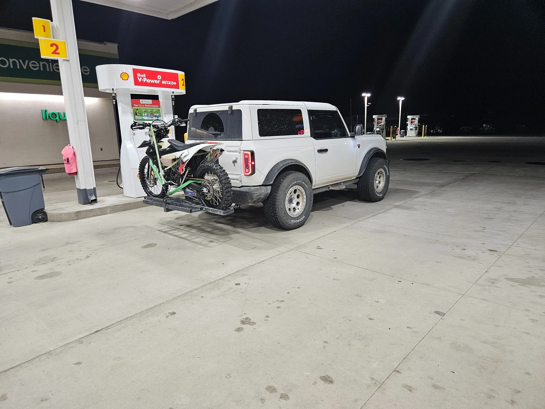

I've not had any issues bith a bike carrier, but I respect the belt and suspenders approach. Hauled this bike 7hr without issue or any signs of structural issue.
Ford Bronco Doubled rear cross frame to increase hitch tongue weight. OEM frame is 1/8” thin! 20260517_013543
Does your setup tie the new crossmsmber to the hitch at all or is it just tying the fram rails together?
Nice work, can't tell from the pictures exactly what's going on.But I would definitely tie those two together directly.At the hitch.

No signs of deflection or fatigue. Minimal concern and I'd do it again without hesitation.
Handling is fine. Little more sway and the headlights were high terrorizing traffic, but I'm not expecting sportscar handling or one-ton dually carrying capacity.
I'm not sure since mine's removed, but the spare tire might give you grief. Not much room between bike and tailgate, at least on my carrier.
The new cross member is 2.5x2.5x.25" tube steel and is bolted to the back of the hitch with the four 1/2" bolts. Contact area is 9.75"x 2" with bolts torqued tight.
Welding the new tube steel to the hitch would be next level for strength but the end brackets, which you can see, are as strong as I could practically design, and out of the entire system, they are the weak points. So, welding my new tube steel to the hitch wouldn't make the whole thing any better.
I would not weld anything to the bronco frame. If it was old, I might but not now.

Nice quick back of the envelope calculation. It shows Ford uses decently large factors of safety. That said the dynamic loads significantly amplify static losds, probably by around double (say 1 g dynamic load). Ford obviously uses dynamic trailer loads though as well (to determine the static rating number), so your 2.6 factor is more apples to apples.
Nicely executed solution as well! It relies on a very close fit and contact with the hitch itself?
Yes, the new tube steel is bolted to the back of the hitch with the four 1/2" bolts that would normally just bolt the hitch to the cross frame. Contact area is approx. 20 square inches.
I crunched the numbers and the weakest points are the end brackets.
Welding gusset plates to the new cross member and hitch would make it stiffer/stronger but the friction fit with the four bolts already exceeds the strength of the end brackets.
It's as strong as I can practically make it and it satisfies my needs so I'm calling it, done!

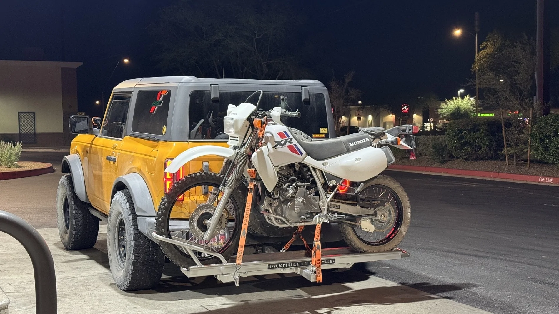

Ford Bronco Doubled rear cross frame to increase hitch tongue weight. OEM frame is 1/8” thin! Higgspeed Bronco Badlands with XR650
After hauling my 350lb Honda XR650 I ended up installing the Bronco Raptor Hitch Support Braces (easy since I had already changed my exhaust and got rid of the huge factory muffler)
I also added a manual fill Air Bag system to the rear axle, which I still need to test it loaded down like this.
Disclaimer (this photo is before I did any of this 😅)
As noted just above, it's more about the leverage than the load itself. The Raptor bracing only takes the static rating from 350 to 450 lb.
