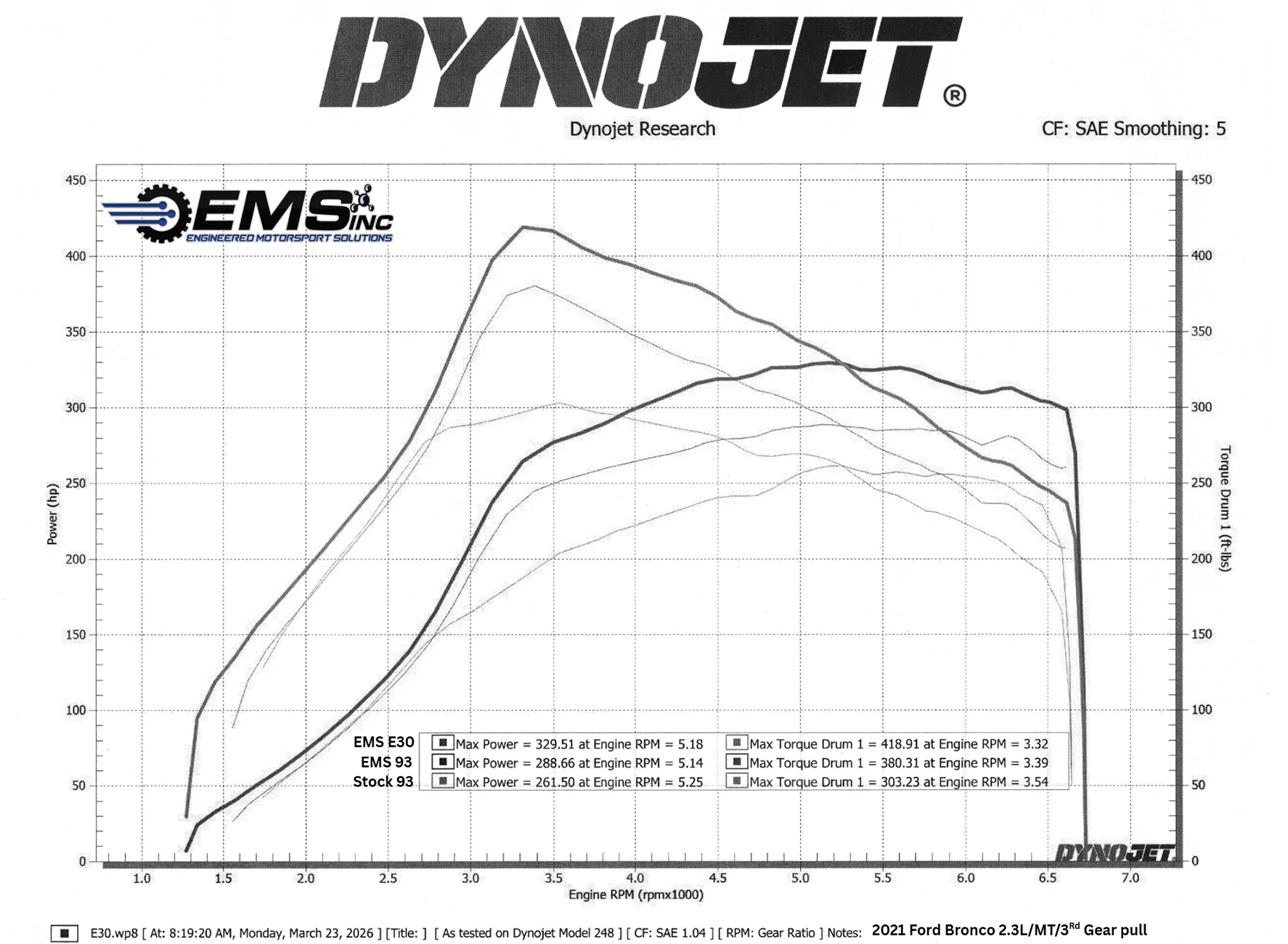

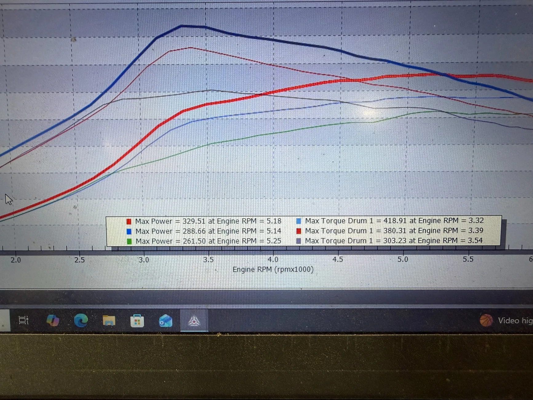

I had planned to make all my dyno pulls in 4th gear which is 1:1. Unfortunately the Bronco hit the speed limiter in 4th on the stock tune so we did all of the pulls in 3rd gear on the Dynojet.
Ford Bronco 2021 Bronco 2.3L Ecoboost Custom Tuning Dyno Results! EMSBroncoDYNO
Ford Bronco 2021 Bronco 2.3L Ecoboost Custom Tuning Dyno Results! IMG_2354
As you can see by the results, with the bolt-ons that I have installed the Bronco is running pretty good right out of the gate. Higher than some of the dyno results I’ve seen with the stock tune on a DynoJet. I will say it’s hard to find an apples to apples comparison as some folks use different dynos, gears and show STD vs. SAE.
After flashing to the 93 map, you can see the HP gains are modest (Close to 30 RWHP gained) but torque gains are massive. Nearly + 80 RWTQ! Definitely noticeable when rowing through the gears.
E30 is where the real fun begins, here we’re seeing 329 RWHP and 418 RWTQ - that’s a + 68 RWHP gain and +115 RWTQ All at the same curve, so a huge difference in daily driving & off-road. Making Bronco Raptor power with a 2 DR and a manual transmission = Fun :) Huge win for the 2.3L Bronco platform.
Torque wise, on E30 we’re pretty much at the safety levels we want to be with the stock long block. Around 420 RWTQ is a nice stopping point to maintain reliability. We still have plenty of room on the HP side, as you’ll typically want to stay around the 380-400 RWHP mark.

I had planned to make all my dyno pulls in 4th gear which is 1:1. Unfortunately the Bronco hit the speed limiter in 4th on the stock tune and Ryan still had the limiter in place for the custom maps, which he later adjusted. Due to time constraints we did all of the pulls in 3rd gear on the Dynojet.
After flashing to the 93 map, you can see the HP gains are not quite as substantial as I would’ve thought (Close to 30 RWHP gained) that said, the torque gains are massive. Nearly + 80 RWTQ! Definitely noticeable when rowing through the gears.
