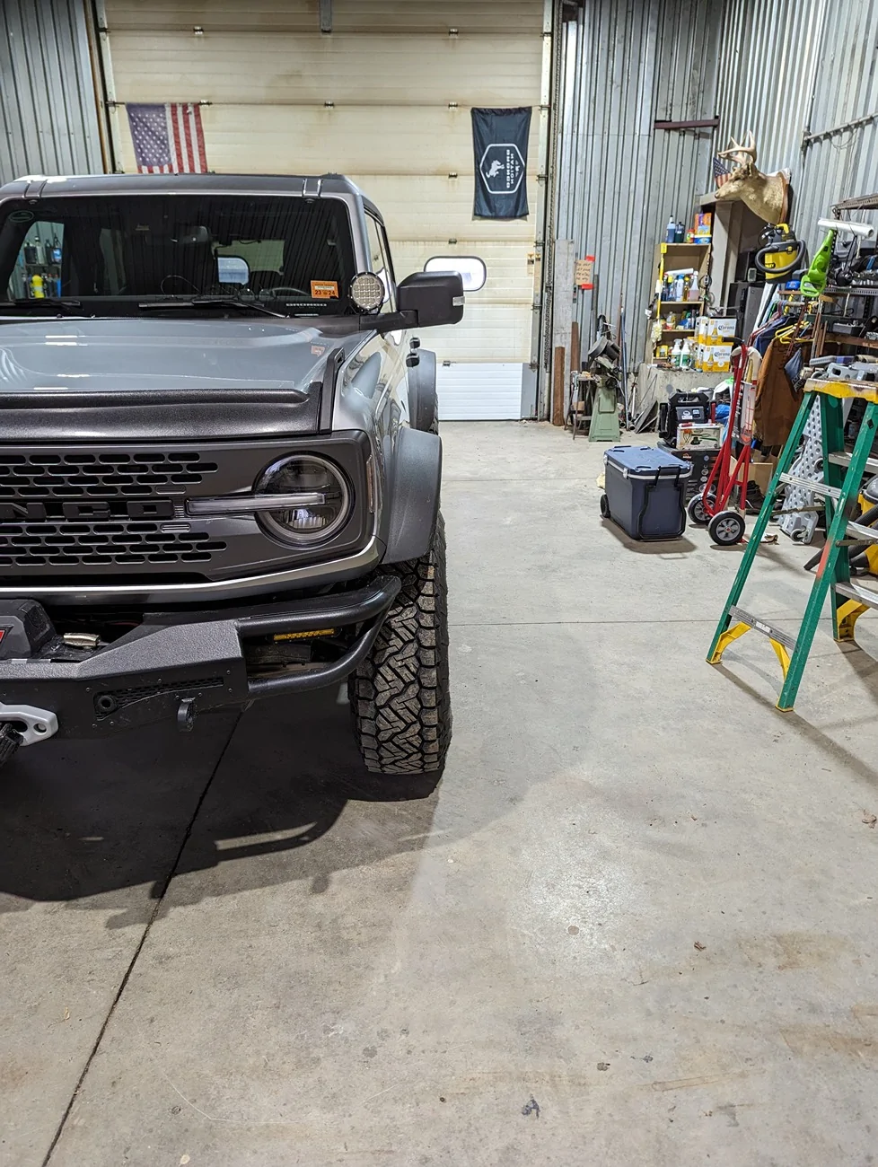

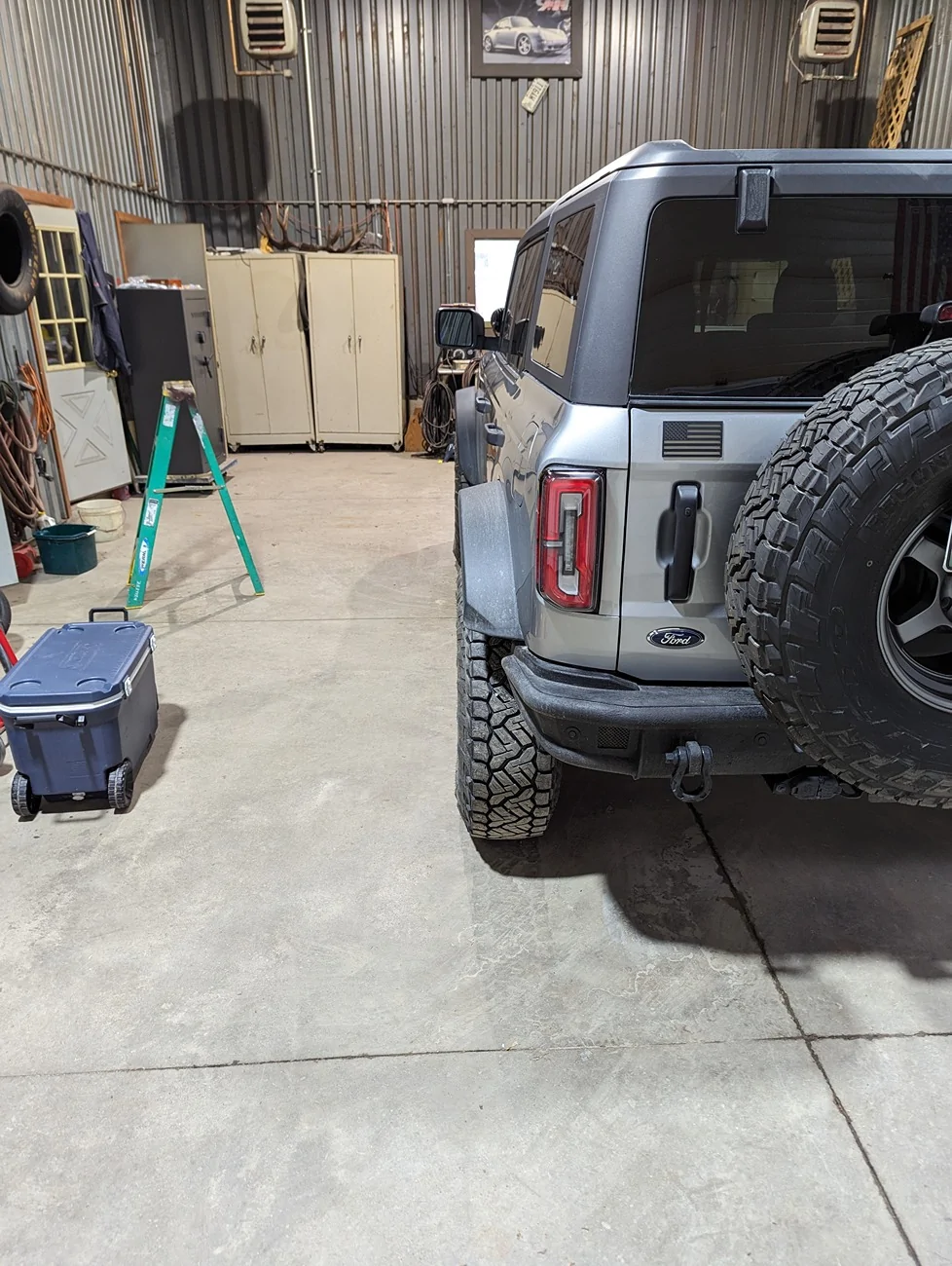

Not exact but similar...37 x 11.50s on +12 wheels and squatch fender flares. A 12.50 tire would poke another 1/2"
Ford Bronco +12 or +25 Offset Pics on Sasquatch PXL_20231219_161844582.MP
Ford Bronco +12 or +25 Offset Pics on Sasquatch PXL_20231219_161902813.MP
Thank you for the visual!
